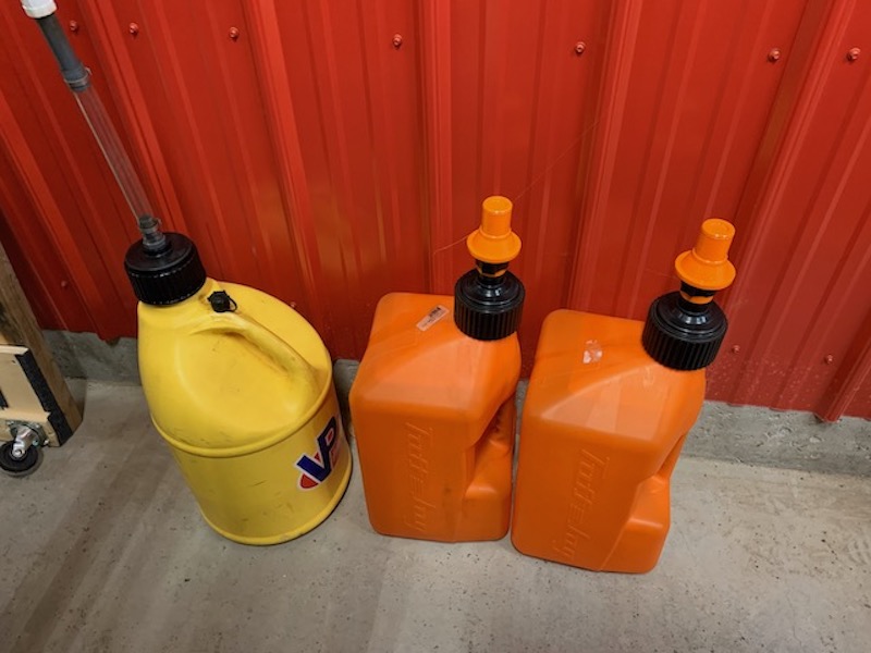

Some people on here mentioned having 500, 600 gallon tanks. A truck coming and filling that thing? How economical is that? I have a truck come fill my 1000 gallon propane tank. Would love to have a 500 gallon diesel tank filled the same way. As it stands, I have 8 VP Racing 5 gallon cans and it seems I'm always making trips to the station.

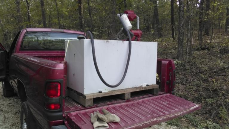

After seeing TexasBoy's setup, I did the same thing in July of 2017. Here is my tank in the back of my truck one of the times I took it to fill it. I keep a spreadsheet of the amount of fuel in it so I can keep the weight low enough that my L3901DT can pick it up and move it. The last time I got fuel it was around 510 pounds, this include the weight of the tank. There is about 40 gallons of fuel in it. I have had over 60 gallons in it and was able to move it with no problems.

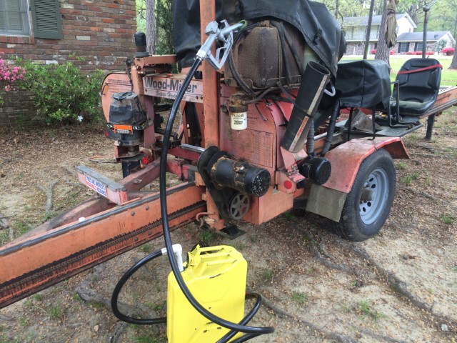

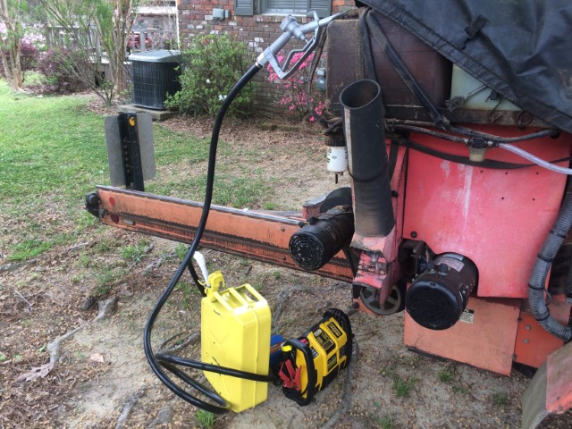

OK, I finally got an opportunity to use my HF fuel pump. As you can see, the sawmill's fuel jug is quite high. Yes, it can be filled in place but the spout is still well above waist high. Also the jug can be disconnected and brought down to ground level, but it still has to be lifted back to it's carrying rack. Filling it in place saves all of the lifting.

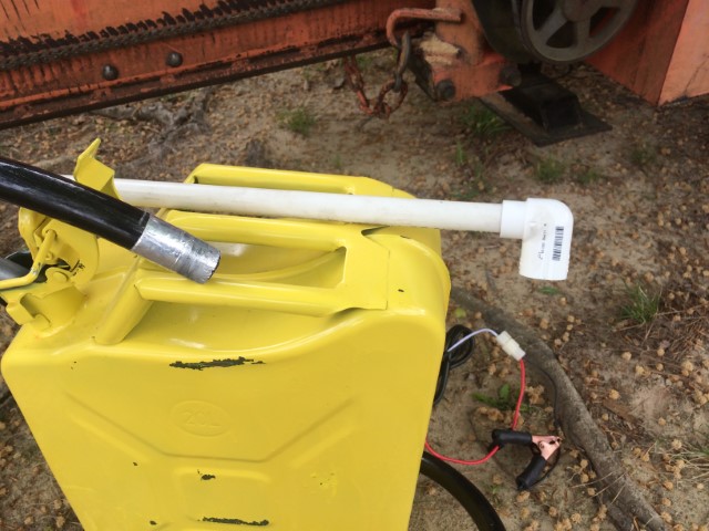

I made a detachable pickup tube with 1/2" PVC and a 3/4" elbow.
I have two different options for power. Here I used my "jump box" but I also have the option to use the sawmill battery which is very simple.
sheepfarmer, your question was regarding the ability to "feather" the flow. I am pleased to report that the nozzle is quite good and I could pinch it down to a trickle. Bottom line is that I am very pleased with this fuel refilling method.

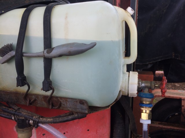

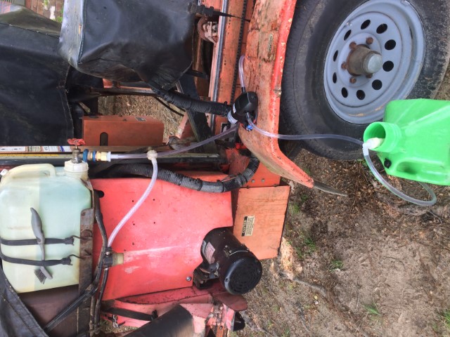

I followed through and expanded this fuel pump solution to refilling the lube jug on my sawmill. It too is 5 gallons and it's normal resting place on the sawmill is ~5' off of the ground.
My solution was to use a FloJet pump, some tubing, and a PVC pickup tube. It only takes a couple of minutes to pump the lube solution from ground level and fill the onboard jug. (I find no way to flip the last picture upright.)
