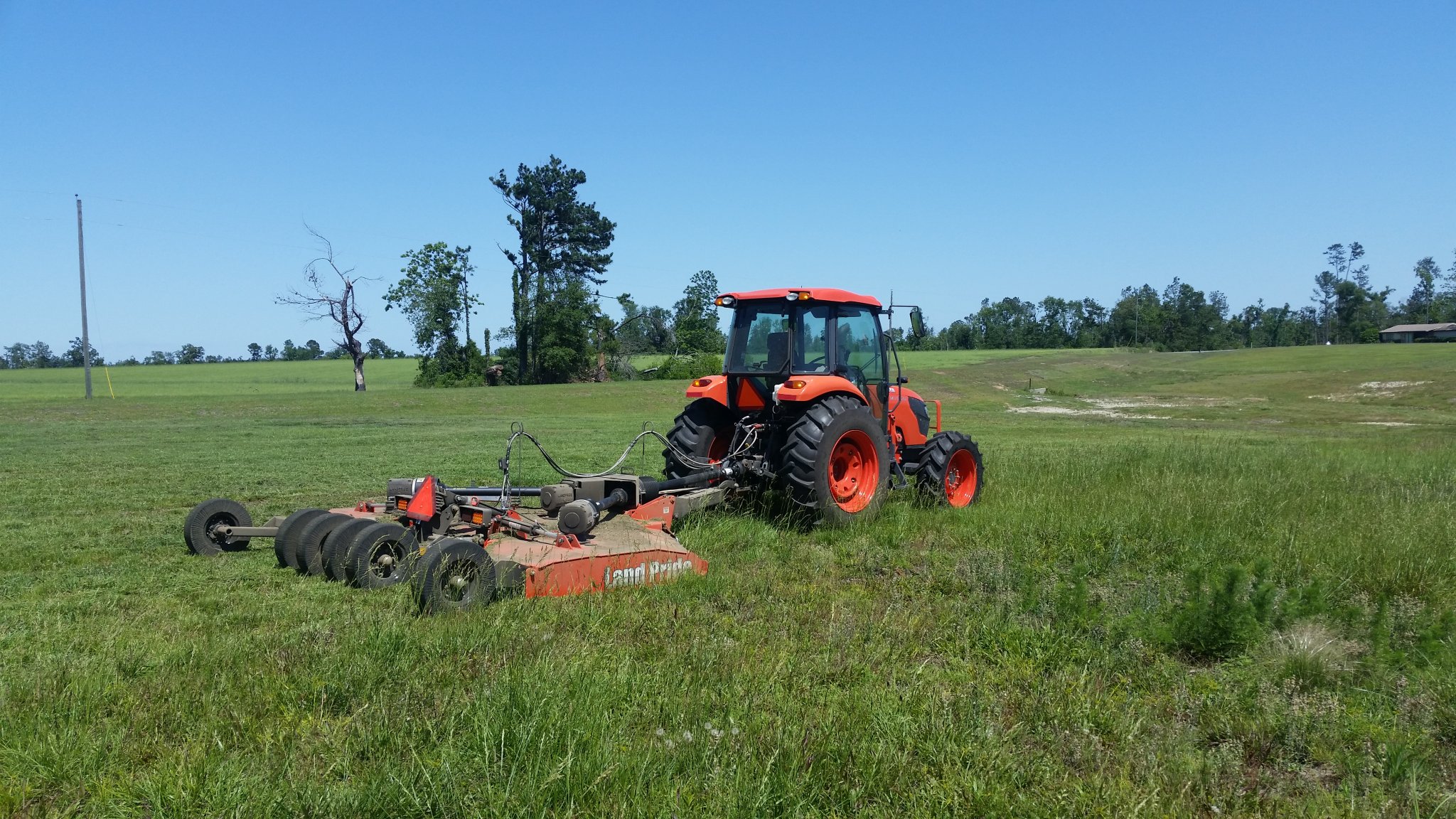

I have the LP 3712 with 6 tires and the ORC, Its a great cutter and I have been very pleased with it!
That's the model that I wanted. I know of no other BW that is offered with a built in ORC.
I could have used a 3712 with either my M9960 or my L6060 (only with swivel hitch), but simply could not justify the price.

Agreed it's pricey, but with the 6 tires, ORC and High Performance Hitch it has been a great cutter. I have heard of someone who Flipped the High Performance Hitch in order to make it work with there L6060.
