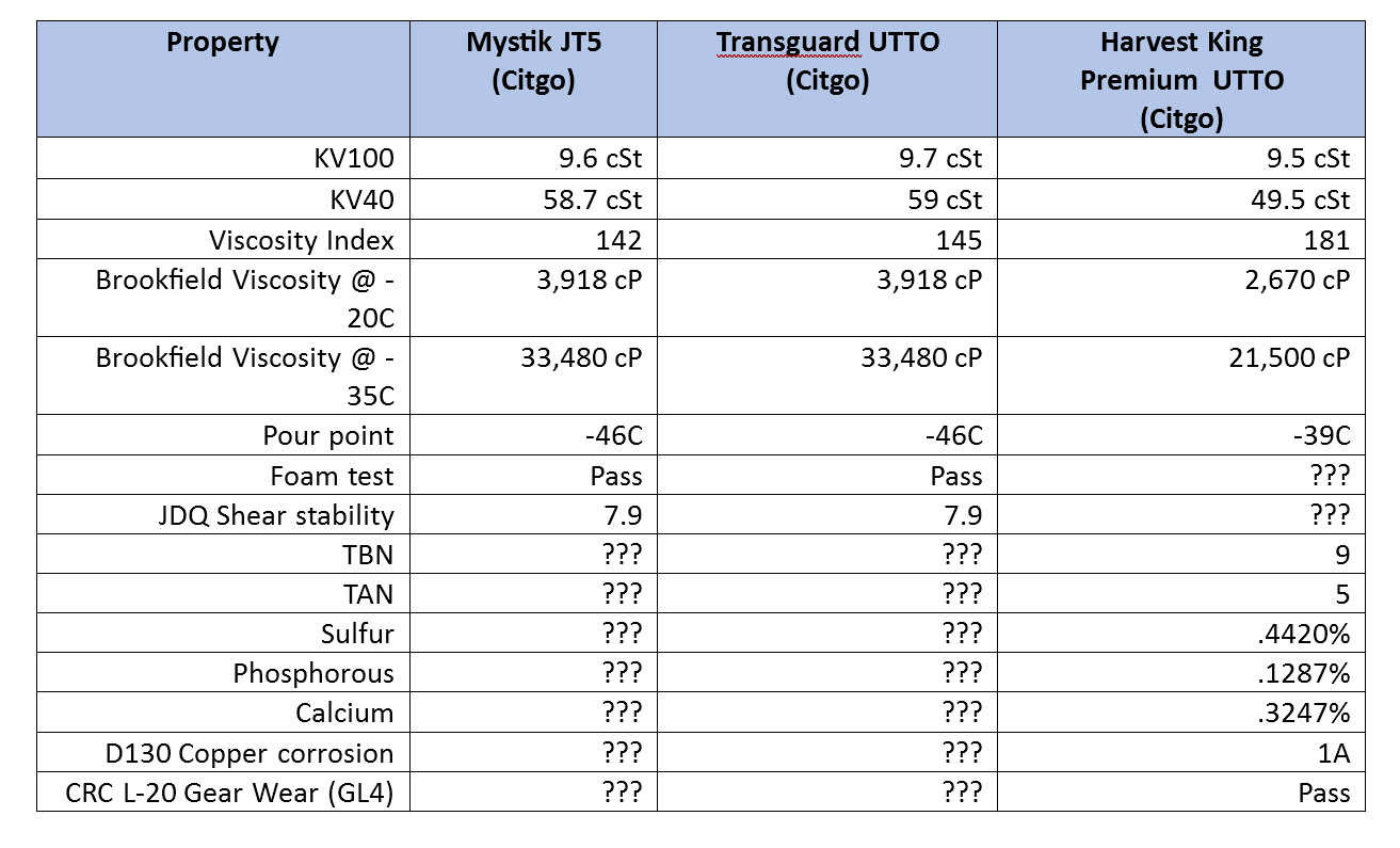

Lubrizol did an in-house analysis of half a dozen house brand oils and that was one of them. Harvest King came out with the highest marks in most of the tests. It is an excellent well formulated UTTO but not in a class with SUDT.
For perspective Lubrizol does not make oil - they develop and make the additive packages that the blenders use to formulate their products. The purpose of the test was to try snd identify which generic oils used the best additive technologies and in particular how the "yellow bucket" oils matched up. The results were supposed to be company confidential but they escaped to the wild.....

Viscometric and Chemical Analysis per Lubrizol:
An additive rich formulation with excellent cold weather pumpability, water tolerance, and gear wear performance.
KV40: 45 cSt
KV100: 9.6 cSt
VI: 181
Pour Point -39C
Brookfield Viscosity @ -35C : 21,500 cP
Copper corrosion: 1A
TBN: 9
TAN: 5
Phosphorous: 1280 PPM
Sulfur: 4045 PPM

When people opine about a specific lubricant I like to provide as much hard data as I can.
Here is what I KNOW about a couple generic UTTOs sold at your local box stores. The data are revealing. I have even more data for the OP's Harvest King product which I omitted for brevity's sake. Its even more revealing and all good.
