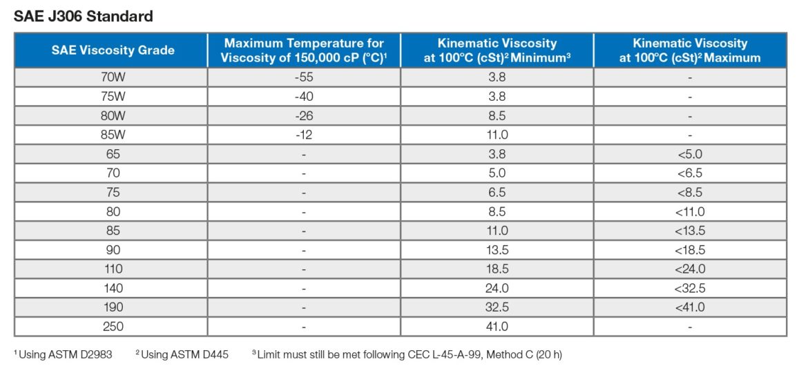

Let me makebit plain. I think SAE 140 gear oil will buy you nothing and will actually open you up to potentially damaging behaviors.

Like I said it will buy you nothing and you have kind of identified the main concern - channeling in cold weather. The oil gets so viscous it wont flow fast enough to fill in behind the gear teeth as they move in and out of mesh and you actually loose lubrication. Not at all good - in fact very bad - for gear teeth. In over the road applucations the oil gets warmed pretty quickly by the high speed gears whipping it up so channeling is held to a minimum. In a low speed BX the oil may never warm up and those gears could run a very long tine with little to no oil film.
I am not an "oilologist" or even a rheologist but I do know and understand the labeling and rheological requirements for the SAE viscosity grades.
I believe that whole area is submerged, no? There would be continuous oil contact unless you go fast enough to pull a vortex from the top. My concern would be oil getting to/into any bushing type bearings, if there is any. I would have to check the diagrams to see what parts are in there, but, remember, older cars and modern trailers DO use grease, so, just depends on whats in there.

I explained to you what happens rheologically when gear oil gets cold and becomes too viscous to flow properly. Submerged or not it forms voids between the rotating gear teeth leaving them unlubricated. Thats not an opinion its physics. Its a behavior called channeling that is well documented by lots of very reliable and well controlled physical testing. And its a major reason why multi-grade gear oils with improved cold temperature flow were developed. Using a higher viscosity monograde oil makes that channeling problem worse not better.
I am also not a triboligist but I do know that the gear teeth in a differential operate in what triboligists classify as the boundary mode lubrication regime. In that mode the operating pressures are so high the oil film is displaced and the teeth are forced into direct metal to metal sliding contact. That causes welding, galling, and scuffing wear.
EP wear protection additives are used to minimize the effects of boundary mode operation. EP additives are chemically activated by contact with the localized high surface temperatures created at the sliding points of cobtact and react with the base metal of the teeth to form a microscopically thin sacrificial surface layer of softer metal oxides. This layer is torn away as the gears operate greatly reducing (but not totally eliminating) the loss of base metal. If the oil gets too viscous to flow and reach the points of contact none of that can happen
i have no idea what the problem is with the front axle on your tractor but I am quite confident its not because the OEM specified lubricant was too "thin" for the application.
