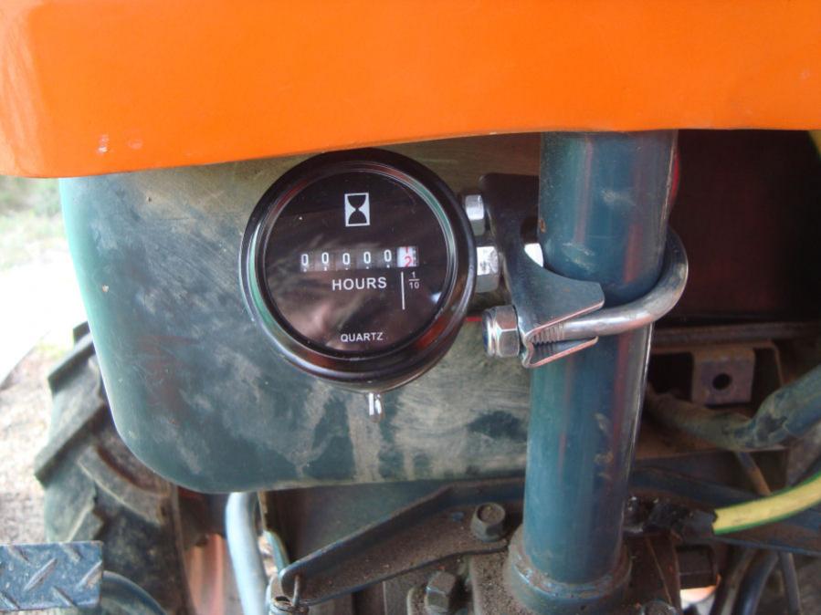

You do have another option, and that is adding an electric hour meter such as this one in the link.
http://www.galco.com/buy/Redington-...22-0004-RDTN&gclid=CInWsYu3vsMCFUY8gQodehkA0A
The link shows a 115/230volt AC hour meter. How does that work? I think the link was supposed to show a 12 volt DC hour meter.
volp
Kubota B6001, MF35 with backhoe, Ford 3000, JD LX186 Lawn tractor
10,578
7,734
The old google-fu got me :eek:. Did a search for 12 volt hour meter and it got me for the 115 vlt model :rolleyes:
Ya, at 113$ for the proper one, might as well price out the original part :eek:
