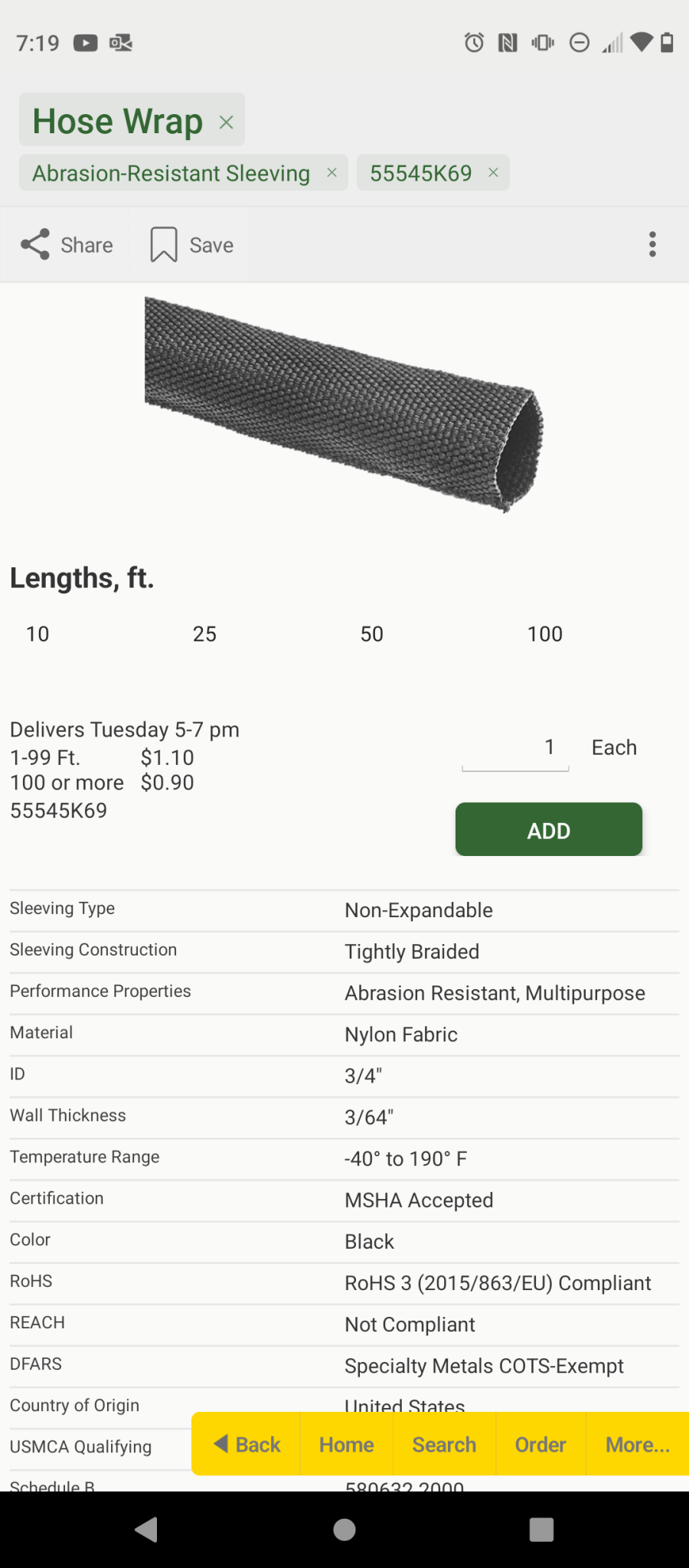

I bought the following for my hoses; I put both of them in one large sleeve (velco opening down the entire length). I did this over 2 years ago. The hoses are fine, and it has protected the paint on the tractor. I purchased a 3 foot length, and then I cut it as needed.
My local hydraulic hose supplier did not have anything like it.

Nylon hose sleeve on Amazon. Good price and selection of widths and you will get it fast. Make sure its wide enough to get the end fittings through.

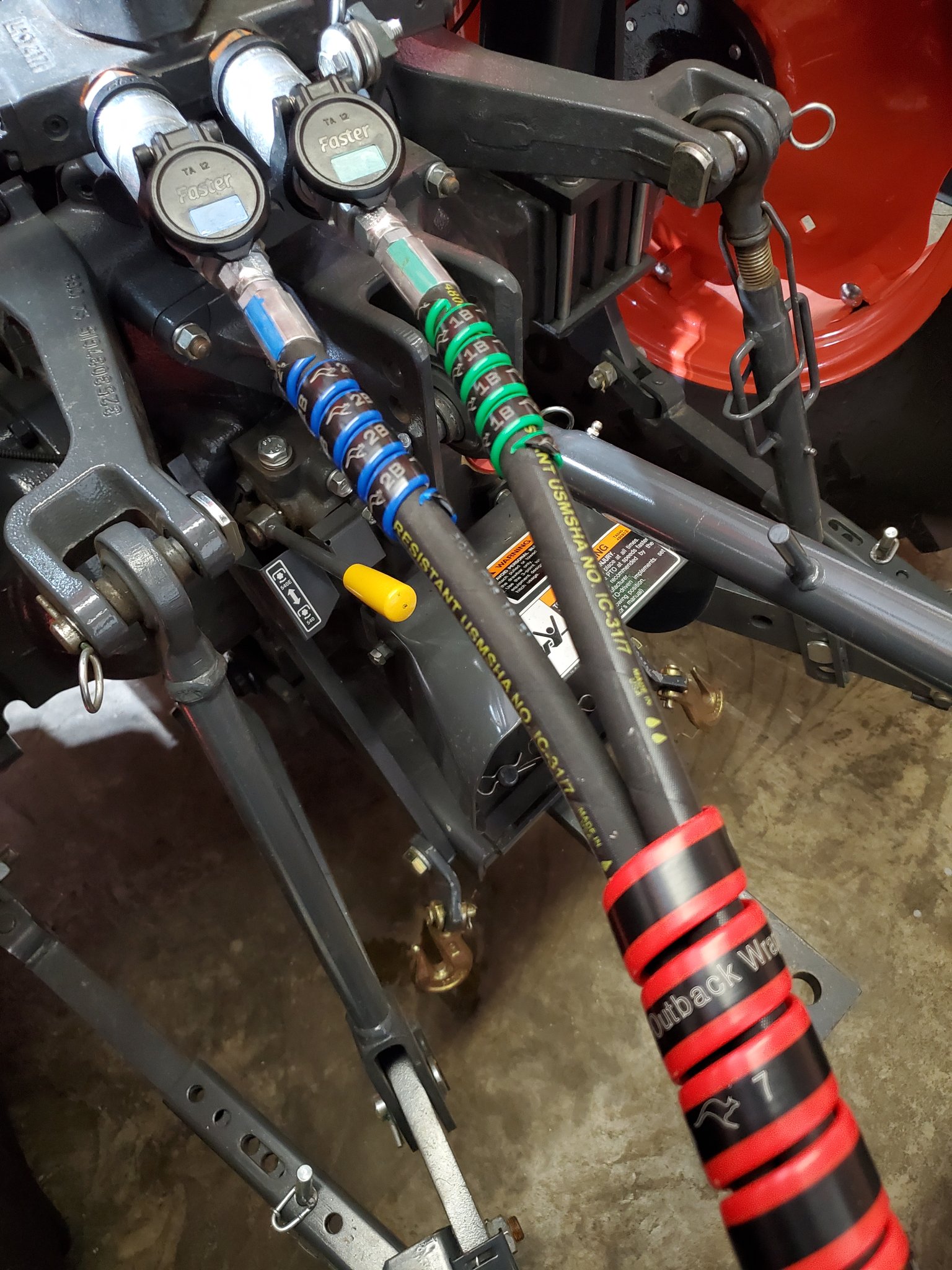

Outback wrap. I think you can get a discount with a code from Good Works Tractors.
