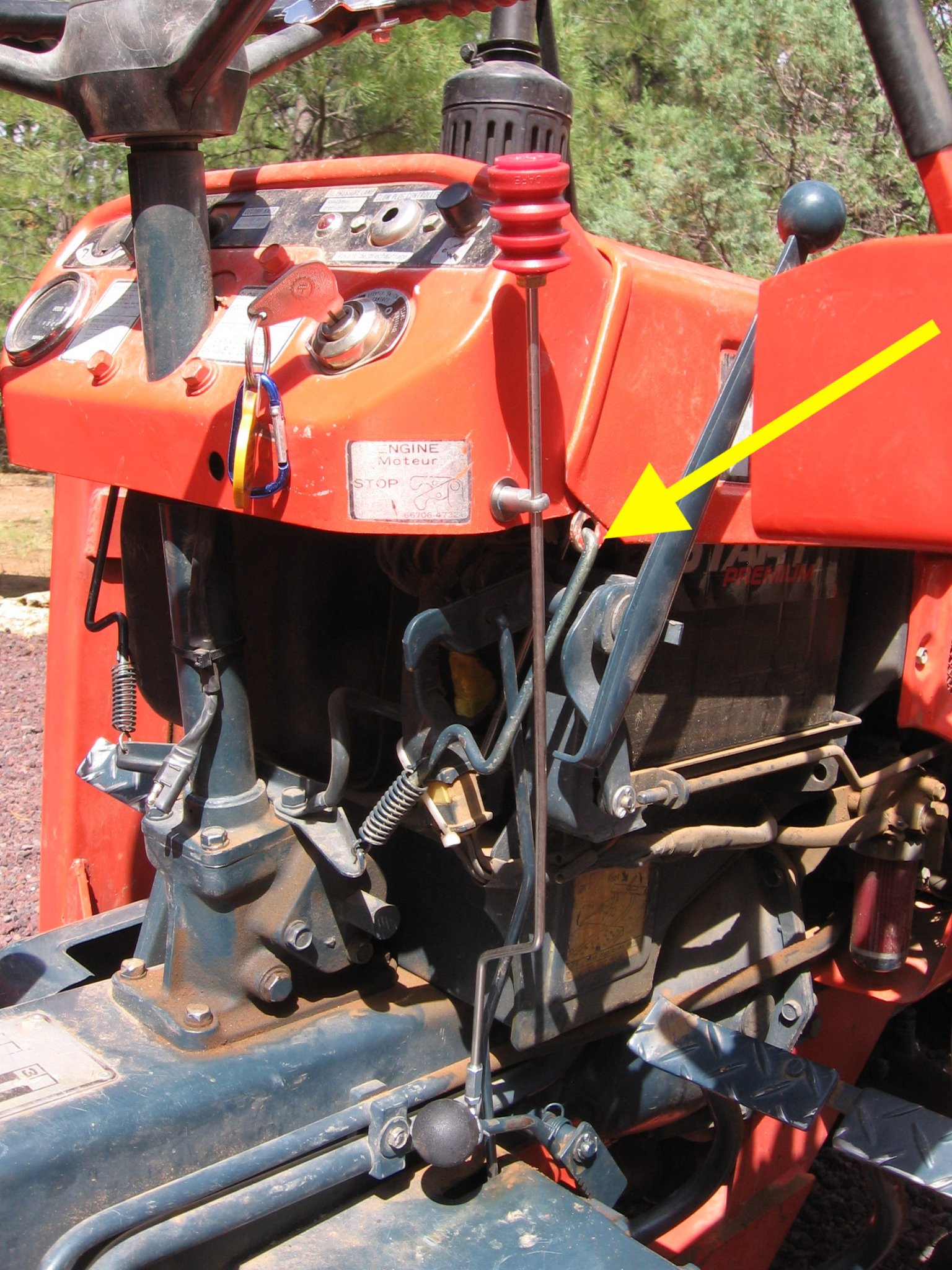

I slammed my hood down too hard and dislodged the latching mechanism. I had to remove the headlights to be able to access and open the hood so that I could reattach the latch. I close it gently now.

Resolution: Nut on mascot had lossened off and would not allow it to engage. Had to take off plastic covering on left side of hood. From there I cold see the latch. Use a piece of stiff wire to manually open the latch.

Congrats on getting it open and thanks for posting your solution.
