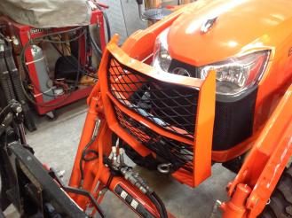

I know this is likely not what you mean as the covers I made are to keep branches away from the plastic kubota grill when I'm using the grapple. I don't think they would be of much use for snow but here in Florida we don't get much of that :)
