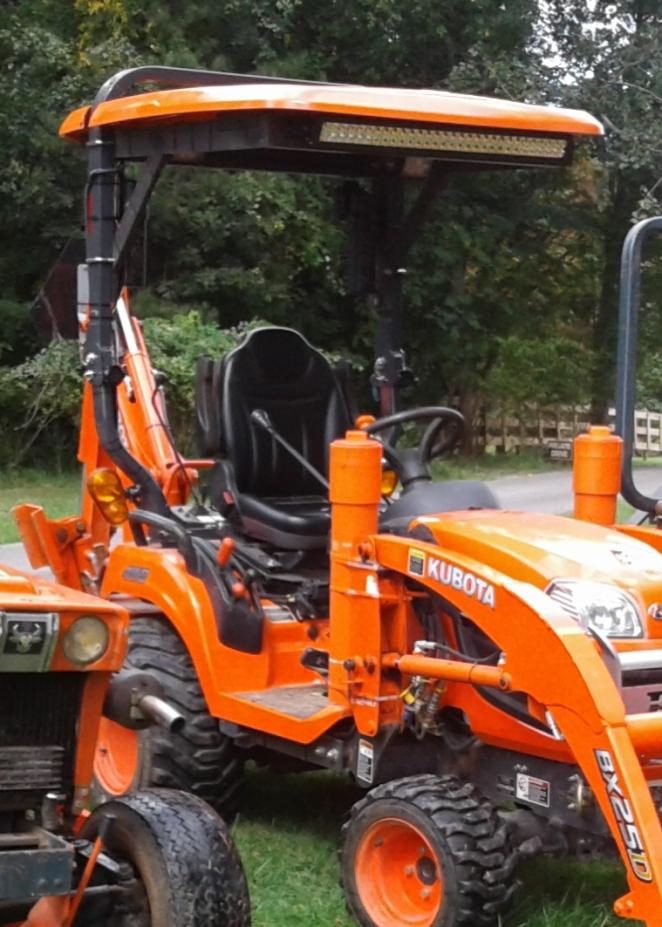

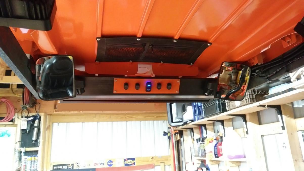

I found a roof for a Kubota rtv and cut a foot out of the middle and made some supports for it. Project cost $80 so far. I will paint it after I mount the LED lights front and back.

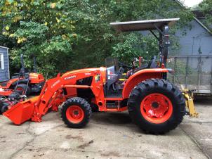

I built this canopy for mine, but also serves as brush deflector and roof rack.
Having the shade makes all the difference in the world! I have used the roof rack as mobile scaffolding on jobs and to carry box blind stands back into the woods.

st8yd - I like that! Would you mind taking close-up pictures of the mounting location at the loader and the ROPS? Did you start with an auto rooftop carrier?
