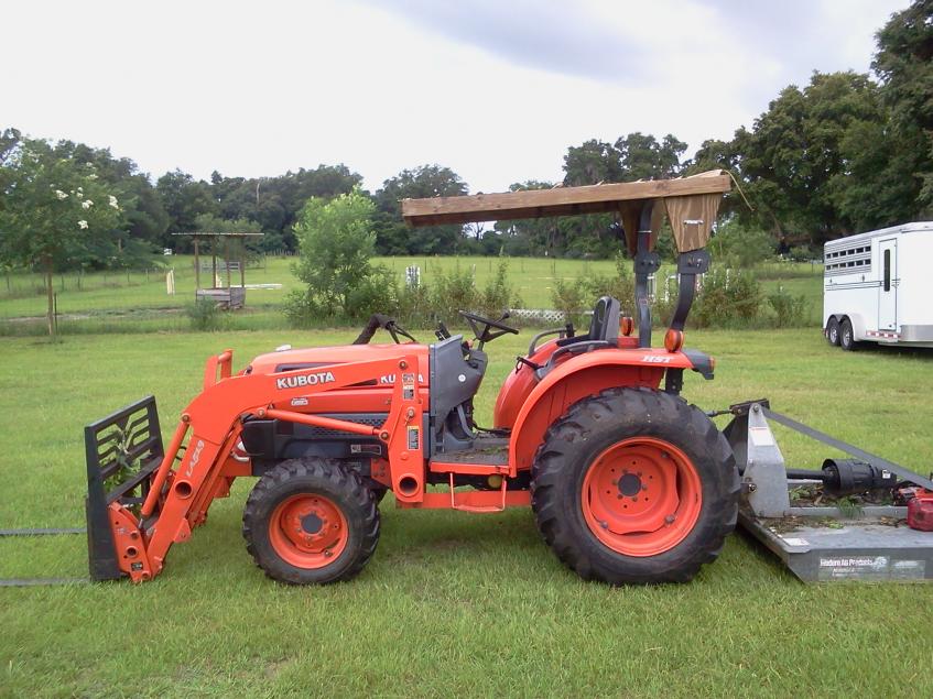

st8yd - I like that! Would you mind taking close-up pictures of the mounting location at the loader and the ROPS? Did you start with an auto rooftop carrier?
I fabricated it all from scratch.
Where it attaches to the rops put a piece of flat metal across the to vertical pipes and put square ubolts on it.
At the loader frame I just bolted it at the top.
The two forward pipes are bolted at the top in case any major work needs to be done they can be unbolted easily, but they are far enough apart to allow the hood to easily raise.

I have a L2250 I need a canopy for - but I wanted a large - well covering canopy - something like what Bambam31 did - I was wondering though - how it would travel on a trailer - I transport my tractor a lot - definitely don't need it "sailing away" - ripping off the mount and God forbid - causing trouble on the highways! But I was considering something very similar to this myself.

This was my first roof I made when I realized how beneficial the shade was. It went to hunt camp many times 2hrs ea way. It did wobble a bit but was still solid when I took it apart. It was wood screwed together with deck screws and metal roofing screwed down.
So Bambam31's will definitely go down the road with out movement.
