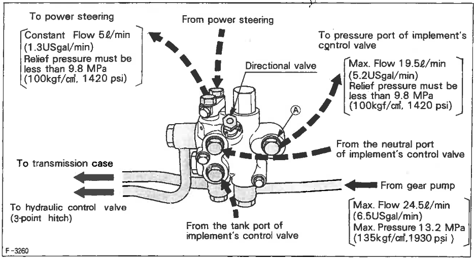

I had a bigger tractor years back that had a proportioning valve that looked similar. Here is the 8200 valve. Try turning the directional valve labeled here to the opposite position. I think that is what enables the flow divider function in the valve.
ezriderf6c
b8200d 4x4 with bf300a and backhoe and KX-161-3st w/ steel tracks
I had a bigger tractor years back that had a proportioning valve that looked similar. Here is the 8200 valve. Try turning the directional valve labeled here to the opposite position. I think that is what enables the flow divider function in the valve. View attachment 69756
THAT IS *EXACTLY* THE VALVE I HAVE and nobody has been able to explain what the directional valve does properly... I didn't realize I was adjusting flow between the FEL and the power steering. I guess you can't have both?
