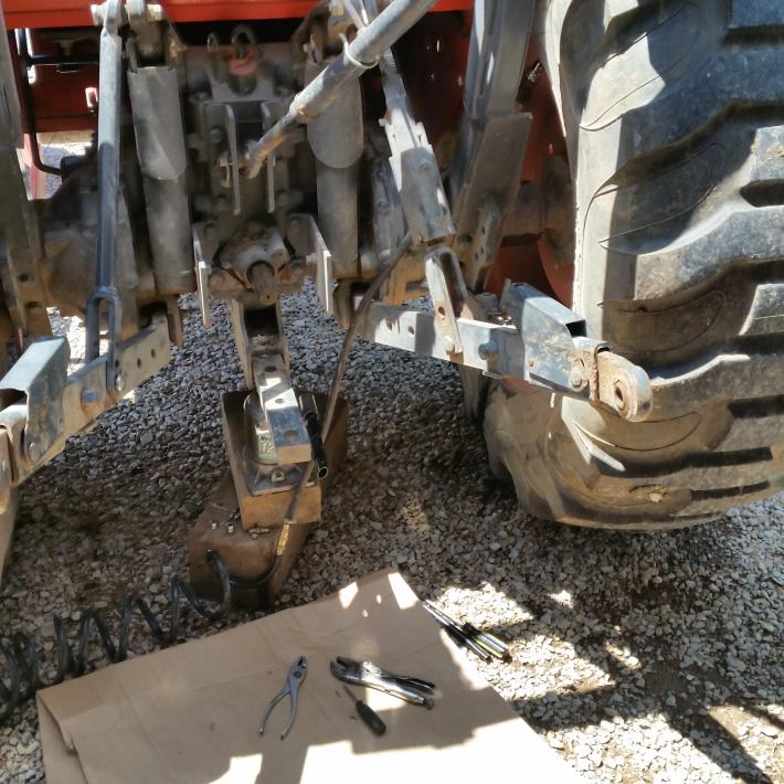

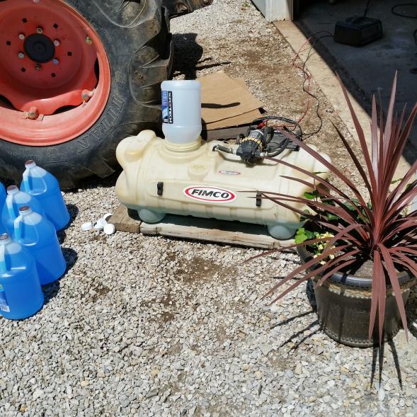

I use a 15 gal sprayer. Removed the core and put the hose on it with a small clamp. I bought the special adapter from NAPA but never used it. (It's still setting in my tool box. I should have bought a pizza.)
Use a jack to get the rear tires about 1/2" off the ground. Have valve stems at 12:00 position.
I put 42 gallons in each tire and it took about 15-20 minutes each after set up. I simply removed the clamp about two times on each tire to let the air out.
