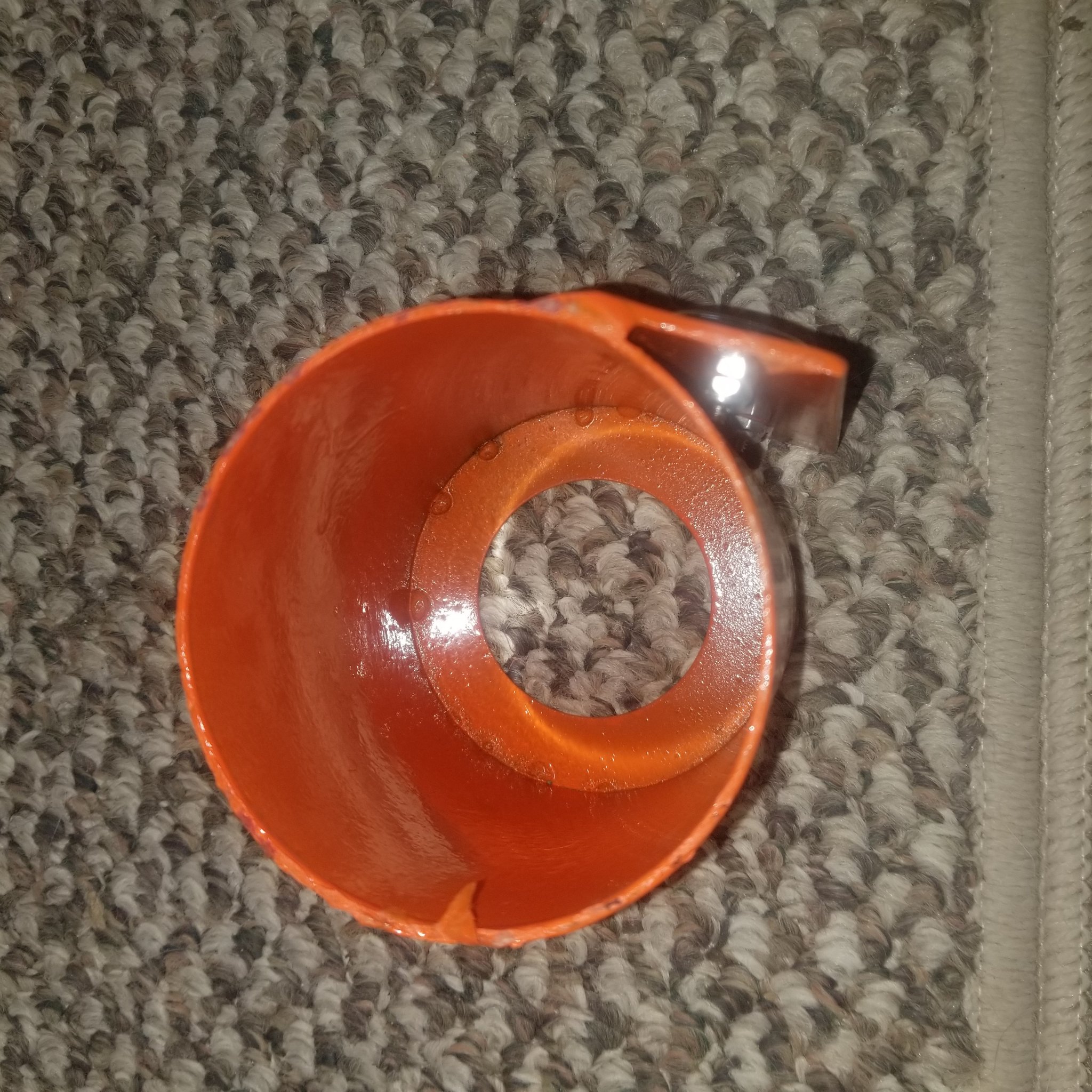

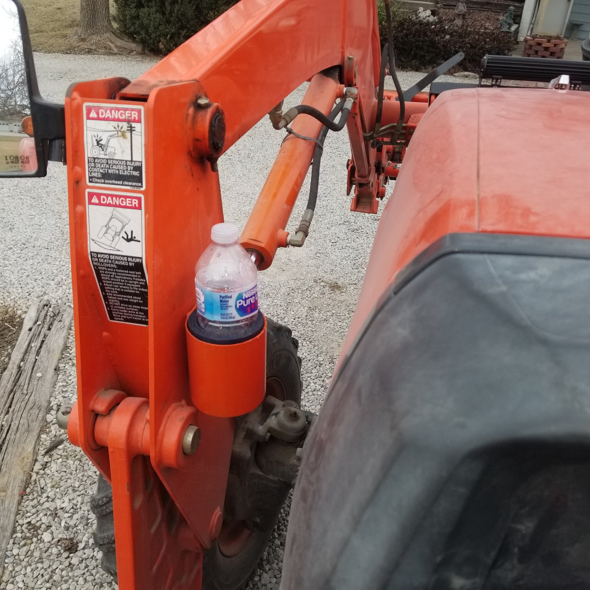

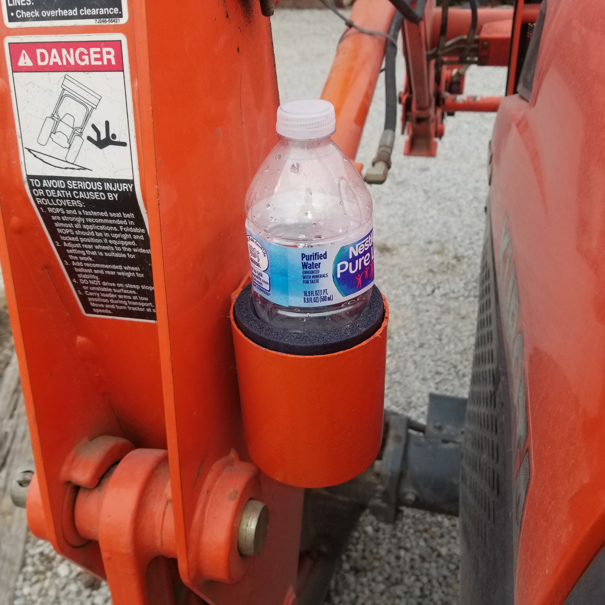

My L4240 has a cup holder "if that's what you want to call it" behind the seat on the left side, and it's about 2 1/2" deep. Can't reach back very easily with either hand to reach it. Here's my solution.
Had a piece of thin wall tubing like used for old time gas lights folks had in their front yard and cut off about 3 1/2". Had a assortment of flat washers, found one that just fit inside the tubing and welded it there. Had a piece of 1" x 1/8 bar, cut if off the same length as the tubing, drilled two 1/8" holes near the top and bottom, and welded it vertical on one side of the tubing. Used tapered head SS bolts to attach two neodymium magnets rated at 27# each.
A can/or bottled drink fits in a koozie and the whole thing rides where I can see and reach it. I put it on the loader tower and while grappling for two hours it didn't move.

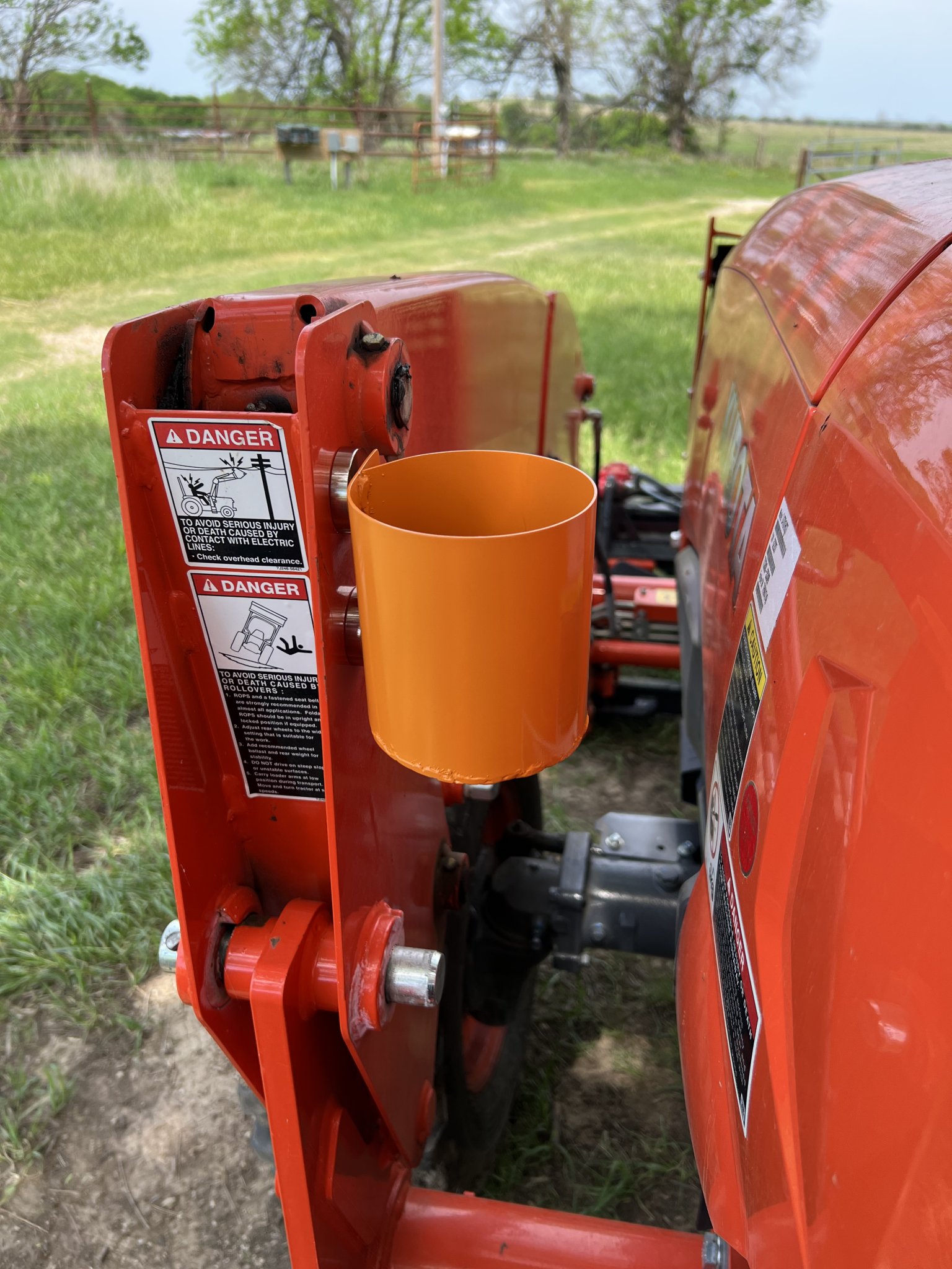

I like your idea so much, I built 1. I used 16 gauge sheet metal & rolled it. I left a 2” tail where I attached the magnets. Made a bottom a little larger then a quart bottle & welded everything up. Paint color is off, but plan to powder coat it the proper color when I do another project. I think it is different enough to get me by the original patent🤫.
