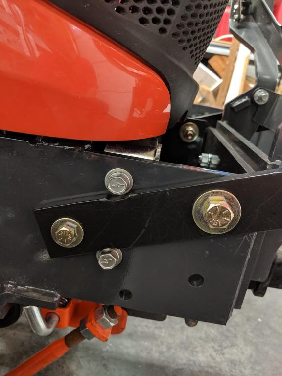

I use my 2380 mostly for mowing my property (2 acres or so of grass, 1 acre of woods). The side and rear is pretty steep so I started looking into adding weights to the front. The Kubota weight bracket the dealer had made me lose the brush guard. Since I prepare deer plots with this BX the brush guard is a must. Searching on the Internet did not produce any results that met my requirements so I broke out the MIG machine and made my own bracket.
I used factory holes in the frame to mount it so I didn't have to drill it and the brush guard opens without interference as well. I am going to add "ears" to it so I can put a rod through the weights and secure them with a padlock for those few times when it is on a trailer and I stop for fuel, food, etc.

Welcome, post pic's of the weight bar if you have them.
If you did post a pic...it's not showing up.

That's weird - I inserted 4 pictures in the post body and they show up for me??
EDIT - I uploaded them again and attached them to the post.

I see you have a 2" hitch adapter on the front. Where did you source that - or did you fabricate it yourself?
I made it myself. I used the factory holes for mounting - I don't want to drill the frame.
