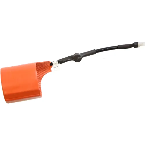

Hey Orange People, got a question on this accessory. Well, more like I want opinions. :LOL:
We have a 24k Generac air cooled/ LP fuel generator. We live in the Mid Atlantic, so it isn't often hatefully cold. There are times where is does drop into the single digits. A week or two ago, it was 5°f overnight and 28°f during the day. I happened to be outside when the generator fired up for exercise. It definitely did not want to fire up like it does when it is warmer out. Generac and other Chinese suppliers have an oil filter heating sleeve that is supposed to help cold starts. I believe it is 40 watts. It has a little Klixon switch to turn it on/ off. They run $122 for most sources.
Do any of you use this, and does it really help with cold starts at just 40 watts? I know heat will move from the filter and to the engine through conduction and convection. But is it really worth it? Better options? Better options without setting things on fire? LOL!

We have a 20KW Kohler. I have the installing company do the service. He used synthetic oil. It has the heater on it. It has a 20 min warm up every week and last week it acted no different than any other time and it was minus something at 8AM. I think there is also a heat pad for the battery (we don't have it).

These are the two items we stock for cold weather assist:
1ea ³7102 OIL HEATER KIT FOR HONEYWELL ³
³GENERAC 9-22KW AIR COOLED ³
1ea ³7101 BATTERY HEATER KIT FOR ³
³HONEYWELL GENERAC 9-22KW AIR COOLED³
Feedback from our customers, especially in the Berkshires, indicates that they do make starting easier in cold temperatures

Gotta wonder how useful an OIL FILTER heater would be. It'd only heat about a half pint of the three quarts of oil in the engine. How much of a benefit would that be?
BTW, my 11-year-old Generac has never failed to start - even at minus 12°. It is a natural gas model, though. Would the very cold propane be playing a part in the start procedure?

I have the giant Generac 'portable' gasoline model. Yup, cold weather cranking is a tad slower but not enough to be concerned. I did notice water condensation on the long intake runners as the vaporized fuel kept them very cool if not cold even on a 90 degree day. So... I always have the inlet air preheat enabled. Not sure if the auto gensets have this but if they do, it is a goo idea to enable it then in summer, feel one of the runners and see if it is hot or even warm. Mine is always cold, just less wet with it preheated.
More on topic, I have doubts that a oil filter heater is going to do much. A heating pad on the bottom of the engine is more likely to have an effect.
BTW, after a few seconds of cranking, the chemical reaction in the battery to release electricity tends to warm them up just fine. What you do not want to happen is have the battery acid freeze.
I don't think there is a air preheat on the LP/NG model. The fuel doesn't change state and absorb heat like a gasoline model. I once added heated motorcycle grip pads to the intake manifold on a project bike. It had a EMPI carb from a VW. Frosting was significant without it.
I'm in doubt as well on a 40 watt heater on the filter. The enclosure is insulated, so the heat should stay inside for the most part. Sorta like the old days keeping a 100 watt drop light in the boat bilge. There are 100 watt pad heaters I've considered. At 3.5" in diameter, there might be a place to stick it.
