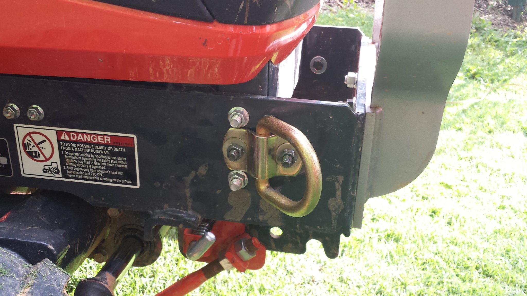

On a BX not a M series but same thought.......
Loops were less than 10 bucks each.
One hole was there already - I drilled the other - grade 8 bolts
a 5/16 chain hook will go through and attach to the binding chain.
Straps also work well too ! I have used these hooks several times on road trips.
Straps also work well too ! I have used these hooks several times on road trips. View attachment 63557
That’s exactly what I am trying to accomplish! I was just trying to avoid drilling a hole and use the hoist ring instead.

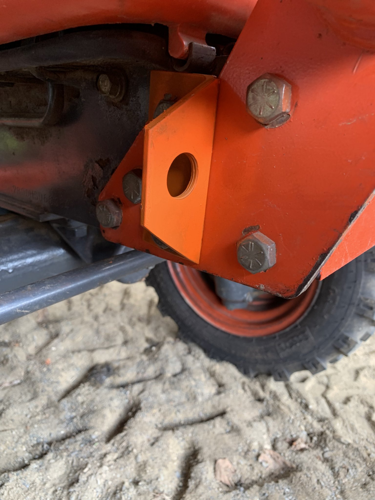

Use a heavy gauge angle iron and you can space your holes to match factory bolt holes. Sturdy and easy. You could always weld gussets on to it from additional strength.
