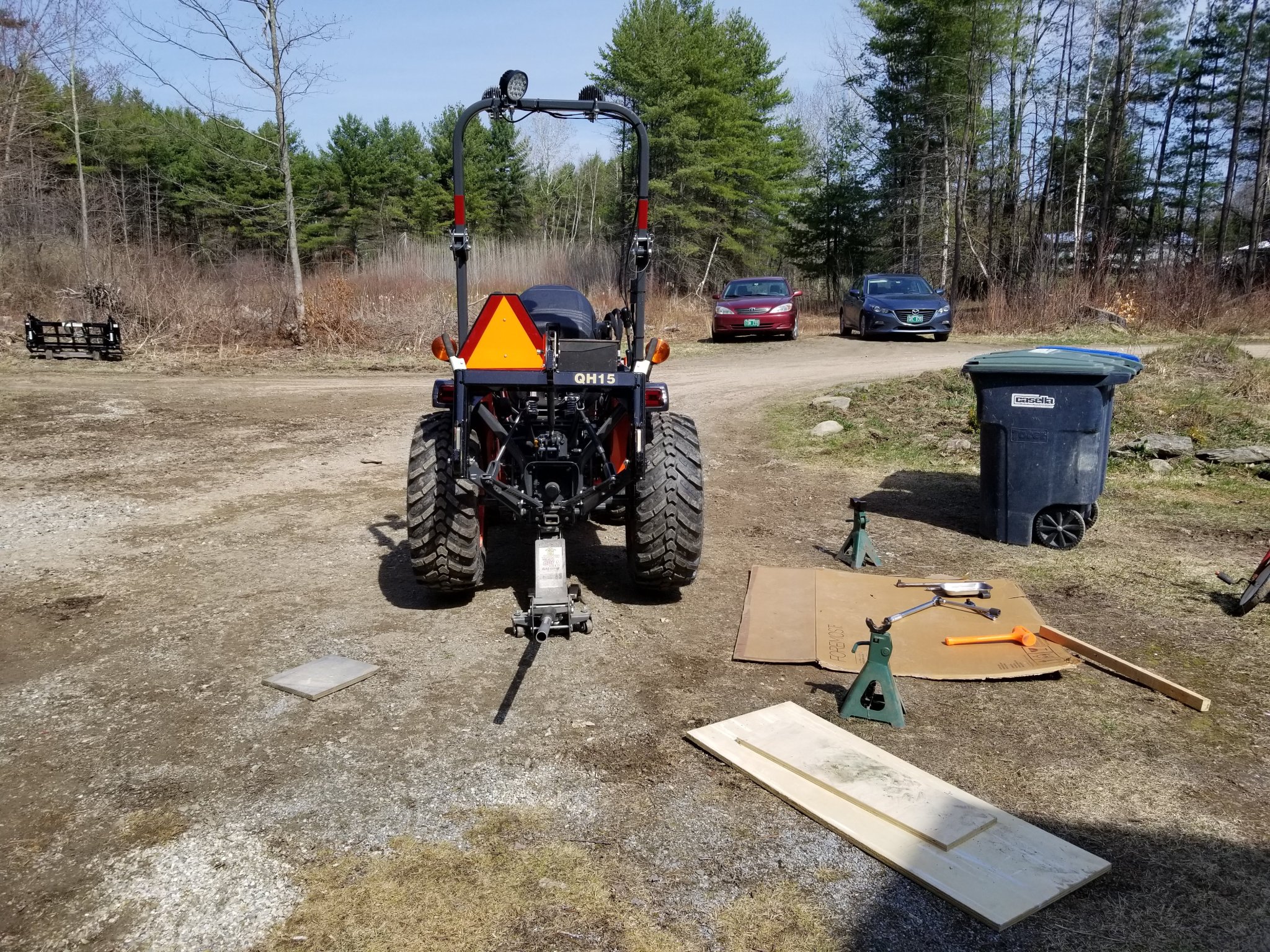

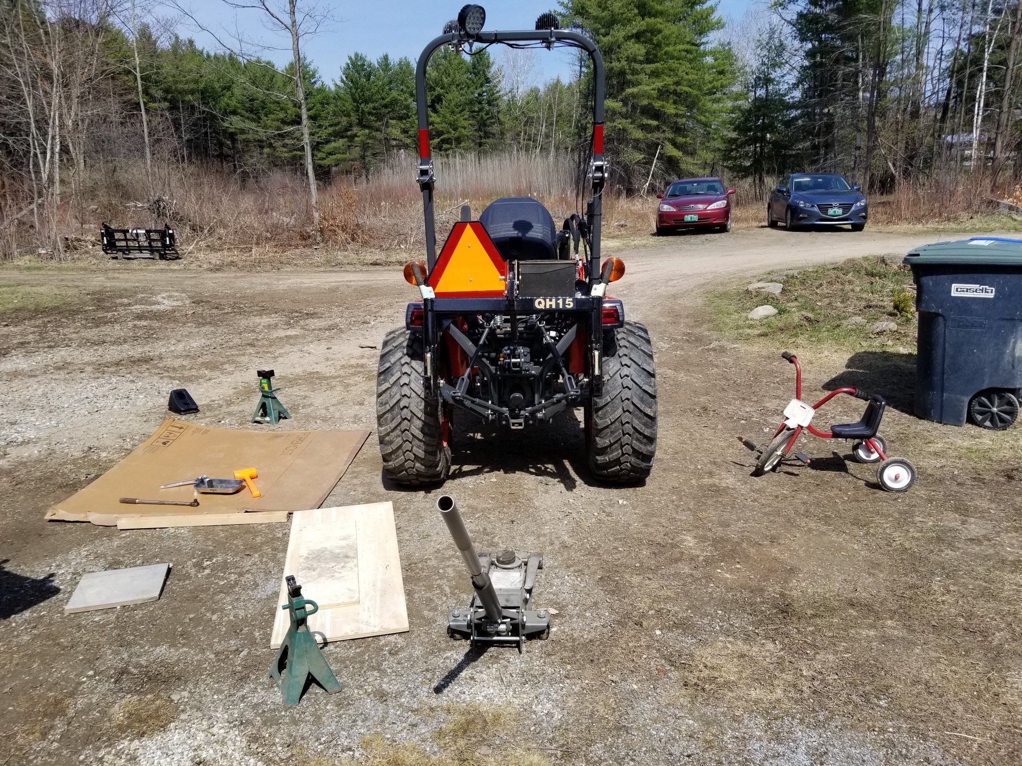

What spacers did you get? Did you put them on the front and back, or just the back? Do you have filled tires as well?
I got 2" Steel Bora wheel spacers; rear only (I've heard nothing but "don't do it" for the fronts). Tires are R14 filled with Rimguard. 2" was kind of the sweet spot of being a nice step up without the tires exceeding my ~60" bucket/angled back blade width (when snow plowing).
I have a 100yard drive way with a slight up hill incline, and 60ish acres of woods with lots of hills. Overall the tractor handles it fine; I might just get chains though for the winter so I can extend how long I'm able to get into the woods with the steep grades. Like others have said, when on the tractor YOU are the highest point, so molehills can feel like tipping hazards! More than once I've felt significant "pucker factor" only to hop off and see the tractor was only on a slight grade. Am I a wimp? Sure, but my jobs are never more important than my safety and I just take some time to make the area safe (level the trail better etc.) and then get back to work.
That bit about "voiding the warranty" doesn't sound right at all, Kubota sells spacer kits for these as well. Dealers hate warranty work, so I wouldn't be surprised if he was just BS'ing it.
Pictures of the wheel spacer installs for you. First one is 2" spacers on both sides, the second is the spacer just on the right:
