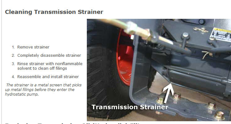

http://www.messicks.com/Articles/KubotaBX-Service.aspx

Triple R:
Nice link to Messicks.
However, this one part, needs some work. Suppose the newbie opens the plug at the strainer and is not prepared for a gush of oil.
Skeets: Yup, sort of nasty, but these arn't toys. Kid gloves for some other stuff, such as brain surgery.

Triple R:
I'm guessing it was intended as just a quick guide to go along with the manual. It would seem only prudent to expect a gush of oil when opening plugs like that. The same would go for clamping the fuel line when changing filters.
I would hope anyone working on their tractor would have a basic undrtanding of these things and if not, lesson learned.
