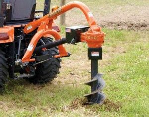

Hello all ,have HF quick hitch and want to buy post hole digger,anyone have any thoughts ,recomendations,advice,experiences to share ? Any and all input welcome,don't want to buy twice ,cry twice . Good luck to all on your projects. Thanks in advance.

99.9% of the PHD's will not work with a Quick hitch.
The post hole diggers that do work with a QH are very expensive. ;)

Thanks was not aware that PHD would not work with QH. Gues
