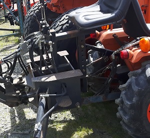

I just bought a 4520 3pt backhoe (Woods BH640 made for Kubota). It didn't come with that option at all - just a heavy duty toplink, so I am trying to replicate the Woods Saf-T-Lok kit in the short-term while I design a subframe. I just played around with it as is, and there is way more movement than I am comfortable with - I would say it is not safe to use without the limiter or some braces or something.
I've attached a pic of the Woods Saf-T-Lok rigid toplink system.
I did look at buying another brand of backhoe that basically replaced the toplink with adjustable (bolted) heavy duty square tubing, and had your typical adjustable toplink running at a 45 down from a bracket at the tractor end of the tubing to a bracket at the bottom of the backhoe for rigidity. Can you just replace your hydraulic limiter with a toplink?

I'm replicating the Woods Saf-T-Lok for my backhoe attachment as an interim measure - simple, effective, and cheap.
Currently designing a simple subframe design that will tie into the FEL subframe, so I'm not going to try to install a cylinder.
I've attached a pic of the brace/toplink system I saw on a Brands Mfg backhoe, mounted on a B7200.

With the Saf-T-Lok style, you can pull the 3/4" bolt or pin that connects the braces to the toplink, and then you can raise/lower.
