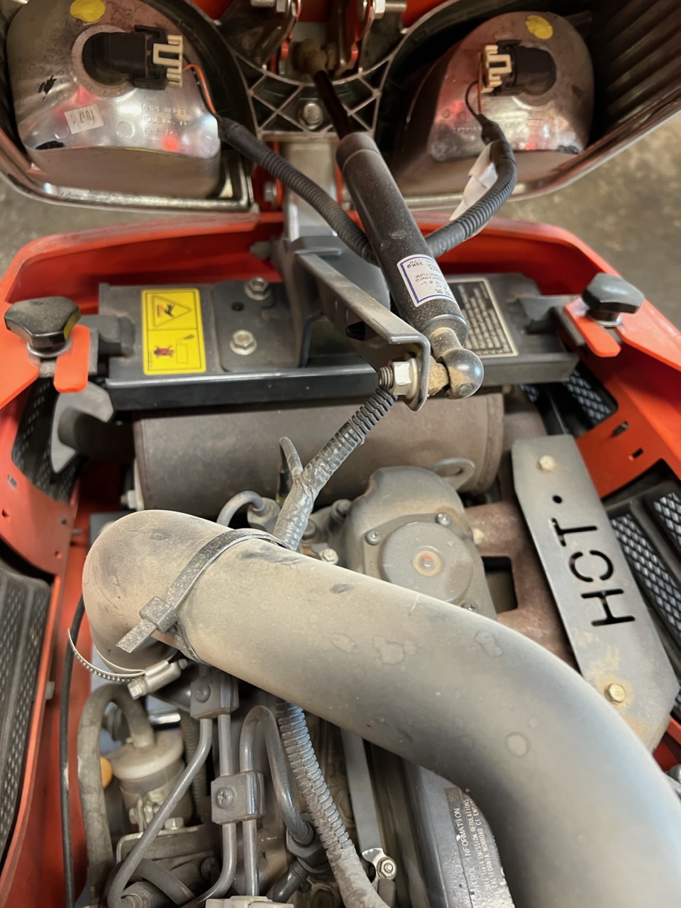

I found the same diagram. When you remove the battery panel you can see where the hook bonnet travels, near the steering wheel. It seems as it needs to catch on something near the steering wheel because it is currently loose. Prior to this when you pulled out the hook bonnet it took a slight amount of pressure. It is like a limp noodle now

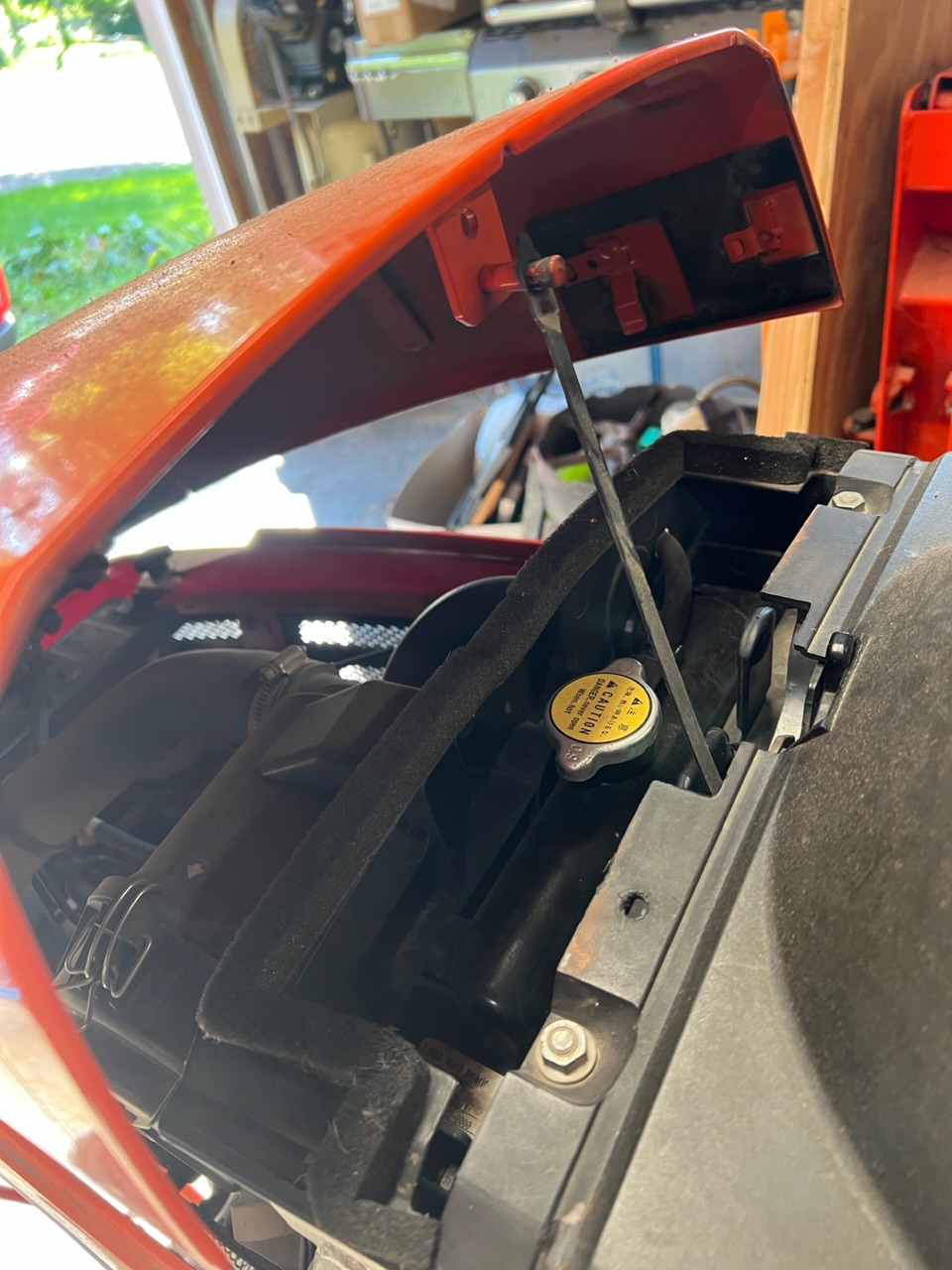

Neat, had no idea that was there. Would have been handy few times over the years. Just holds the hood at an elevation where you can get the lower shroud off.....there is no way to "make it work" unless you want to use it. Just an accessory.

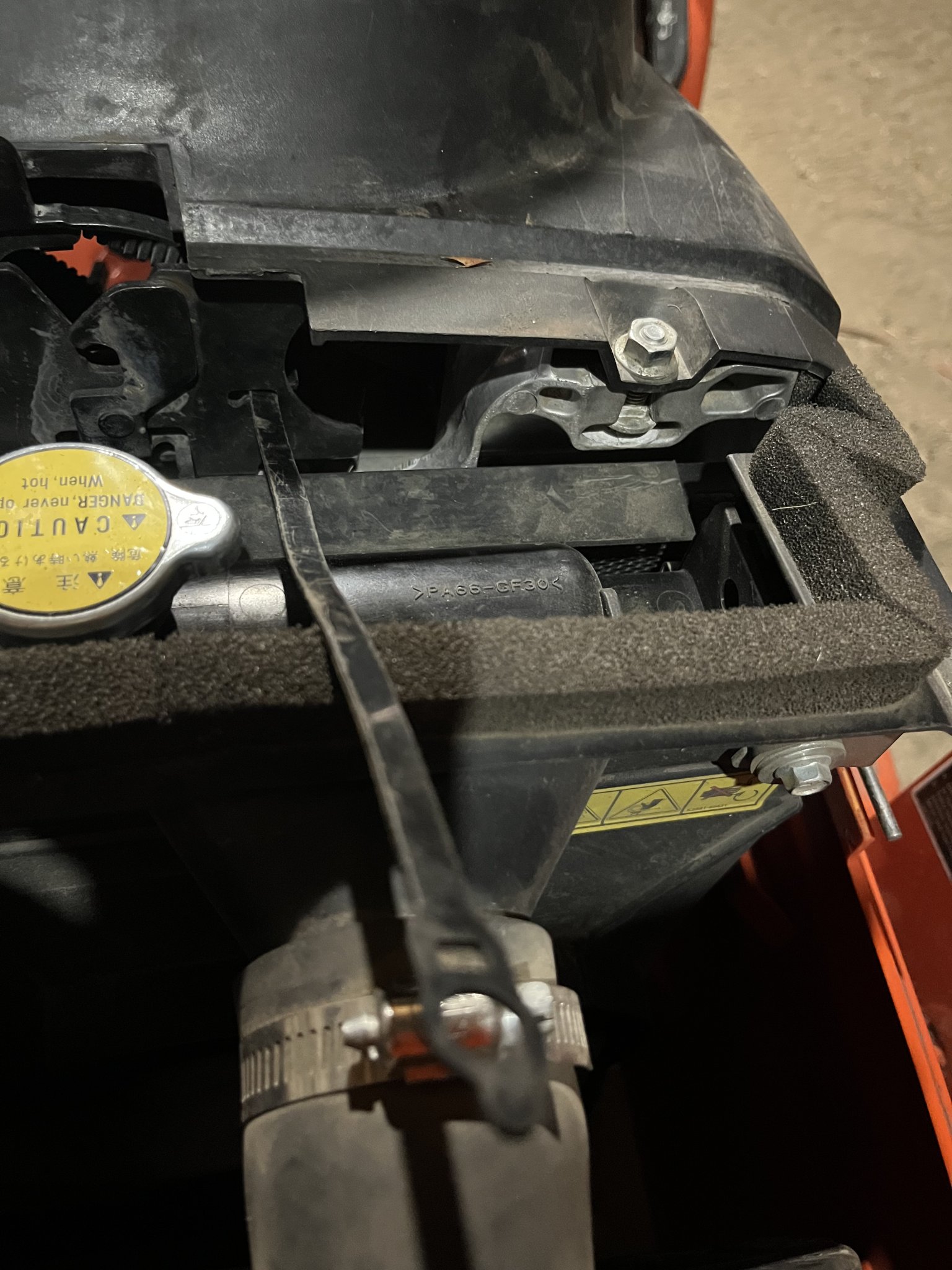

There’s the little cuss. (The electrical cord is for my battery maintainer.)

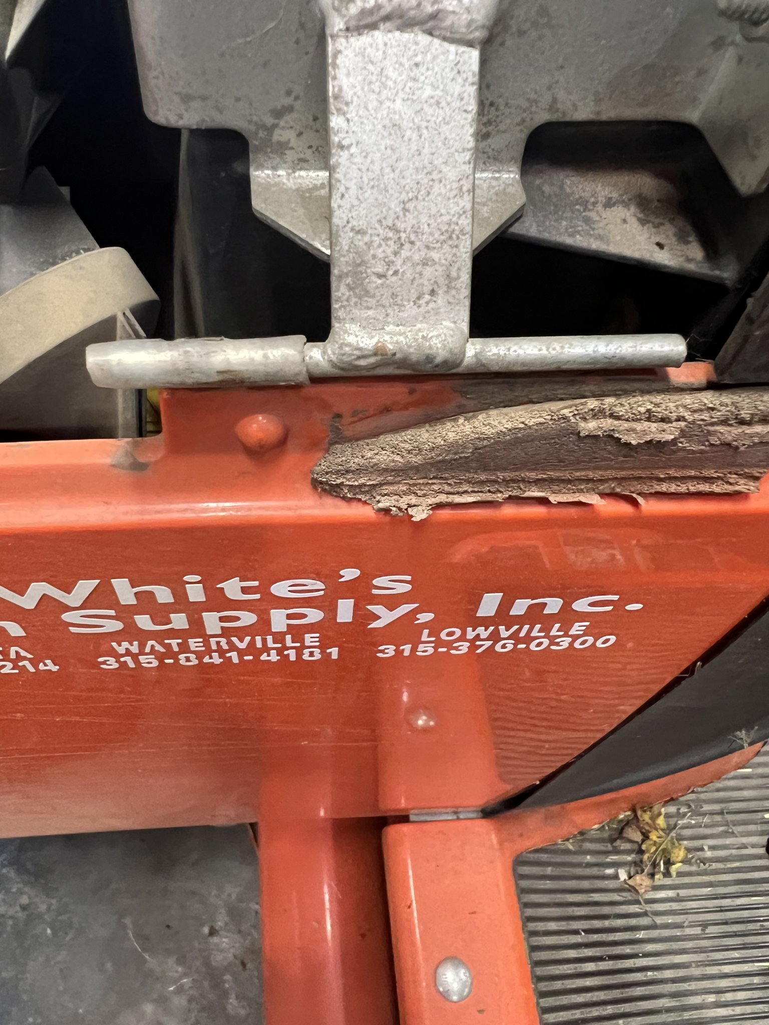

Pull it out and slide over latch pin on hood. Keeps the actuator on the hood from going too high - - that way there's more room to slide the shroud forward and take it off.
Slide it back in when done..
