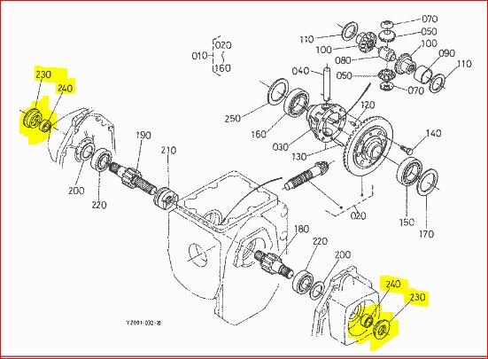

Lowinohio,
You are exactly right, I looked at the wrong set of diagrams.:eek:
buck19delta,
I'm sorry but yes you do have dry style brakes and here is the diagram for the seal and sleeve that the seal rides on.
Seal #230 serial #<= 67370 66466-14960
Seal #230 serial #>= 67369 67401-14960
Sleeve #240 67401-14960
