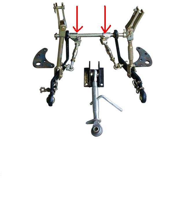

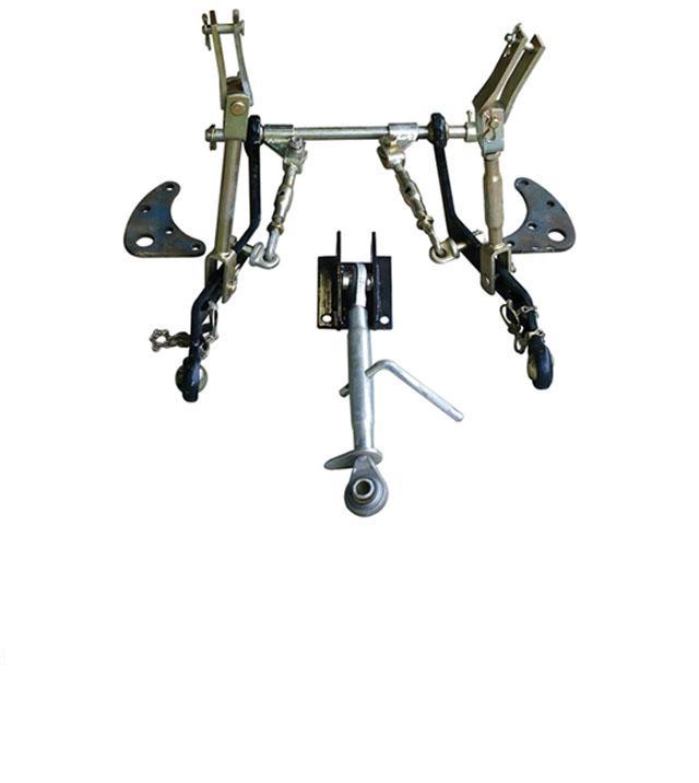

help me please kubota b6000 tree (3) point linkage
hodge
Nov 19, 2010
2,959
535
Love, VA
I agree with Eric- it looks correct.
Eric McCarthy
Kubota B6100E
Dec 21, 2009
5,223
9
44
Richmond Va

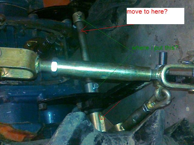

Everything seems to be in order. Not sure if you added a 3 pt hitch kit or if you want to know how to hook up an impliment but either way everthing looks correct.

and if a mount like the picture thats correct too?

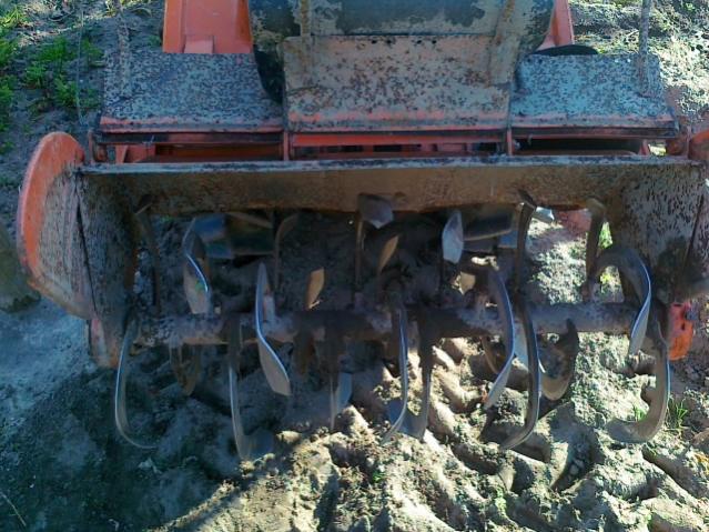

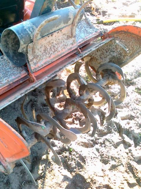

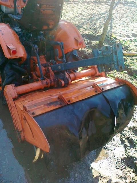

I have a rotavator s850(i think the most correct for the kubota b 6000) but I have to open the wheels because of the plow hood will be the tractor with the wheels locked?

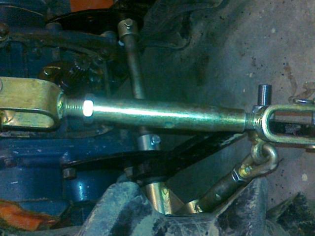

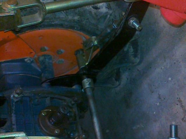

Its probably a matter of opinion but you can install the check chains on the inside of the main arms. As illustrated in your last picture. The problem with have the check chains on the out side is if you do not have an implement attached or the lower arms are not tied together the arms can swing about hit your mud gards and tyres damaging them in the process. This may also happen if you have an implement attached and the check chains are not adjusted properly.

I would say that looking at the shape of the lower arms,the check chains should be on the outside of them!
birddogger
May 29, 2011
433
Pittsburgh
I think it sounds like the rotovator may be too wide and the lift links stop the tires. I believe that is what is shown in the picture with the check-chain(link) very close to the tire.
Move the check-link to the inside.

my rotovater have 85 cm i have to put the wheels whith 85 cm
when i use plow i have to open the wheels to 100 cm , anybody have anouther solution?

you are correct chain(link) is very close to the tire and touch de tire
i have to close the wheels because the rotovator , it s have 85 cm and i have close wheels

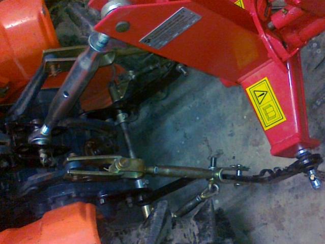

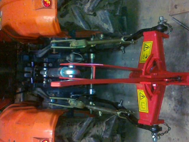

i put a pic see the pic and tell how i make? if anyboby have a schemantics how mont the 3 point , share here

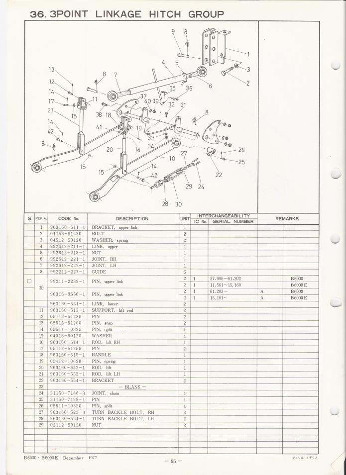

I have had a rummage through my manuals- he we go the following pictures are taken from b6000 parts manual. The only thing I would say is you have an aftermarket non Kubota linkage set as you can see there are some differences in fittings and how it attaches.
