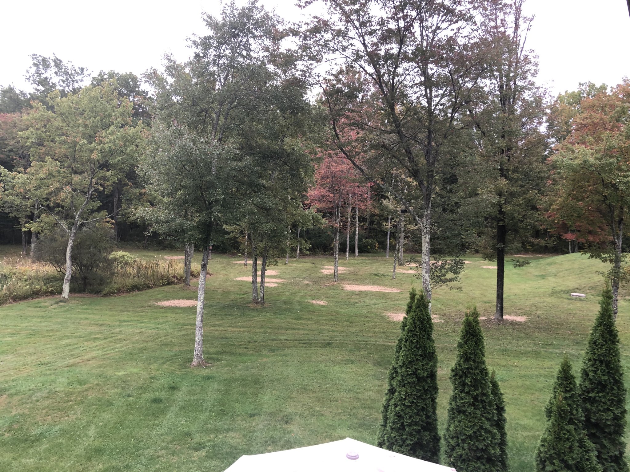

Hello everyone. I'm new here and figured I'd register as I've narrowed my choice for a new tractor to two colors, Red or Orange. First a bit about my needs and use..
I'm in WNY, close to finger lakes region and have a bit over an acre. On that acre, I've got a good size fenced in garden area with raised beds and a greenhouse. We have about 2/3-3/4 acre fenced in for my dogs to run, and we have chickens. We have many, many trees and unfortunately now, many, many stumps. about 80% of our trees are ash and we have been hit with EAB so nearly all our ash are dead. We have taken down about 65 already and have about 20 left to go. Once we are done, we'll have about 85 stumps to grind. Additionally, I want to do landscaping including prepping for a cement pad, redoing my paver patio, adding another patio, building a nice fire pit, putting in a large in ground garden, snow removal and other various projects around the house.
I know for sure I'll want a grapple so 3rd function is a must. I would like rear remotes to allow the option for things like a stump grinder and hydraulic top link in the future, although I may rent a stump grinder as the prices have really shot up over the last year or so.
I would like to get a dethather, maybe a rake and am willing to go used for that.
Snow removal so maybe a snow pusher, but I'll probably try the bucket first.
I plan to get pallet forks and a stump bucket, but I may not get these initially.
I will probably use this for all sorts of projects around the house. Probably the only thing I plan to add that I'll need to rent something different is to build a koi pond and don't think a backhoe is worth the expense for only one project. I will use the tractor I get for moving stones and landscaping around the pond once the hole is dug.
