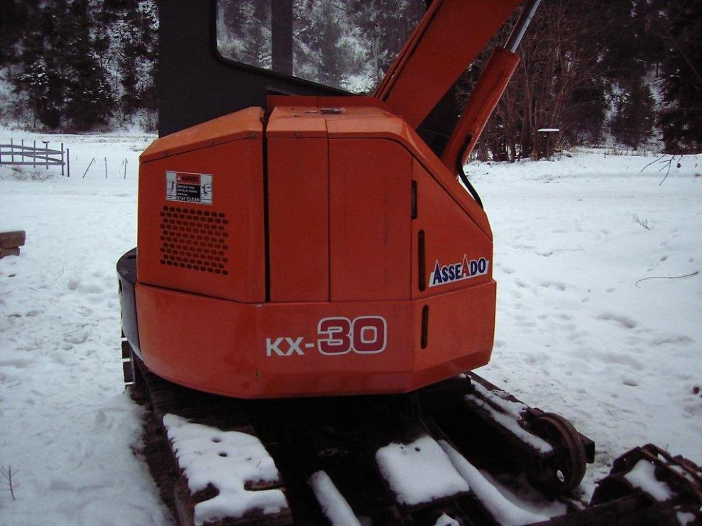

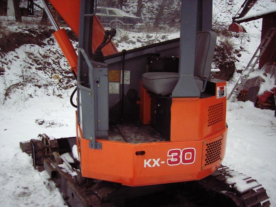

If I did it right you should be seeing 2 pictures of the rx301?.
I was looking at the serial # : 10293 Does anyone know where I can find a parts catalog/manual for it. What is the Canadian/American counterpart model. Thank you for your help

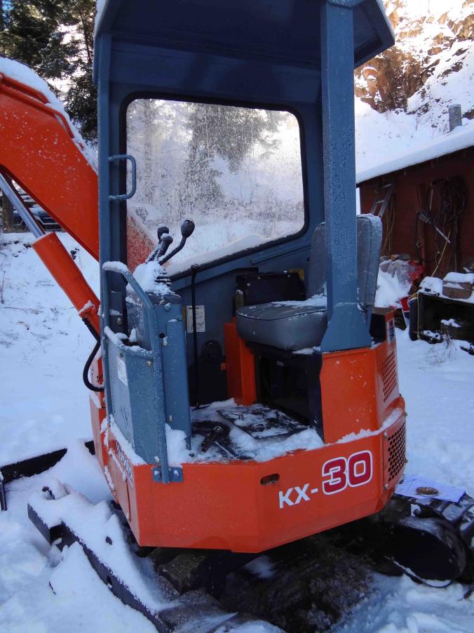

Sorry I can't be of any help, but I gotta say that boom setup is wild! Never seen anything like that.

That serial # comes up with KX121-2 and KX71-3 and about 200 other tractors and mowers (normal for Kubota, they recycle serial #'s) but no mention of your model (that's not unusual for gray/grey market).

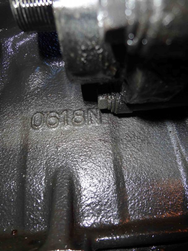

How big is the motor in it? 2,3,4 cylinder can you see the size of it, should be cast in the side of the block behind the fuel injector pump side.

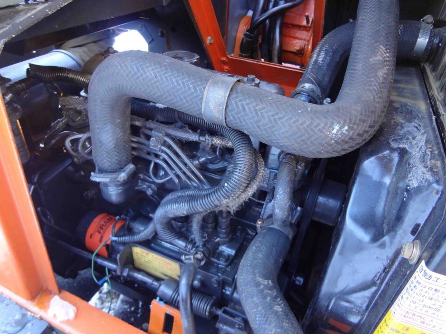

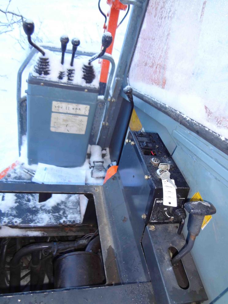

-In the photo you can see It is a 4-clyinder diesel and you can see the 0618n stamped in the casting behind the oil filter (unscrewed for the photo). All the controls are on the front on a panel. It says Kubota "Ace Gear" what-ever that means? The only model I have seen that comes close is the RX301 (which I believe is also a gray market model) Hope this helps.
-It came to me with no thermostat in it and presently does not have one. I believe it should have one, any ideas of which one would fit...or if it even should have one?

I don't seem to be able to see any more numbers on it. Anyone have any idea what size and model the motor is?
