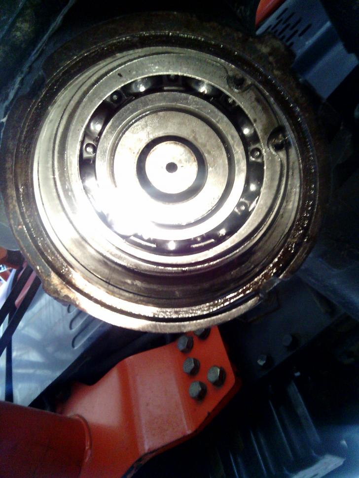

She is away at a seminar and I'm farm sitting and was trying to move a dirt pile and something broke on the right front wheel spindle?

IMG_20140921_165419_729.jpg Its an L5030 I have the snap ring 2 washers and the cap. I can push the center pin up but the bearing looking thing won't budge. Is there some place to get a diagram of what it looks like inside there?

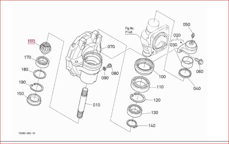

You might have gotten lucky, the part that I thought was cracked is actualy made that way, here is what your looking at inside.
On rare occasions that snap ring has been know to come off and the bearing (170) moves and pops the plug (150) out.
The 2 washers (180) are shims that set the load on the bearing and gear.
Lift the weight off the front end and see if you can get the bearing to fit back into place then install the shims and then snap ring and the plug.
then you will have to refill the front axle up to level with UDT fluid approximately 9.5qts.
Also read this post.
http://www.orangetractortalks.com/forums/showpost.php?p=24690&postcount=10

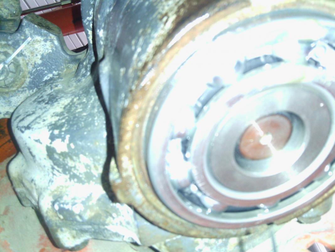

Okay so I think I got it but there is a little play in the race bearings? are the shims supposed to hold it super tight? View attachment 12941
when you say a little play.......
like a sheet of paper thickness? or 1/8"?
where is the play? side to side or along the axis?
36,627
11,355
Normally a little (1/16 to 1/32) play Up and down is normal and needed otherwise it will force the gear up too far and be too tight.
Side to side play would be a bad and you'll have to dive into it a little more.
On the hub there is a drain plug remove that plug and when filling wait for a little fluid to start to run out that plug then put the plug in and fill to capacity.
If it pops the snap ring again then 1 of 2 things is going on, either the snap ring has rounded edges and needs replaced or there is something more going on in there.
Oh and nice camera work! ;):D:cool:
Just to add here for future reference. I had to take the tire off. I used a round piece of wood and hammer to free the race, it took a few taps then went up by hand. I used a little bit of the oil that I was able to collect on the face of the shims to get them to stick for a few seconds to get the snap ring in. I just used a pair of needle nose pliers to get the snap ring in but I had to file them down a little to get them to stick through enough to hold. I see why Wolfmans idea to loosen the drain is a good one as the system seems to trap air. Learning this thing from the ground up
