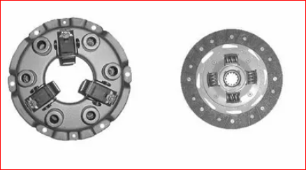

The B77100D has a single plate dry disk clutch.
When I fist read your post I was thinking your issue had to do with the brief period of time when the clutch is getting engaged. A condition usually called "CHATTER," and caused by :
Clutch chatter is usually caused by contamination of the clutch disc friction surfaces. Contamination can be caused by oil or hydraulic fluid leaking onto the clutch disc. Chatter can also be caused by loose bell housing bolts, broken engine mounts, and a damaged clutch linkage.
