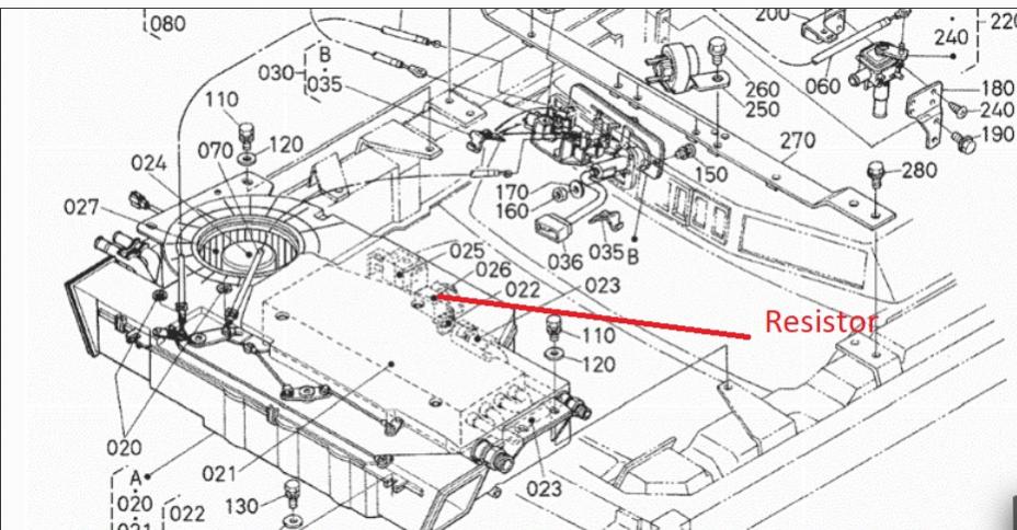

Got the resistor out and tested it. It tests to the specs so it is good. The fan does spin but only at 1 speed and not enough to blow enough air. Can barely feel the air thru the defroster vents. Thanks.

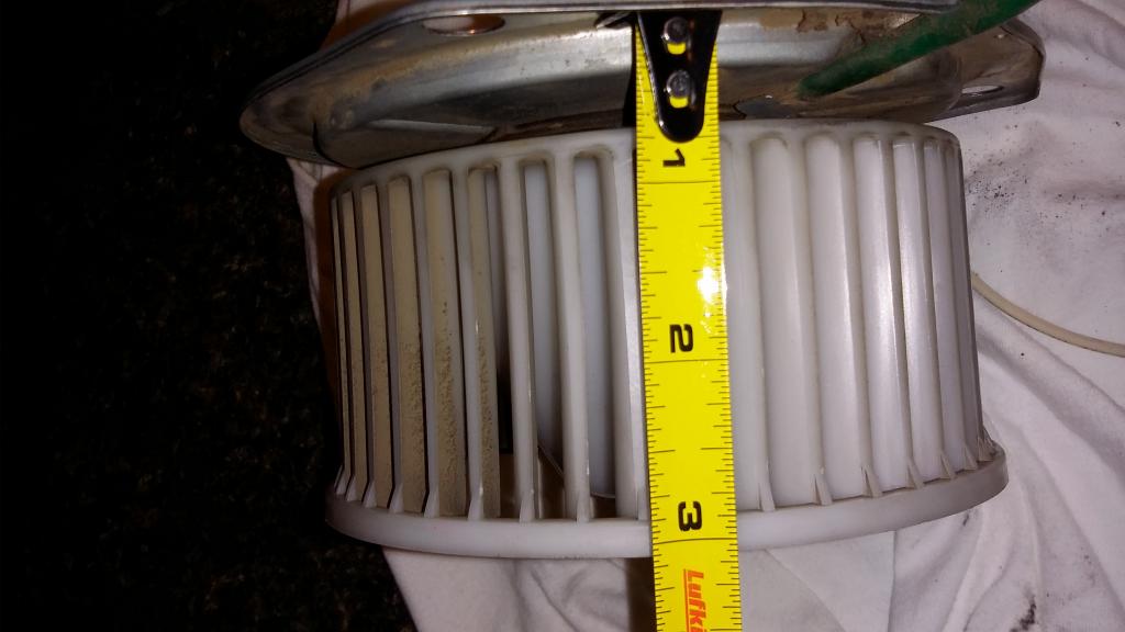

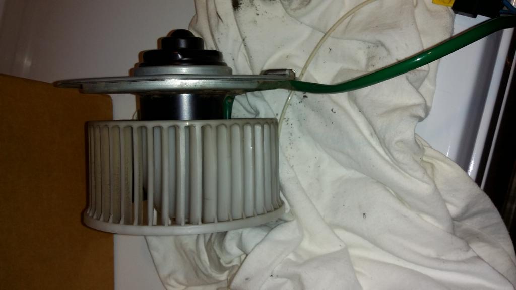

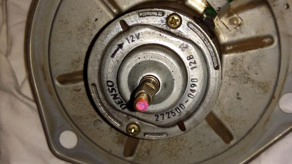

Does anyone know of a replacement blower motor that may fit in place of a Kubota blower motor? Or any reason why a $35 blower motor shouldn't be used to replace the $500 Kubota with a little modification. Thanks.
Bringing mine in Monday to a shop so it can be looked at and maybe fixed but the guy said they purposely do not make replacement parts so you have to buy a new one
Could you post a photo or two of the motor.
Dave
14,703
7,215
A few months ago helped a neighbor with his M9540 cooling system. He had to replace the motor on his tractor. The motor is mounted in a housing that could not be duplicated with any stock motor. Maybe your is different, but I have my doubts. Good luck and post some picture of the motor when you can. Thanks.
