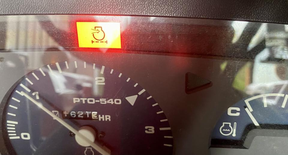

The wires look light blue and black in the pics so should be air filter lamp. Easy enough to check, short the wires together and look at the dash.
By the way my L4310 has basically the same configuration in the harness and that's what they do on my tractor

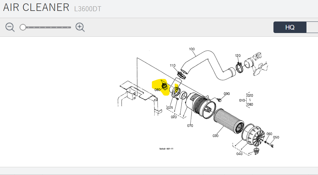

so.... some 'idiot light' comes on when air filter is plugged up ( restricted ) ?
Curious as wire don't seem very long....
33,173
8,558
The switch was under the bottom of the elbow.
The wiring only needs to be long enough to reach the air filter switch on the air filter housing.
