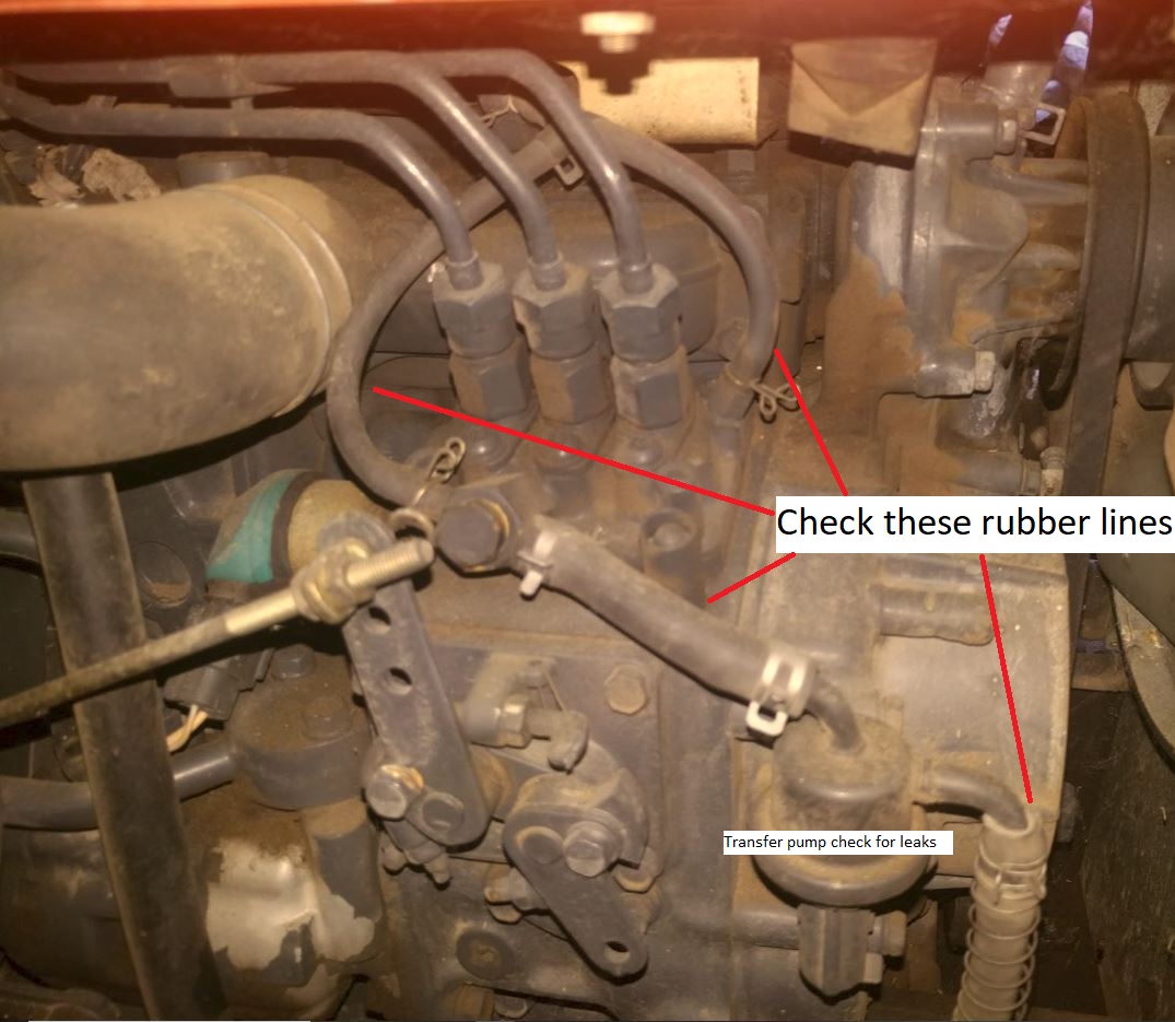

I used to have a WSM for my old B7510 but I gave it to the person that bought it last year.
I had about 980 hours on it when I sold it and it always started right up if you used the glow plugs. From the description of your problem I would say it's sucking air into the fuel rather than a glow plug issue.
Given the age of the tractor look at all the rubber fuel lines replace any that look cracked. It might be that they are letting fuel to run away from the injection pump.
The longer crank time is the transfer pump refilling the line to the injection pump.
Another thought is did the new fuel filter have both the small (on the filter) and large (on the bowel) O-rings? were they new or reused?
Also what about the engine oil is the level going up? Does the transfer pump have a leak that leaks into the oil pan?
See the attached photo from my old 2004 B7510 for some ideas

I guess I am not sure how to use the glow plugs or if it has any.
When I got the tractor I replaced the entire fuel filter housing and all the fuel lines. All of that stuff had frozen and busted. The crankcase oil is fine. I have not seen any leaks.
