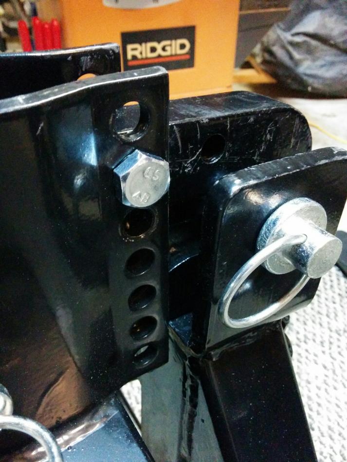

Had this in the garage for a week and never thought about using the top hook rotated in that way with only one bolt. Any ideas on how strong or safe it is that way. Here are the pics of it done the way sgtboz showed. Only temporary, I have already ordered a top link adapter. Thanks.

Since you ordered the top link adapter use it when it comes in. However, I woulld not be afraid to use the top link with just one bolt because there is really no weight on it. All of the load weight would be on the lower pins.

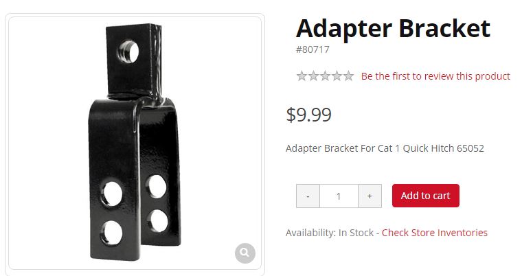

Ordered from Harbor Freight via phone. Not available in stores or online. $25 including freight and took about 10 days to receive. Agri-Supply shows one that might work on their website for $9.99.

And yes, LM, I think the one from Agri is the same

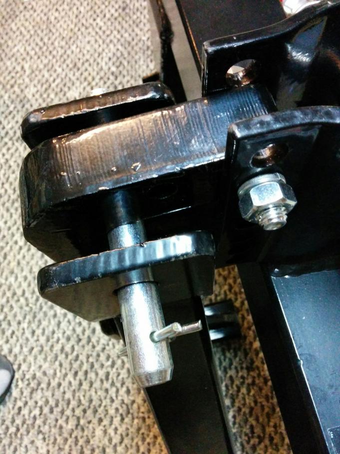

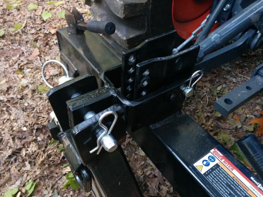

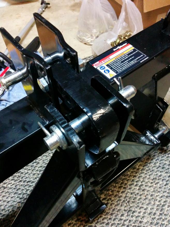

Have you guys ever tried any kind of quick hitch pins to hold the top hook in? Kinda a pain to unbolt it to use the hitch adapter.
I use pins to hold the top hook on. See the pictures attached.

I wouldn't run like that. With just the adapter it creates a triangle between the upper and lower links, so it's solid. Set up like in the video, the adapter could rotate up and out of the hook. With tension in the adapter (lifting the implement, fit example) there probably wouldn't be an issue, but when dragging a back blade or plow or anything, that should put the to link in compression. That's where it could slip off.

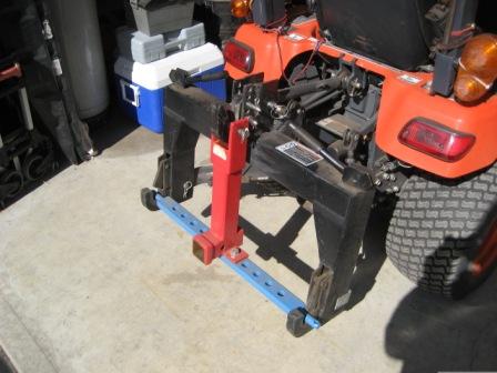

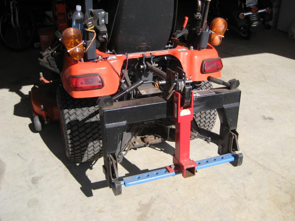

Thanks, do you know the dia. Of the pins? What's that hitch called that's bolted to you draw bar? Gotta get one of those.
Those are 1/2" pins. I could not find pins the same diameter as the bolts so I ended up buying the 1/2" pins and drilled the holes on the hook and the quick hitch out to fit them.
As for the hitch, I bought that at the Kubota dealer. It did not have a brand name on it so I suspect that it came from China. It works great though. I use it to move all of the trailers I own, including my 7500 lb travel trailer.
