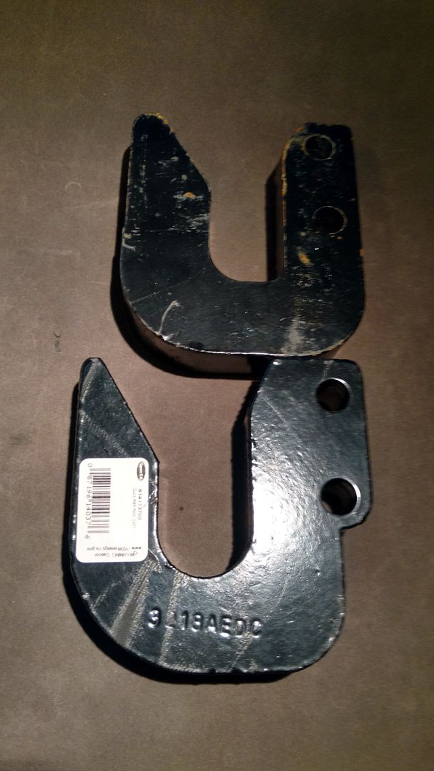

I love my HF quick hitch, but the hook binds a bit on my carryall. I found this replacement hook that moves the front of the hook farther back from the bolts. I'll report back after I try it out
Harbor Freight QH hook on top, replacement below

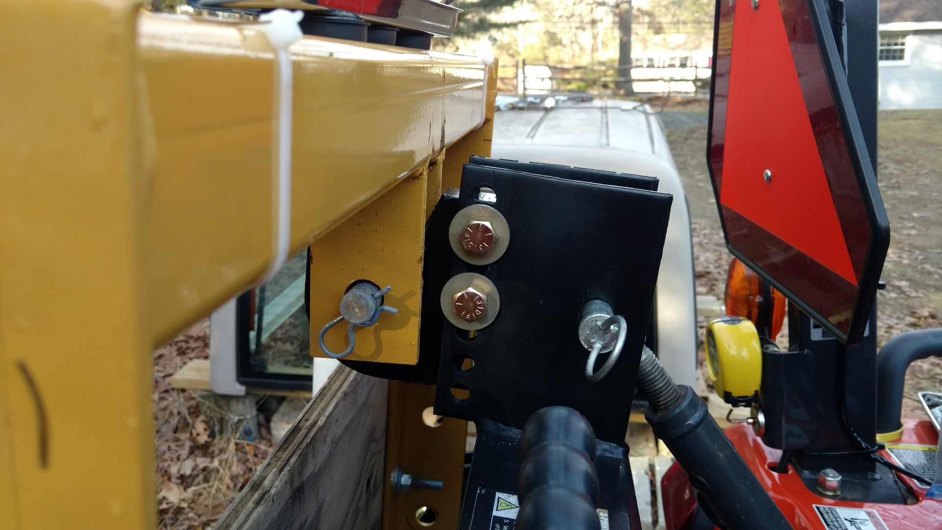

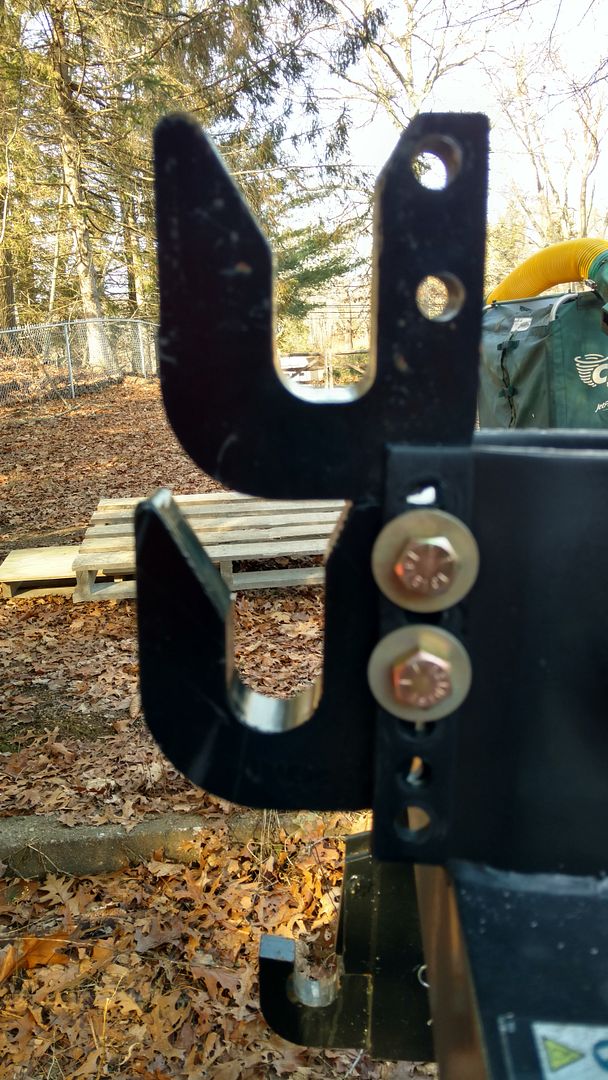

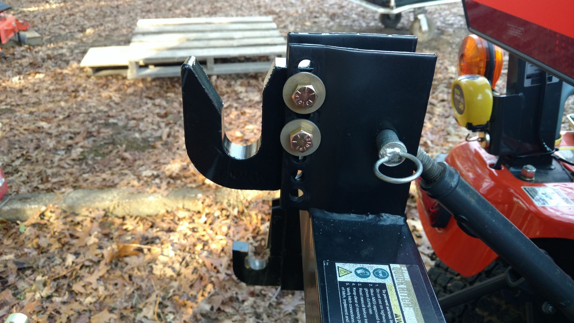

Finally had a chance to install the new hook today
Turns out the Harbor Freight Quick Hitch had slightly undersized bolt holes (probably made over-seas) , so I had to drill the holes out to standard 1/2"
Here's the stock HF hook above the new one - the extra 1/2" extension to the rear is noticeable
Finally I can hook up my carryall without the carryall top link mount binding on the HF top link hook mount and bolts! That extra 1/2" off-set of the new hook makes a huge difference!
