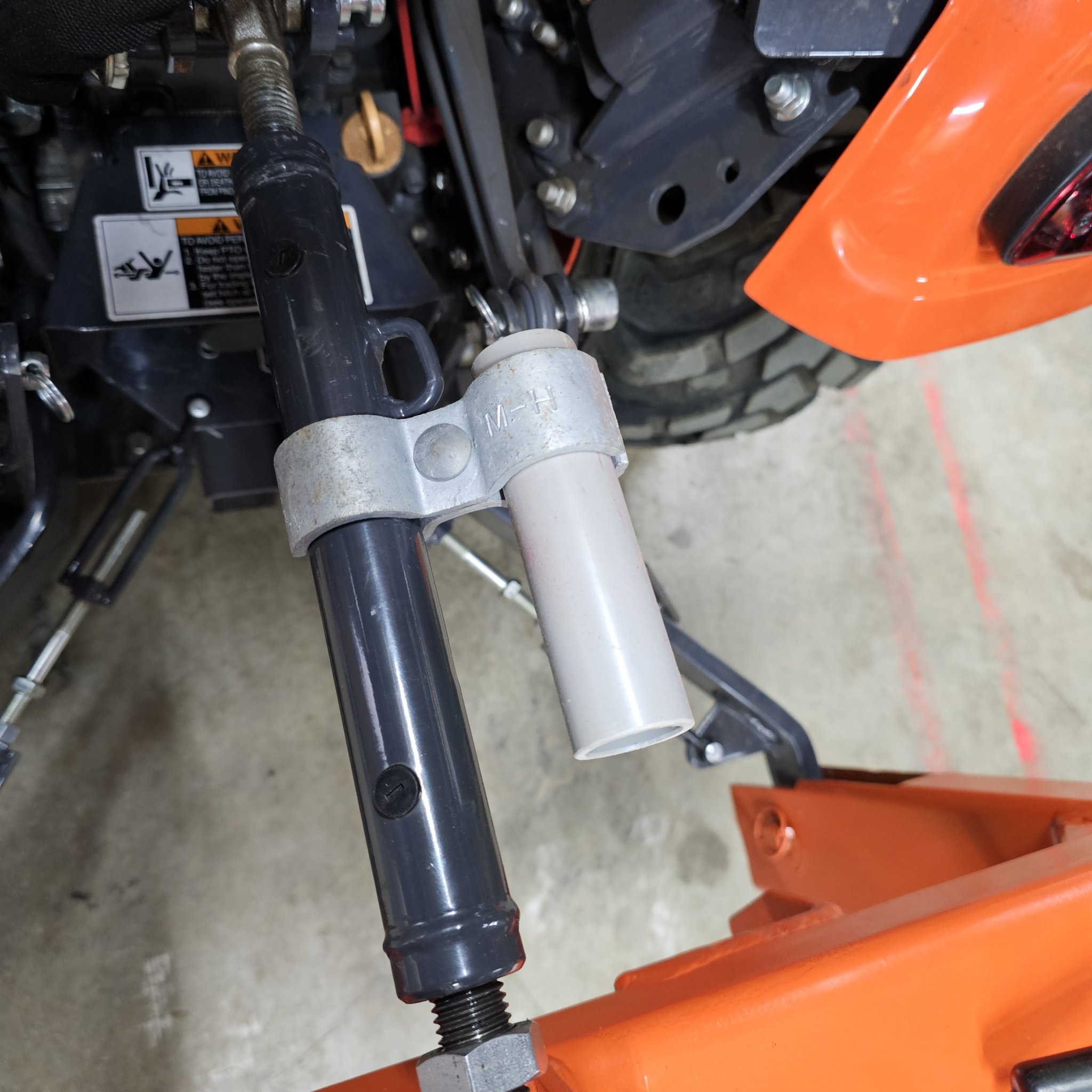

I use a Chainlink fence panel clamp and a section of sch40 electrical conduit.
