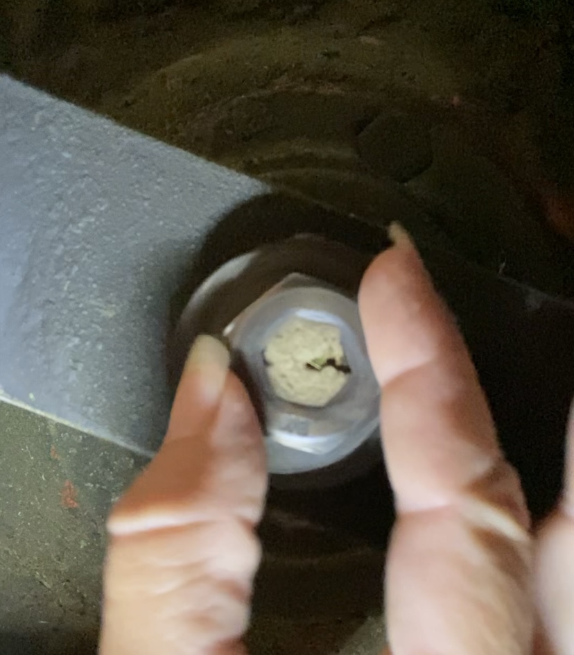

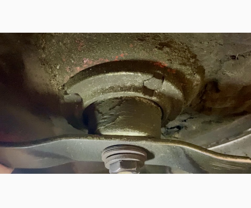

Yes, actually I had somebody check it and the whole assembly is loose. And it will not tighten up. A new spindle has been ordered and hopefully that will fix it.
However, I did remember something and please don’t laugh… I crashed into a crêpe myrtle with the deck about a week ago, could that have damaged that? It was on the same side also.

What you describe sounds more like traumatic damage as opposed to normal wear. Not quite clear if the crash involved the deck only, blade only, or both. When you replace the spindle, check the blade to ensure it isn’t bent, check the blade to ensure it’s level when installed (deck isn’t bent where the spindle attaches), and the blade spins without hitting the deck. Hopefully replacing the spindle fully resolves the issue.
If the thread of the nut is fine the spindle thread must be damaged. Could be due to tightening it too much (impact wrench) in the past. Typically the nut would get damaged first, did you check that?

Something‘s not quite adding up here. If the whole assembly is “loose" the issue would have to be more than just the spindle. For an outside spindle at least, one of the bearings would likely have to have disintegrated somewhat.
So I’m guessing that the bolt the secures the blade to the spindle came loose and the person that checked it out for you concluded that the threads inside the end of the spindle that the bolt threads into have been damaged beyond repair and therefore the spindle needs replaced. And perhaps what you’re feeling is the blade not being securely fastened to the end of the spindle, and getting the sense that the whole assembly is loose when it probably isn’t. If that was the case the person that checked it out would probably also be ordering bearings and seals.

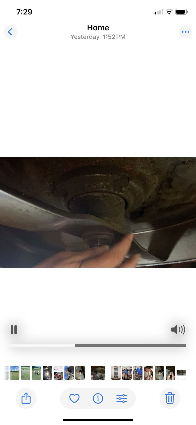

It did not appear that the note was damaged, but like I said it was loose, but when tightened the assembly would spin along with it. Which that leads me to believe that it may not even be the spindle or anything, but the assembly that all of that is attached to has come apart from the actual deck if that is possible.

Sorry my mistake, after properly looking at your picture there is a bolt in the spindle holding the blade, not a nut. Need new glasses :giggle:
Just find out what is loose. Or maybe, as mentioned before, one or two of those washers are missing and that is why the blade is loose although the bolt is tight. Did you find the drawing for your deck and are all parts there in the right sequence and orientation?
Or did the bolt slip in the thread when you tried to tighten it? Was not 100% clear if the blade was still loose or the bolt itself.

My suggestion is to remove the deck. Yes, it’s a PITA but should be done to do a thorough inspection of all parts. A loose blade would be more of a bad vibration than a grind. But if the spindle failed, can see it grinding. My 54 inch deck has 3 blades, with the center having a housing that needs the proper oil. Was thinking that wasn’t changed like it was supposed to. Getting the deck off isn’t to bad, getting it back on sucks. Has to be perfectly aligned to get it to attach. You should be greasing those zirks after each cut. But to get to that fluid box requires the deck off. You’re at the right place for help as the folks here are great for help. Good luck and keep us posted on your progress.
