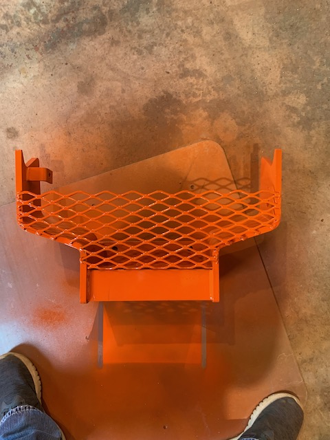

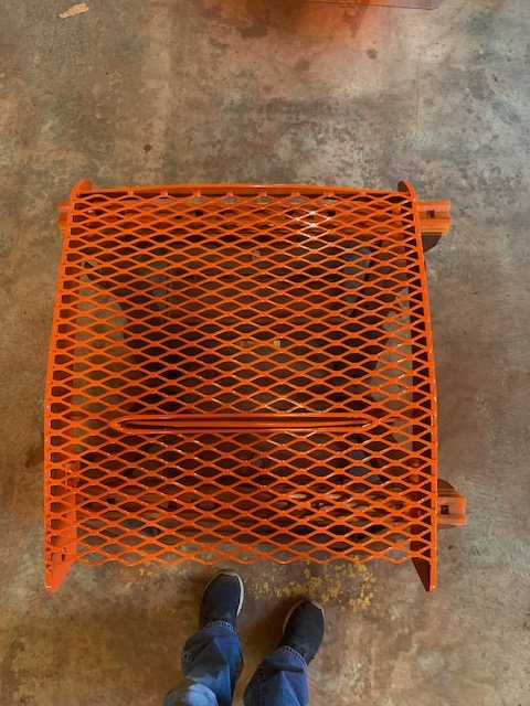

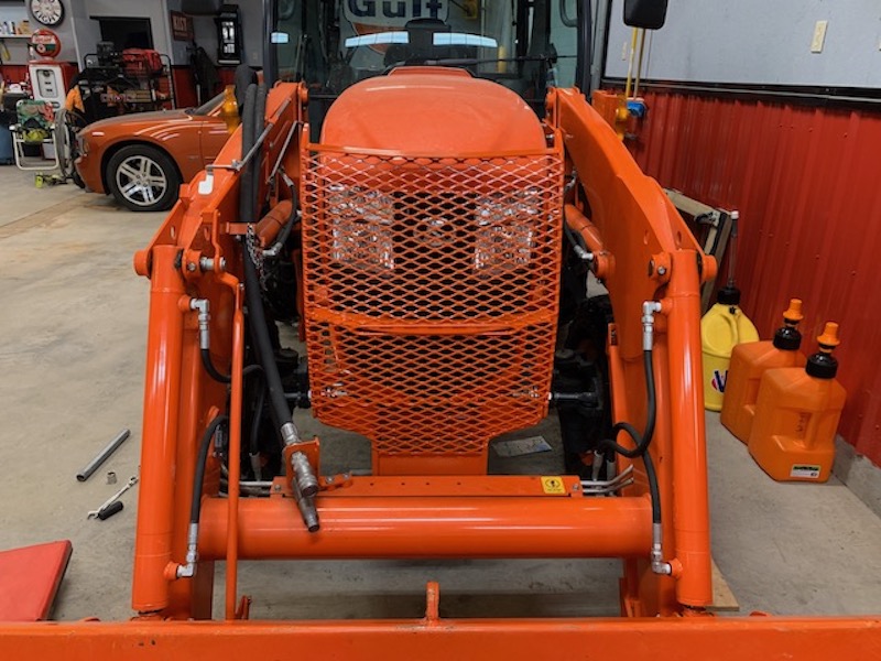

I made a post similar to this a couple months ago because I wanted one as well. (You can see my thread here if youd like) I looked everywhere. You will NOT find one that you can just buy aftermarket. Your only option is to fabricate one yourself, or have someone else do it for you. I elected to do mine myself, after poking a 2nd stick through the front plastic grill guard on my L2501. Minor cosmetic damage, but after a 2nd time, and me trying to be careful, I said nope, time to do something. I went and bought all the parts, and a cheap welder. (A little 100amp welder will work fine for metal up to 3/16" which covers this job) I had never welded in my life. I got a few extra pieces of iron when buying to use as "practice pieces" I took about 30 minutes to play around and practice, then went to work on the job. Its not that hard a job honestly. What you will want to do:
1. Take an angle grinder and grind the outside front edge of the grill guard beams on the left and right. You only need to remove the paint so you can weld to it.
2. Place the expanded metal over the front and clamp it down in multiple spots - it needs to be tight and secure. mark it up so you know where to cut it to size. Cut it using angle grinder cutting disc.
3. Put the measured and cut expanded metal piece back in place and clamp it all down, all the way around. Its important its tight and lined up perfectly how you want it. Start welding each spot it contacts the grill guard arms on the left and right. Careful not to burn through it. The welding happens fast. This is where my practice game in. Even on my 100amp welder I had to go to half power as I was burning through the expanded metal so fast.
4. wire brush it all down, Lap it with a lapping disc on angle grinder to blend the welds in better, and make it look better.
5. Paint it using Kubota orange spray paint. Can befound in tractor supply or on amazon.
My Finished Results:

Its very possible an individual was doing this - Ive seen individuals on tractor forums take up similar en devours and sell to other members. In my search I never found anything I could just buy, because that was my initial preference. Its really a very simple modification. I was surprised how well it came out. If you have the welder, and an angle grinder, its impossible to mess it up unless you cut the expanded metal too tight - so I aired on cutting it just a hair too wide then after welding it in place you can go back with angle grinder and clean up any protruding pieces or ugly welds. A lap disc on the angle grinder cleaned it all up nicely before painting.
You also will have to choose what gauge expanded metal you want. I went with 13 gauge, but some people also use 9 gauge. The 13 gauge is a lot stronger and sturdier than I thought it would be. You could beat my grill with a baseball bat now and it would hold up I think. It feels very solid.

Nice job on these guys. I will be doing this next. I like it on the outside of the guard vs the inside as I have seen on some and I like the full cover to the bottom. On the B2650 the space between the grill and the guard is already super tight.
