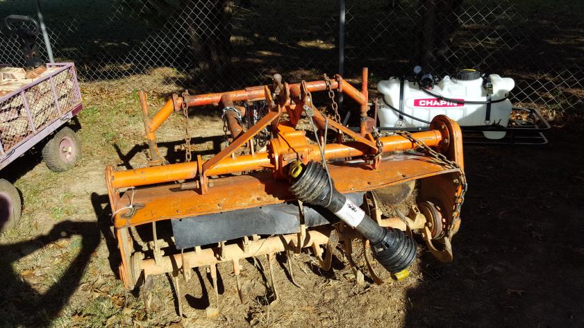

Did I make a mistake in getting this tiller? Price was just too good to pass up, but it looks like I may have jumped too fast on the deal.

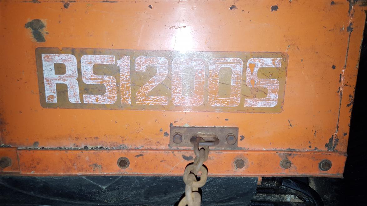

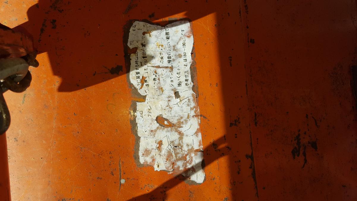

Tiller appears to be a RS1200S, the only other label is too badly worn to ready anything and it's in Kanji or Korean or Chinese or ???
I read in this thread
http://www.orangetractortalks.com/forums/showthread.php?t=2440
That there needs to be an articulated top link, but I don't have one. I have seen on threads in TractorByNet where people have created 3pt exentions for the lower connections, to move the tiller away from the tractor by a foot or so. Would that be my only option here?
It's also missing one tine, would the yanmar tines for a RS1200 work?
When I had the tiller in the air unloading it, the drive system felt good, no play or anything.
i haven't had a chance to hook it up to my BX yet, not sure if I even can. :(

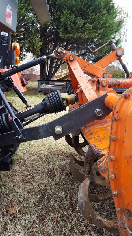

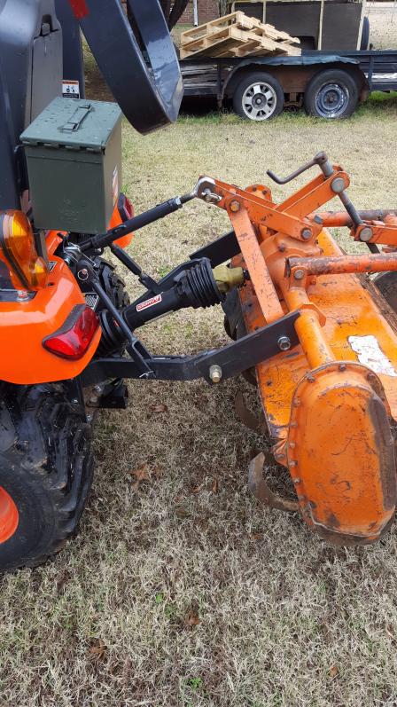

Ok, finished up the extensions, hooked the tiller up and all works as it should!
Still some finishing touches to do, painting the extensions for one and doing some spot welds to further secure the extensions to the tiller, and I want to get 1/2" longer bolts for mounting the extensions.
I bought a 1/2" thick, by 3.5" by 24" piece of hot rolled steel. In the center of the piece I cut a hole that was 2.5", which is the approx size of the pipe running accross the tiller. Then I cut it in half, giving me 2 1' pieces with a notch in one end. The old hitch pins were so poorly in place, it looked like someone tried to weld the pins in, but failed. So I bought a new set of cat 1 pins. Drilled holes for the pins, opposite the notched end. Then I lined up the extension on the tiller to see where I needed to drill a hole to line up where the old pins where. Marked and drilled a 3/4" hole.
This resulted in the tiller moving away from the tractor about 8.5", which was enough for me to get use the PTO shaft that came with the tiller and connect my toplink.
I did some tilling to test it out, worked like a charm. So much faster and easier than using a walk behind tiller :)
