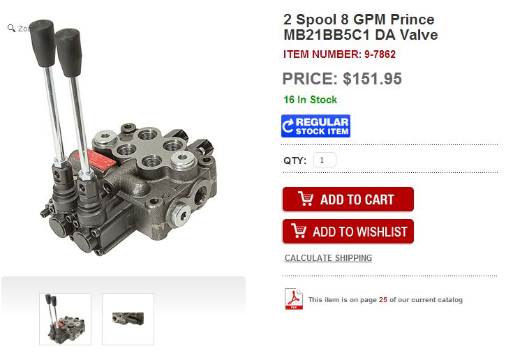

Will an aftermarket newer valve like a joystick control one fix the issue? I realize I may have a volume or pressure issue too but as far as 2 controls at once.
billrigsby
Mar 17, 2015
1,039
217
Florissant CO USA 8213'
www.facebook.com
Not sure if it will fix the problem, that depends on what it is,
this is the one I got for my M10 model (the stock one was leaking like a sieve).....
https://www.surpluscenter.com/Brands/Prince-Mfg/2-Spool-8-GPM-Prince-MB21BB5C1-DA-Valve-9-7862.axd.....
.....and it has a joystick adapter kit.....
https://www.surpluscenter.com/Hydraulics/Hydraulic-Valves/Valve-Parts-Accessories/Joystick-Kit-For-Wolverine-MB-Valves-9-7867-J.axd
