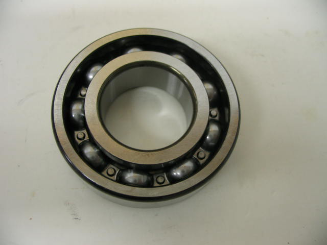

I wonder what good they (grease and zerks) do on spindles which are made up of a shaft, a housing, and sealed bearings.
That would be a conundrum if true. Messicks does not think they are sealed bearings. Picture of a RCK60-32 spindle bearing, part number 08101-06205, from their website.
Yeah…that depicted is not a sealed bearing. I have two mower decks which have zerks on the spindles…..I greased them ….and within 2 months one seized…. opening it up …. showed them to be sealed bearings. I found a number imprinted on the seal… googled it….found a chinese bearing copy…sold by the dozen online…..pressed one onto the shaft and returned the spindle to service. A year later it’s still doing fine.
The other deck also seized a bearing and I replaced it also. 6 mos now doing fine. I don’t think the zerks are for anything but “show” on those mowers. (BETSTCO brand finish mowers)

I will simply note that had you bothered to replace the sealed bearings with open ones the zerks on your Betstco deck would now be functional.
