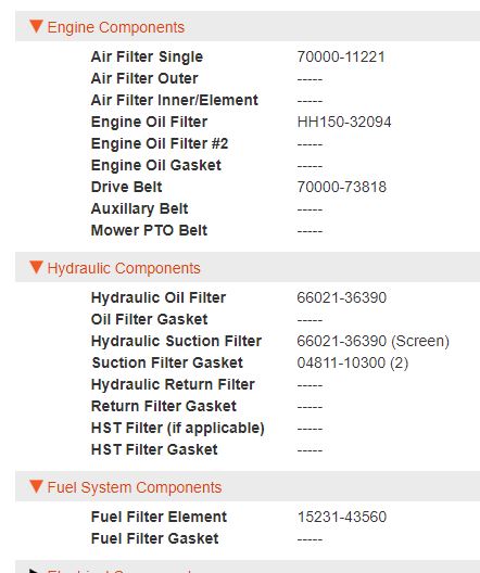

For parts info just go straight to the source, Kubota because old manuals have old part numbers:
For hard parts: https://apps.kubotausa.com/illustrated-parts/
For disposable parts: https://apps.kubotausa.com/quick-parts/
You'll get this kind of info:

I guess this gray market thing through me for a loop. I had just read about the night before I was to go see the tractor. I didn't know about the Kubota links you sent. That will make things in the future a heck of a lot easier. Thank you for all the help. I have lots to learn ;-)
