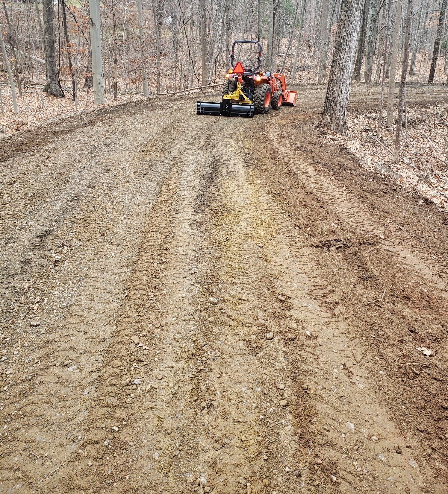

I also have a gravel driveway and the above posters gave me the same advice. The driveway has a significant elevation drop and suffered from ruts created by heavy rains.
I used the box blade to move material so I had a pitch to one side. The rain will run off the side now, not straight down the fall line. I then used the back blade to clean things up and help move some (now loose) material. Worked out great for me.

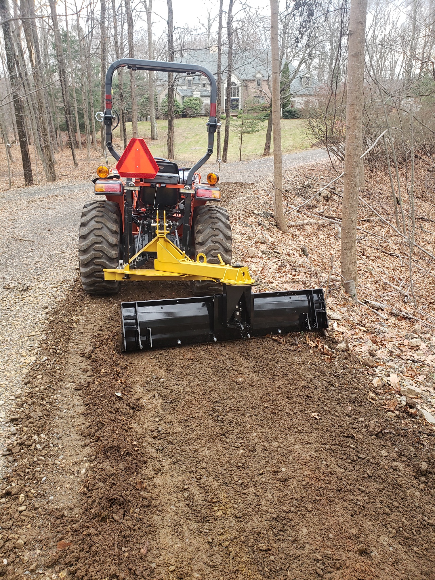

Whats the make and model of that rear blade? It looks heavy duty and very adjustable, does the blade tilt also?
3,724
6,996
It's an EA Xtreme duty blade - it does tilt. I have been very pleased with it

That does look sweet. Much nicer than our light weight with no offset and I suspect more effective. Ours does fine with loose material but it has to be either new material or loosened up with the box blade or ripper bar before it does anything other than bounce over the top. I found it more useful than the box blade at putting the final touches on the crown for the road, but some of that could be my lack of skill with the box blade. As indicated by the relative condition of the two implements I have more experience with the backblade.

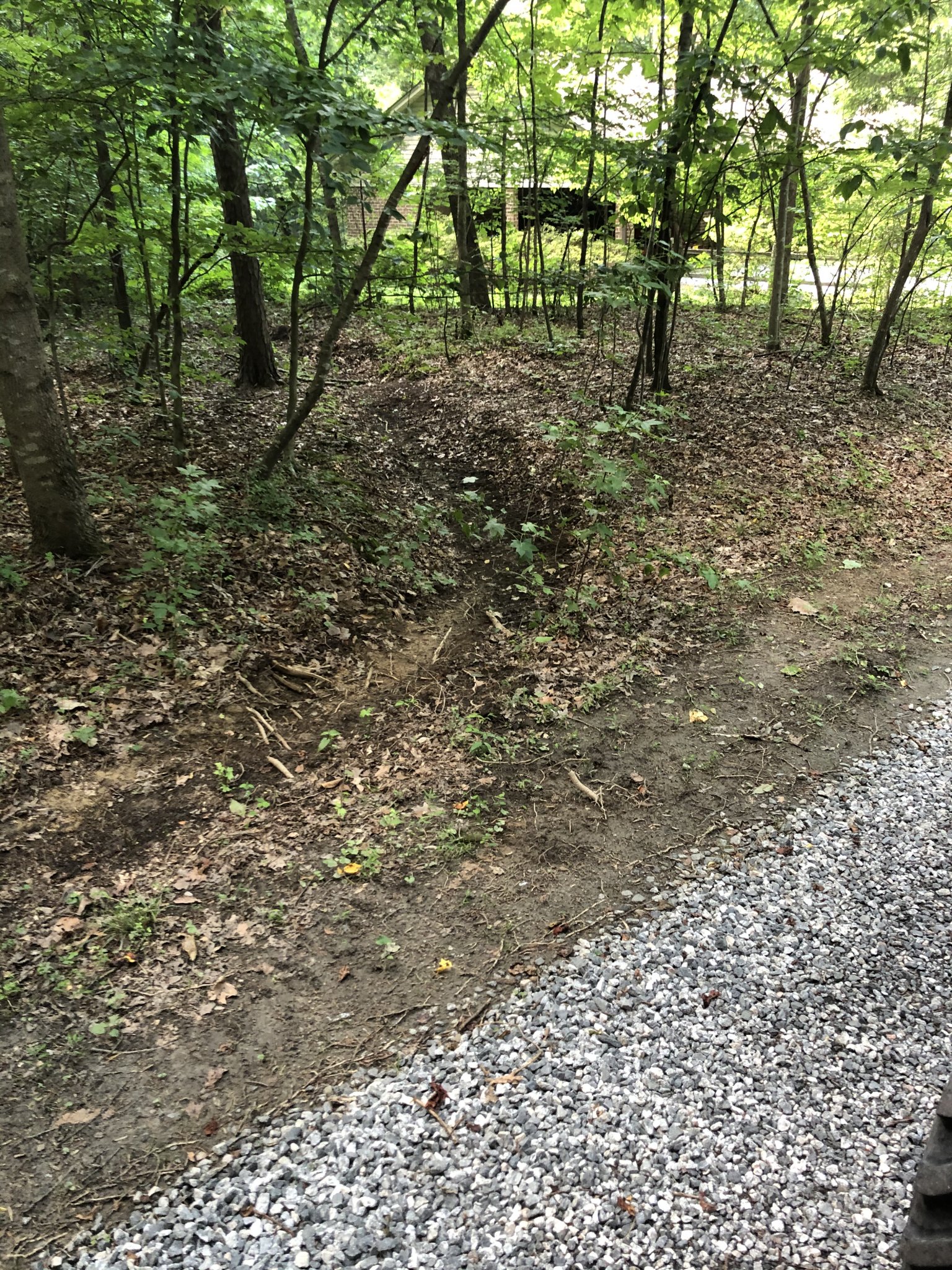

I live in the mountains of western NC. My driveway is gravel (rocks) and has grass taking over part of it. The driveway I want to add is on a sloped section of my upper field and is currently just grass but my subsoil is basically clay/dirt mixed with A LOT of baseball sized rocks.
Sounds like your baseball size rocks might give you a decent base to start with if you have enough of them.

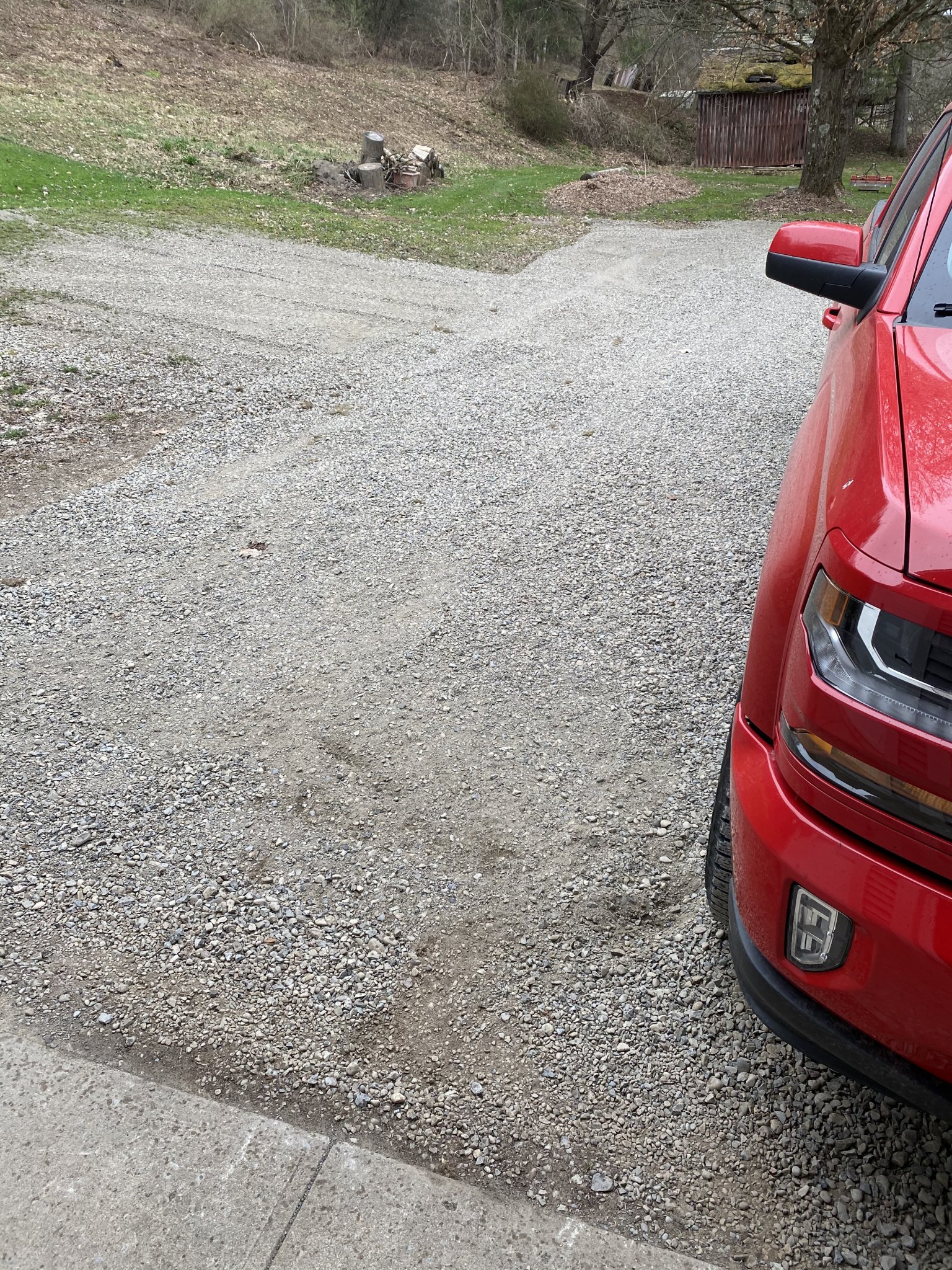

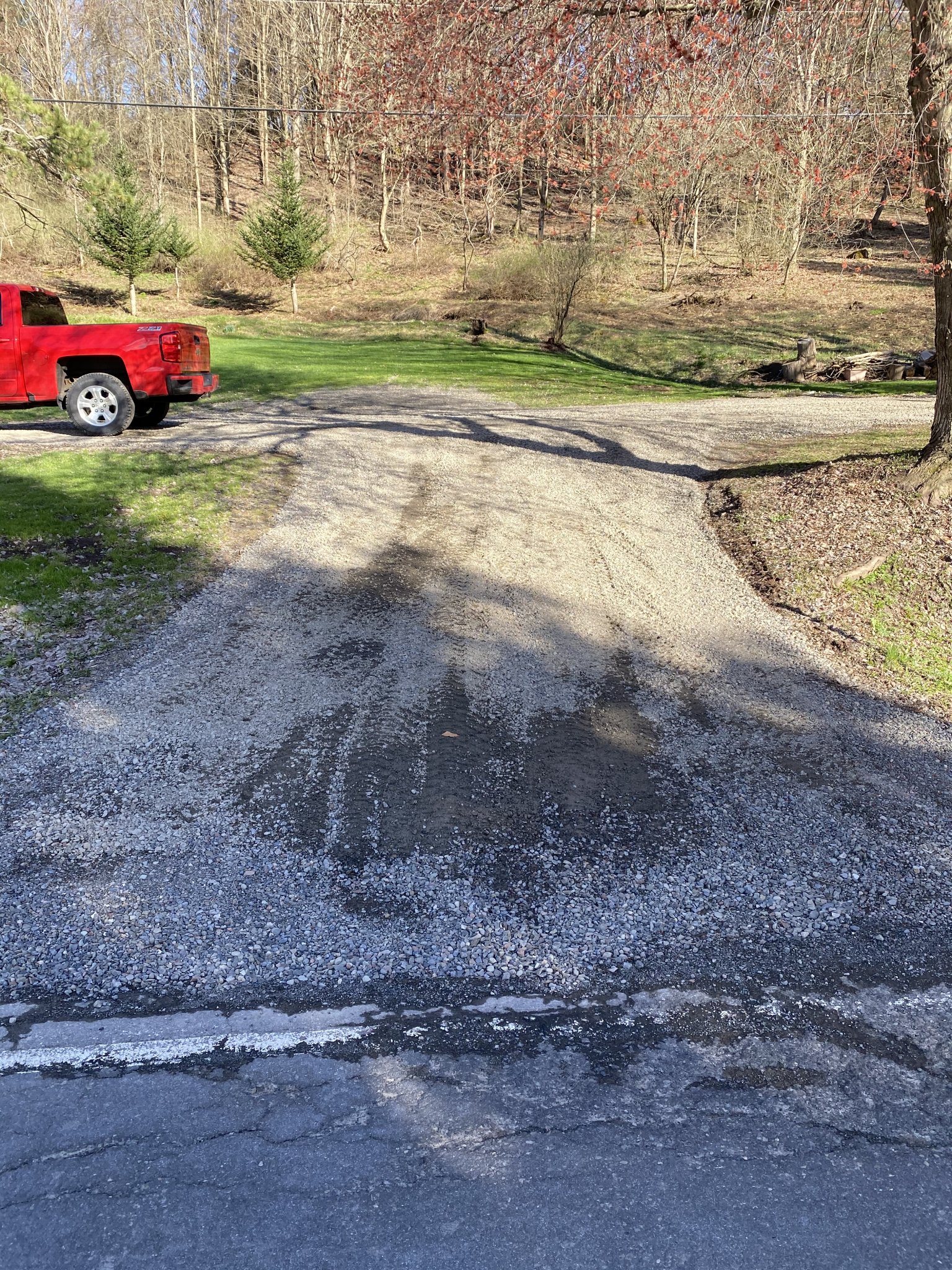

I posted these in the “What did you do” thread. Gave it another couple passes with box blade and a LONG top link after work.
Material is crusher run. Will probably touch it up with the box blade a couple more times, and then may hit it with a plate compactor.
What looks like dirt in the last picture is the stone dust component of the crusher. It really helps bind/pack it all down. I debated on using all stone dust, but we get a lot of water at the bottom of a hill....that always needs to be considered.

My work with crusher run is the first time in 30 years I’ve tried a material like this, with fines.
This job is far from perfect. Not enough crown and I’d like to channel more water away....but still a lot better than years ago.
If you have water sheeting down the steep parts, you need to control that first before going with a finer topping. Otherwise, you get to do it again....
