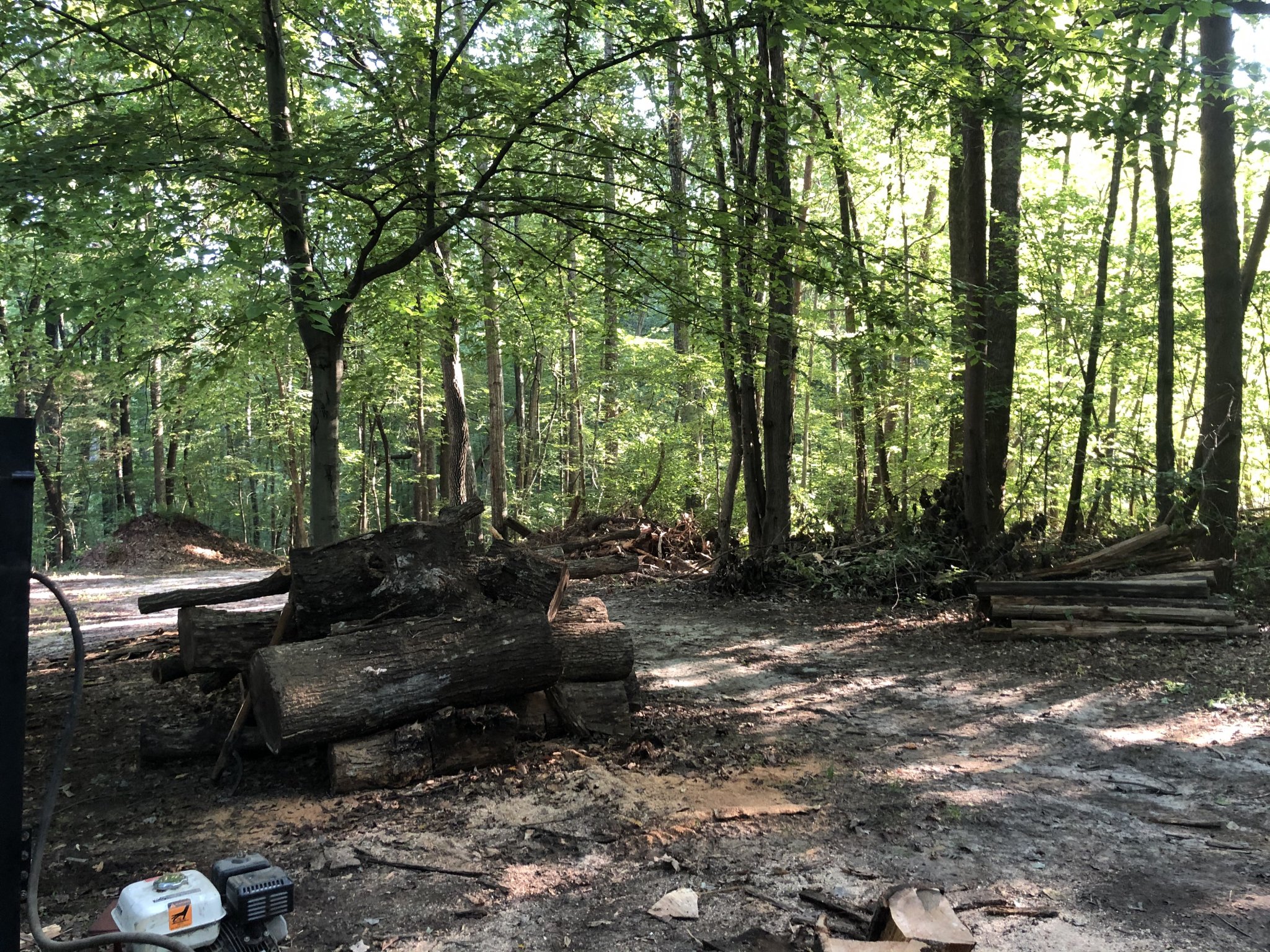

I’ve tried searching, and I’m a complete newb to the tractor world, so please forgive me if I’m asking a dumb question. I just bought a bx23s, and one of the jobs I want to do is fix my gravel driveway. I also want to be able to create a gravel driveway in my upper field and I need to create a gravel shed pad. What would be the best tool for the tractor to be able to achieve this?
my tractor has a FEL, hoe with thumb and 3PH. Thanks in advance.

I live in the mountains of western NC. My driveway is gravel (rocks) and has grass taking over part of it. The driveway I want to add is on a sloped section of my upper field and is currently just grass but my subsoil is basically clay/dirt mixed with A LOT of baseball sized rocks.
