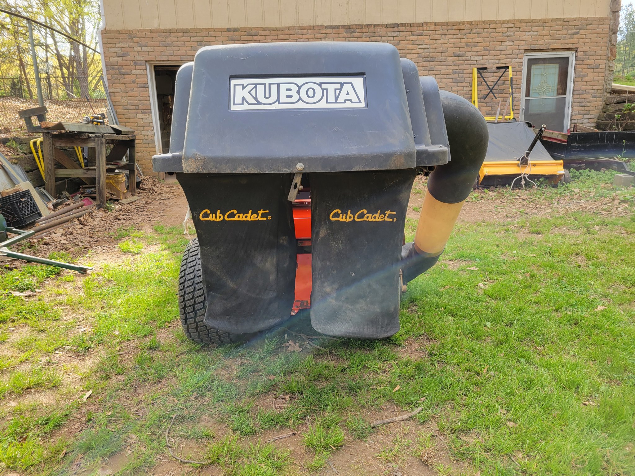

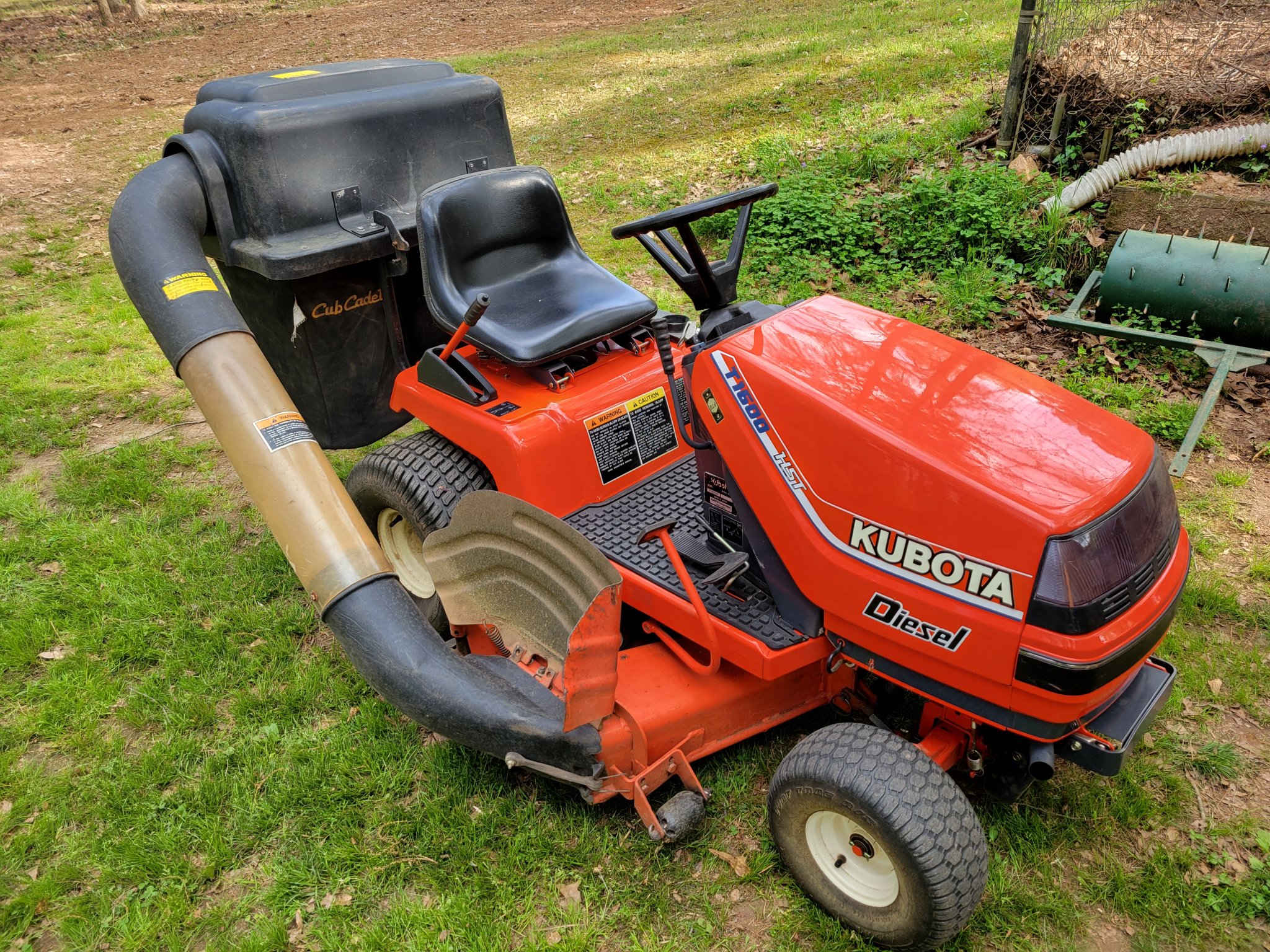

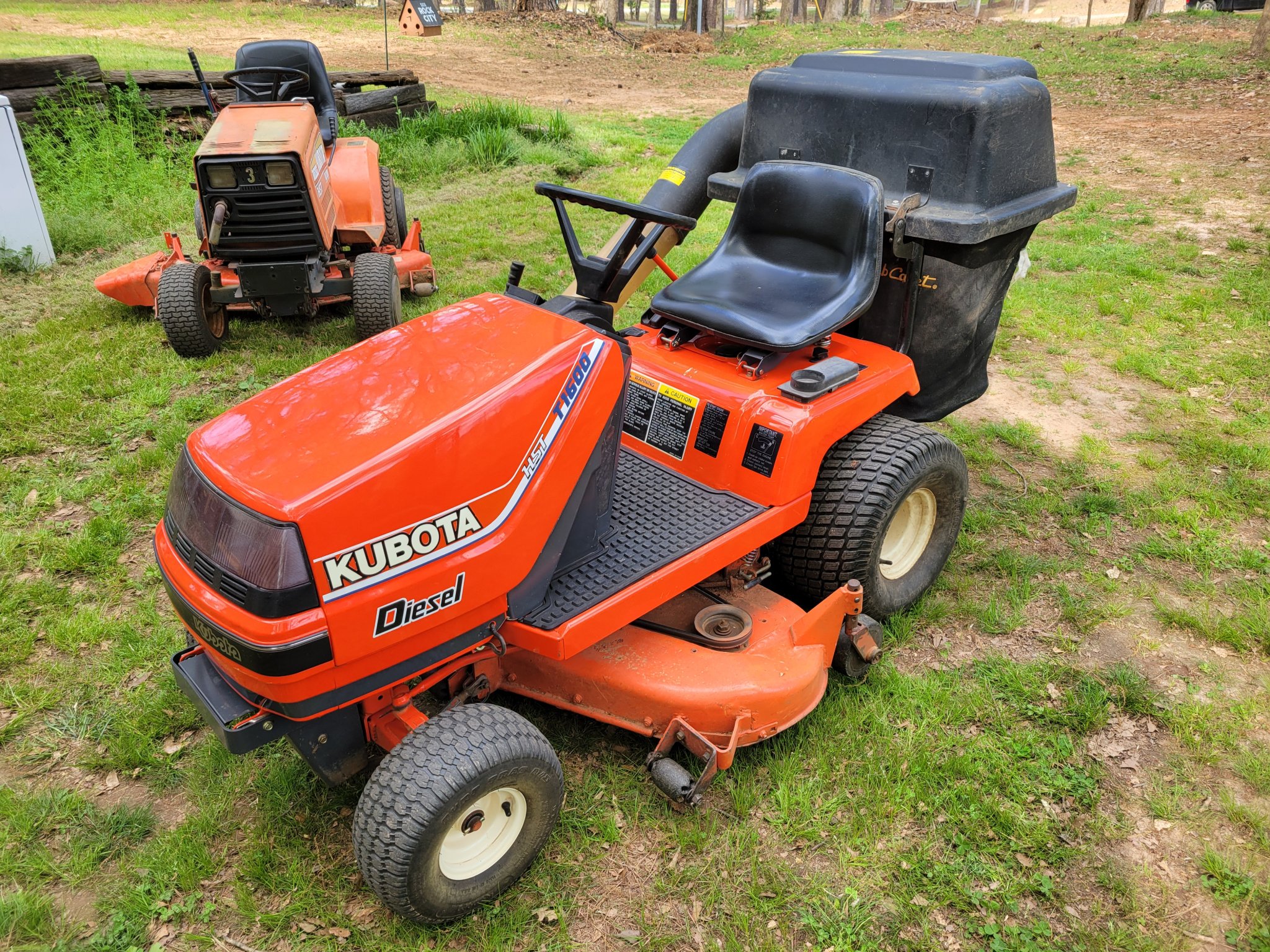

Few more adjustments...
T1600 mower
Modified RC44 deck from a G4200 relocated rear mounts from a junk RC44LT
Modified catcher from a T1400 with Cub Cadet bags (The old bags were toast)
I have to come up with a longer discharge tube and adapt the front clip for a hold on the deck but so far so good. I chose the RC44 deck from the G4200 because of the smaller pulleys for slightly higher blade speed.

These catcher parts were otherwise just setting in the basement about to be tossed out. Figured I'd try something with them. It's dirty like most things but it works.
