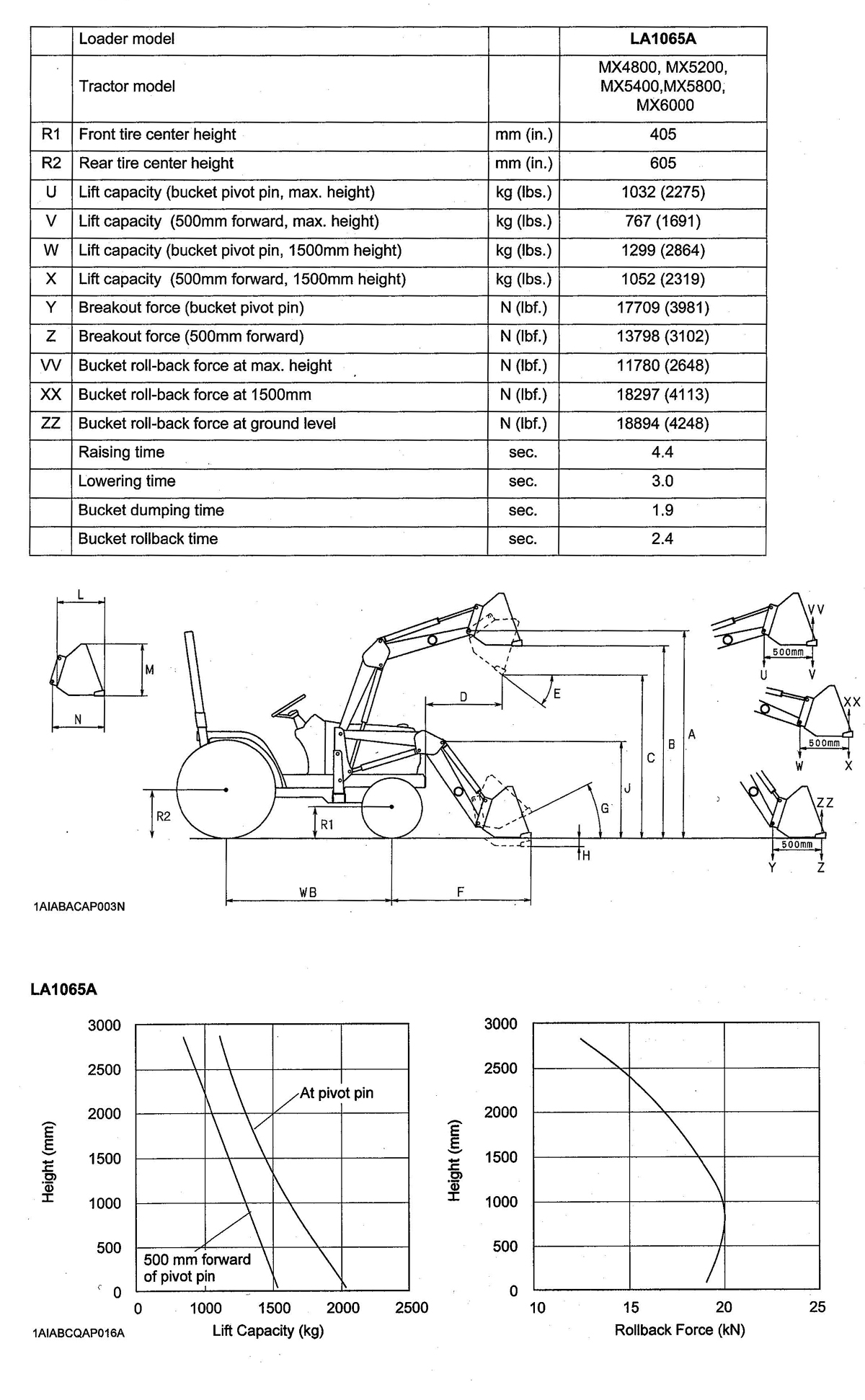

With all due respect, breakout force is NOT lift capacity at ground level. Breakout force is typically measured using BOTH the lift and curl cylinders as well as also leveraging the back edge of the bucket against the ground as a fulcrum.
If that were the case why would Kubota's FEL specs include both breakout force measured at the bucket pin and 500mm forward, as well as roll back force at ground level, 1.5m and maximum height?
For example, the LA1065 on my MX has the following specs:
Breakout force at pivot pin: 4,074 lb
Breakout force 500mm forward: 3,171 lb
Bucket roll back force at ground level: 4,046 lb
And since roll back force is provided at three different heights it's clear that there's no "leveraging the back edge of the bucket" going on. The roll back force at ground level is at the pivot pin so again no leveraging.
For example, the LA1055 on my MX has the following specs:

With all due respect, breakout force is NOT lift capacity at ground level. Breakout force is typically measured using BOTH the lift and curl cylinders as well as also leveraging the back edge of the bucket against the ground as a fulcrum. I agree that with a grapple, breakout force may be interesting in some tasks - like leveraging up stubborn roots. But overall lift capacity is also something that needs to be considered (as OP is doing) because if you put a heavy grapple on the L-series, you're going to subtract that weight from what you can actually lift.
Here's a real-world test and the numbers were pretty close to Kubota's published specs.
I have seen it and its a good explanation of how the lifting numbers differ between the loaders. But it is not a well designed real world test in terms of the 2000# lifting capacity I threw out:
  1. The measurements are nowhere close to ground level height
  2. The test rig is not measuring at the pins but well forward of them.
  3. It neglects the weight of the bucket.
Here is a better conceived and executed test of actual lifting capacity.

My point was that rollback force (curl) and breakout force are different and not the same as stated by @nota4re. Here's the spec sheet for the LA1065. Z and ZZ are different forces.
