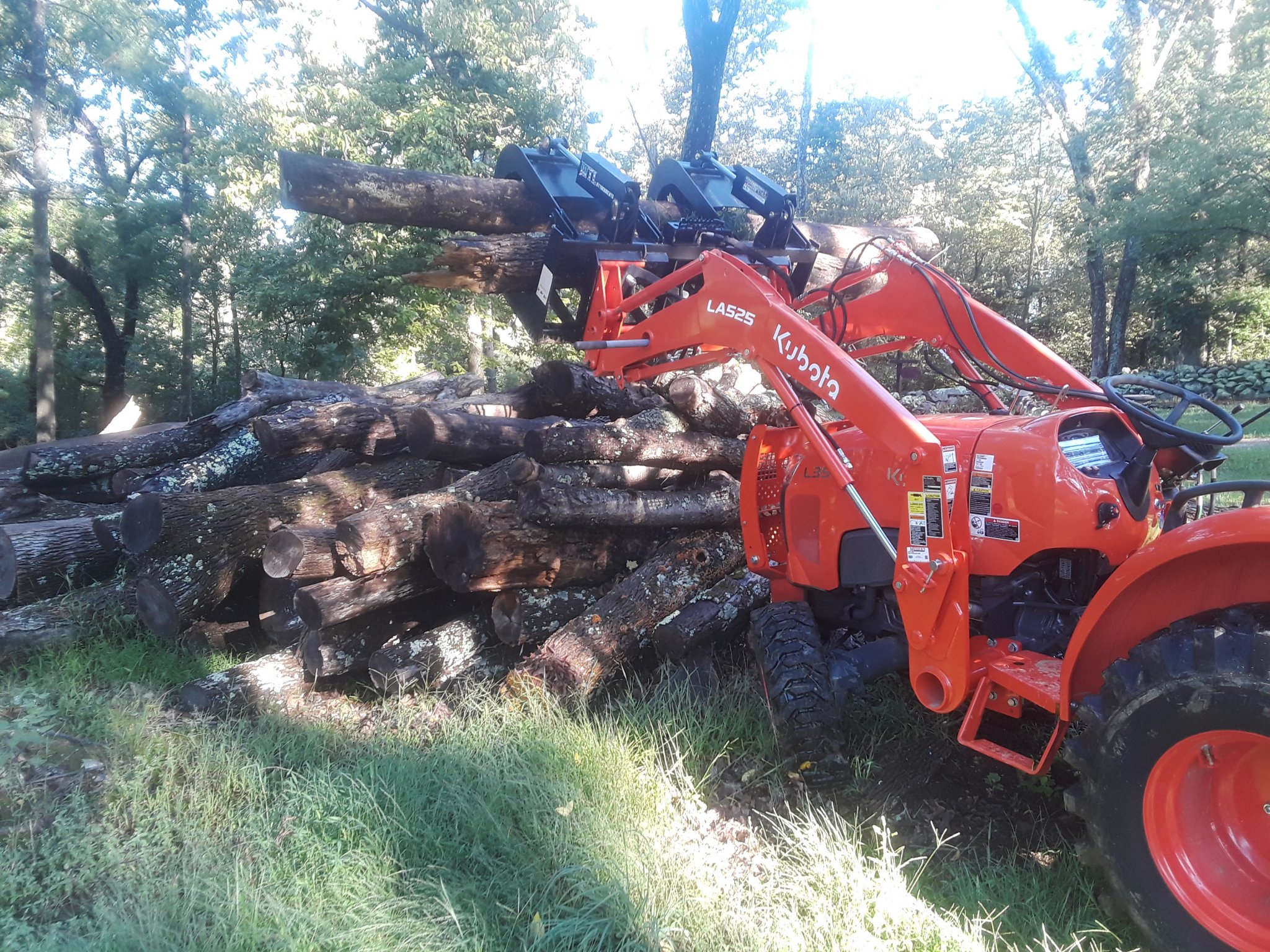

According to the lift/load curve. The absolute max is around 1400-1500 (at or just above ground level). The heaviest grapple I would think of getting would be no more than 350lbs but I don’t expect to ever lift more than a few hundred pounds at a time with the grapple

So I have an L2501 and the LP0660. Works great. I would suggest though you don’t go the cheapest one. These tractors can tear up a grapple. Watch GP outdoors and he bent his with an LX2610. Personally I would either go with the LP as you can do 2 years with 0% interest if cost is a factor. I like mine. Or with the EA Wicked grapple. The latter though requires all the money upfront and from what I understand is 4-6+ months for delivery. Now don’t get us all started on that thread again lol.

LA525 is lifting about 1000 lbs max height..so it needs to be a nice light one. EA does a great job of balancing weight with stability. However they require up front paid in full and are at 4 months lead time (I do believe they will refund in full if you cancel a certain amount of time before shipping). I would see what they recommend then find other manufacturers to compare (weight, materials, features). If you dont find anything equivalent and can wait for EA…then do so.
You get what you pay for. Be very careful, some companies are USA based but import in bulk from China. It is often hard to find replacement parts down the road in these scenarios. To cut costs the US company orders 500 grapples in bulk from China….and these may never be produced exactly the same again (Hence the parts issue). Just research to know what you are buying.

The max lift on the LA525 is pins at ground level and is roughly 2000+ lbs.
The reason I ask is because I just purchased a 60" RG-7 from MTL and it clocks in at 525#. It will lift quite a bit to full height - more than I would feel comfortable with on anything other than a level paved or concrete surface. Without a lighter grapple to actually compare I am not sure how much difference that 175 pounds actually makes for anything other than dead weight lifting of large logs. or rocks. The one thing I do think you should consider is the length of the lower tines. The tines and lids on the RG-7 are quite long and that makes the grapple noticeably front heavy. It also gives it a big bite which is PRO to go against the CONs. Even with all of that weight and balance issues it works just fine for moving large piles of brush and tree tops . It also transports and stacks pretty substantial logs with no issues.
To sum that up payload lifting capacity is not nearly as big an issue as is the the stability of an L01 with a max load on the front. I have in excess of 1000# of ballast on my L3901 and it really needs another 500# to 1000# and wheels widened with heavy loads on the loader. As is I can easily lift a rear wheel on uneven ground picking up considerably less than max lift capacity.

Not sure where that number is coming from. Kubota specs the max lift weight (at the pins) at 1131lbs. That is consistent with what I observed on my L2501 and there's also a couple of youtube video tests that got almost the same number. It won't come close to 2000lbs (or I likely wouldn't have traded it in.)

Per the owners manual lift capacity at ground level (aka breakout force) is 10951kg/2462 pounds. Also notice the capacity of the exact same loader on the L3301 is less although both are producing the exact same hydraulic pressure. Odd isn't it? Let me suggest those numbers are exactly what the table in the manual says - "operational specifications" - not actual physical lifting limits. I have a crane scale good to 2200 lbs - would you like for me to actually pull up a max load and measure it?

With all due respect, breakout force is NOT lift capacity at ground level. Breakout force is typically measured using BOTH the lift and curl cylinders as well as also leveraging the back edge of the bucket against the ground as a fulcrum. I agree that with a grapple, breakout force may be interesting in some tasks - like leveraging up stubborn roots. But overall lift capacity is also something that needs to be considered (as OP is doing) because if you put a heavy grapple on the L-series, you're going to subtract that weight from what you can actually lift.
Here's a real-world test and the numbers were pretty close to Kubota's published specs.
