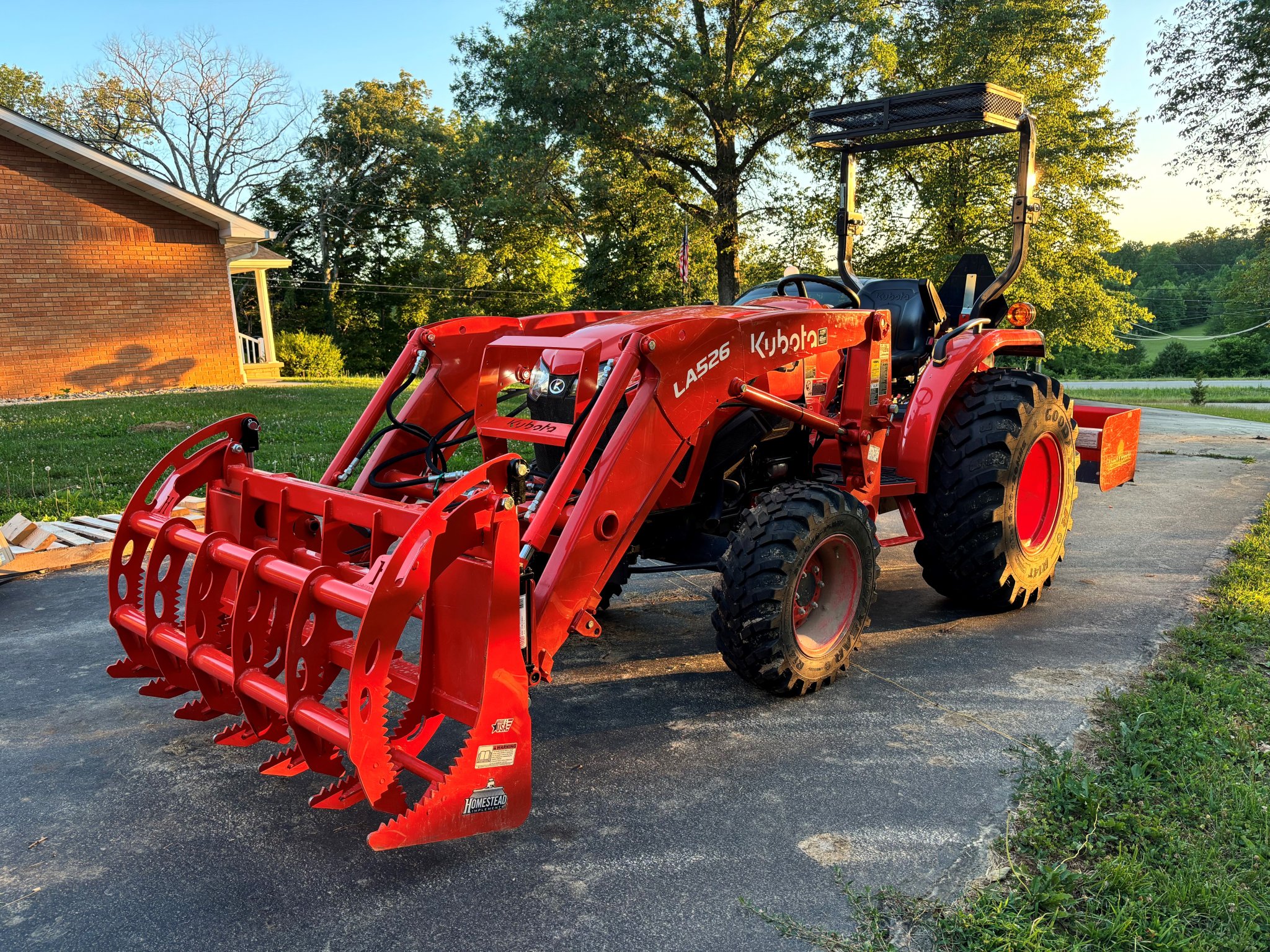

I'm just concerned about the high risk for potential damage to the loader from what @North Idaho Wolfman mentioned. The root rake seems to be "safer" in some cases. But I would simply just be moving brush, logs or stumps.
You can really twist up your loader with either one if you are pushing through the brush and nail an Oak stump. I'm fairly conservative when pushing into the unknown. Some guys and gals just send it. That's where potential problems lie.
100 grapple hours on my machine and haven't broken it yet. Thankfully. Mostly carving out ATV trails and cleaning up fallen trees. I do saw most trees into smaller pieces. That probably helps.

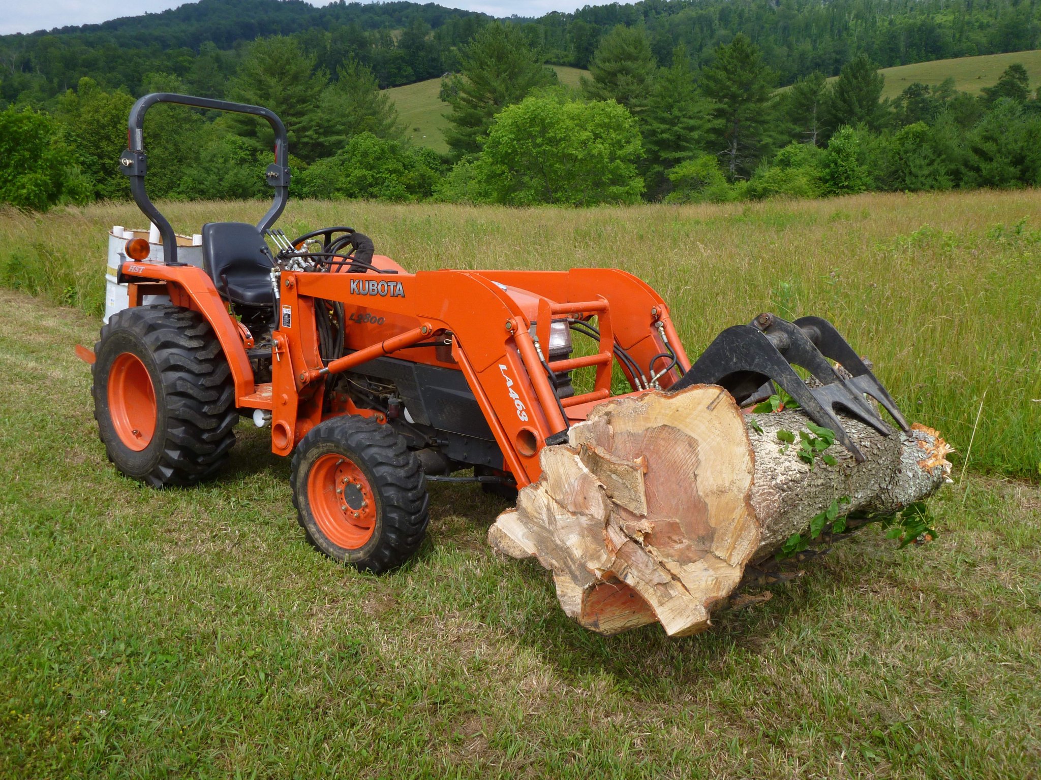

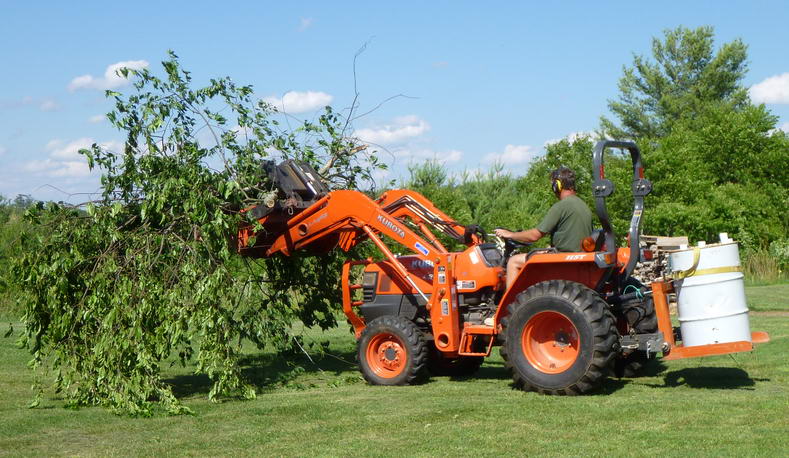

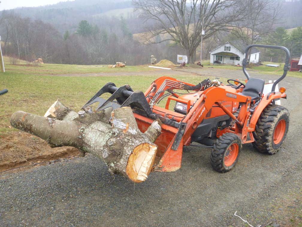

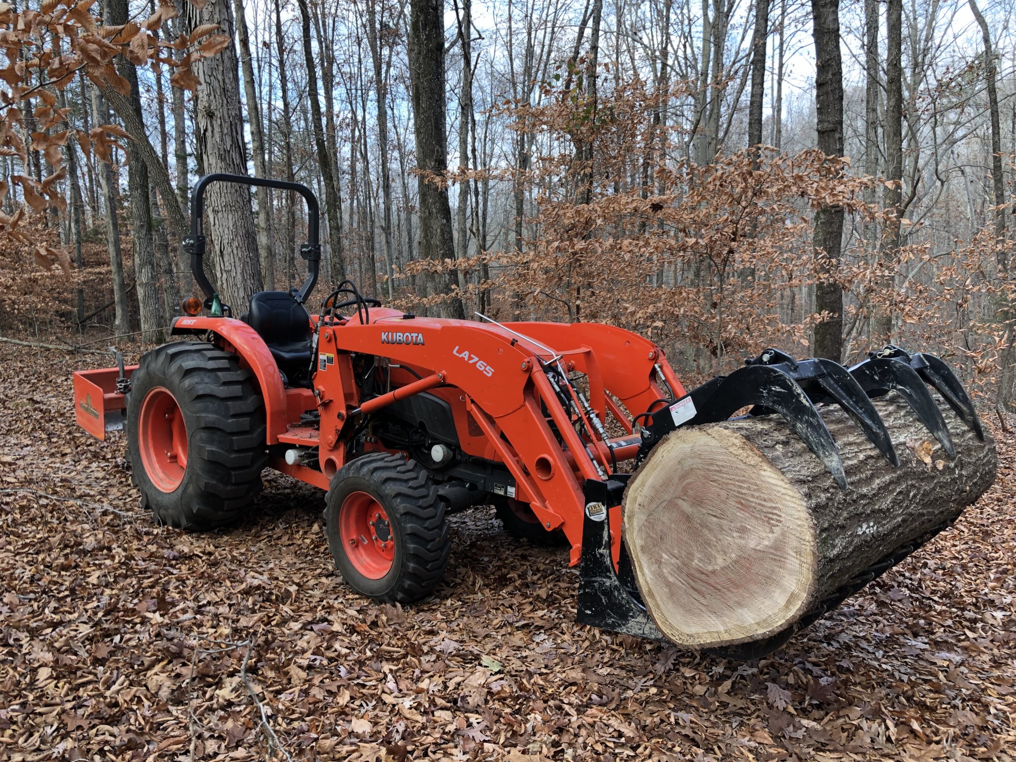

I have this 60 inch root grapple from HLA
It works fine and I have been very happy with it. It weighs a svelt 405 pounds and has performed very well. The 55 inch is 380 lbs.
I am "on the fence" about whether or not, I would pick a "dual lid" design if I had it to do over again.
On one hand I can see the value of independent lids, but then again;
The one pictured above is wonderful at "back dragging" to rake/clean up messy areas. It has saved me tons of back breaking work.
I have bent a couple of "tines", by grabbing rocks too aggressively, (but I can break anything if given the opportunity).
A few smacks with the BFH, and they are good as new.
EDIT: My vote is for the one in the second picture.

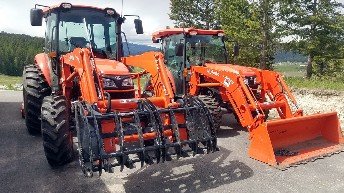

I’m partial to the root rake style myself. Had an EA 55 on the LX2610, and got an EA 60 for the 6000.
Another EA Wicked 60 fan here, but more specifically the root rake grapple variant. Kind of wish I'd bought the Wicked 66 but only had the MX when I placed the order. I need a really tough grapple since I move rocks around fairly often, lift equipment off trailers and such, in addition to moving logs and brush. Root rake grapples tend to be tougher than their counterparts since they typically have shorter tines and often thicker tines with additional gussets.
