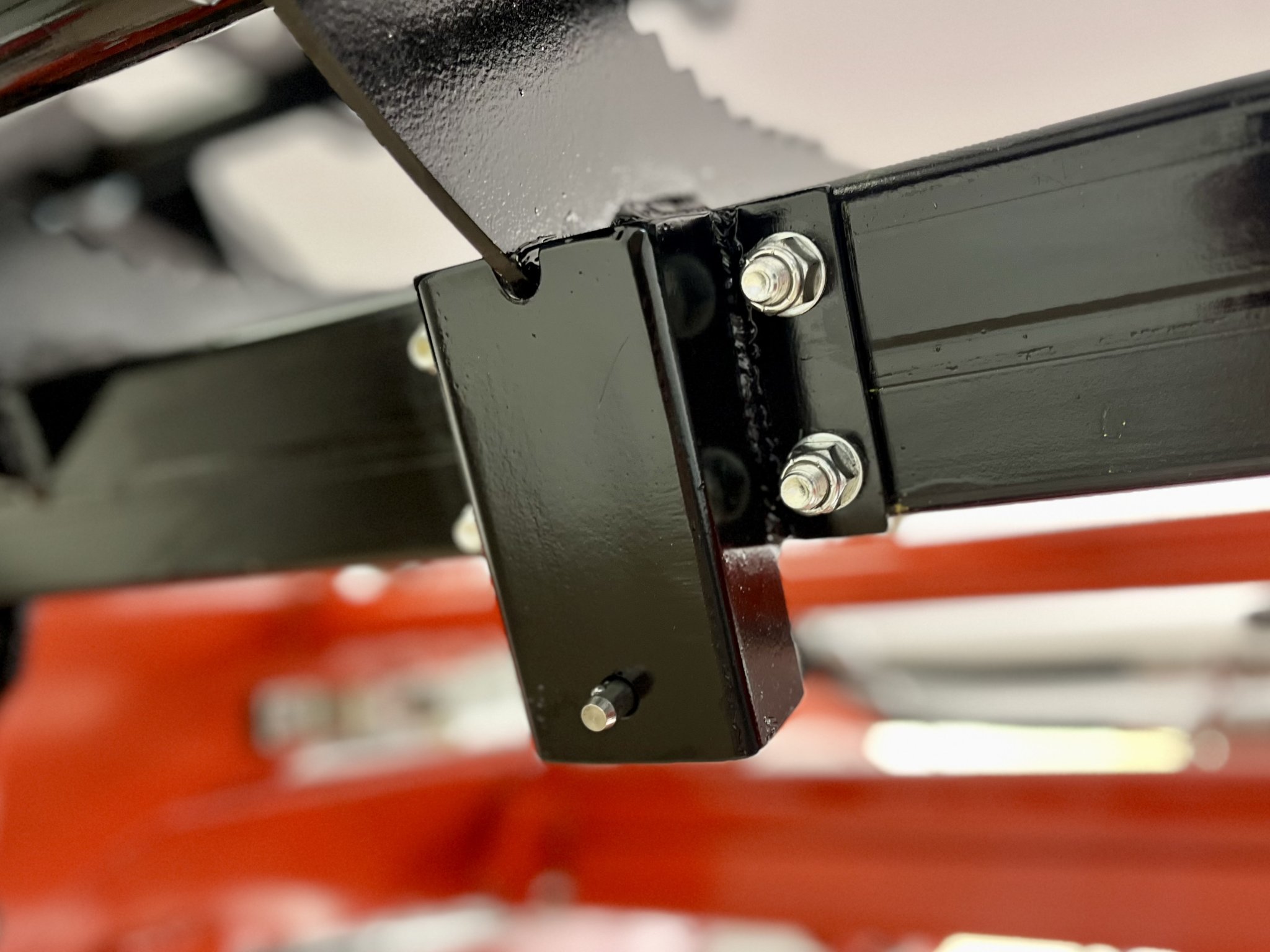

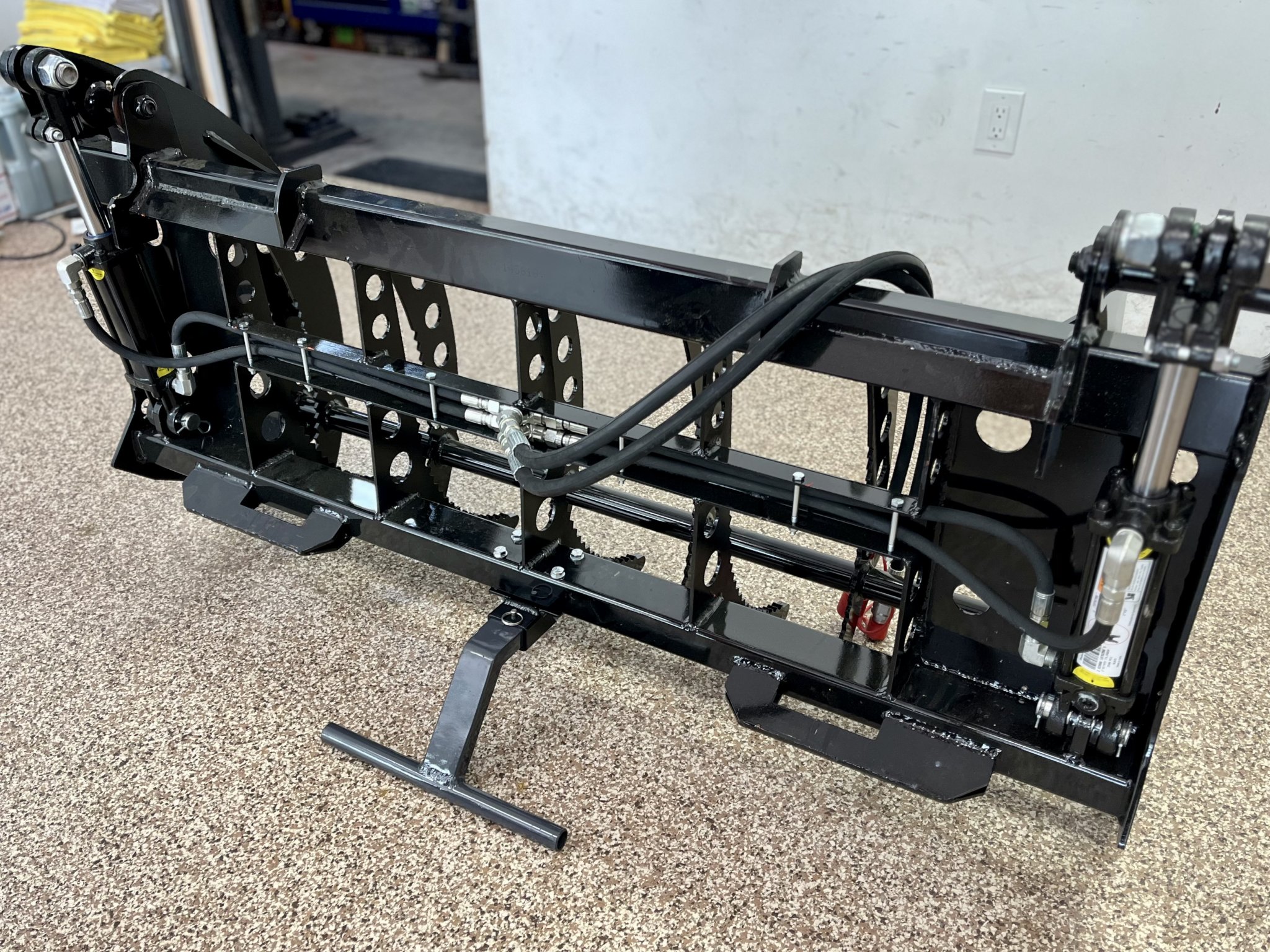

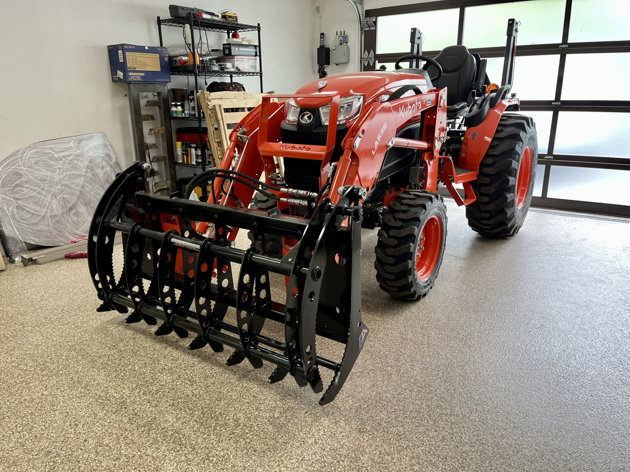

I recently ordered an EA Wicked Light 55" grapple for my LX2620. The ordering process was painless, any questions I had were answered over the phone, and the grapple shipped in under 4 weeks. I think I initially paid a 10% deposit to get in the build queue. Absolutely zero complaints with the process or the product.

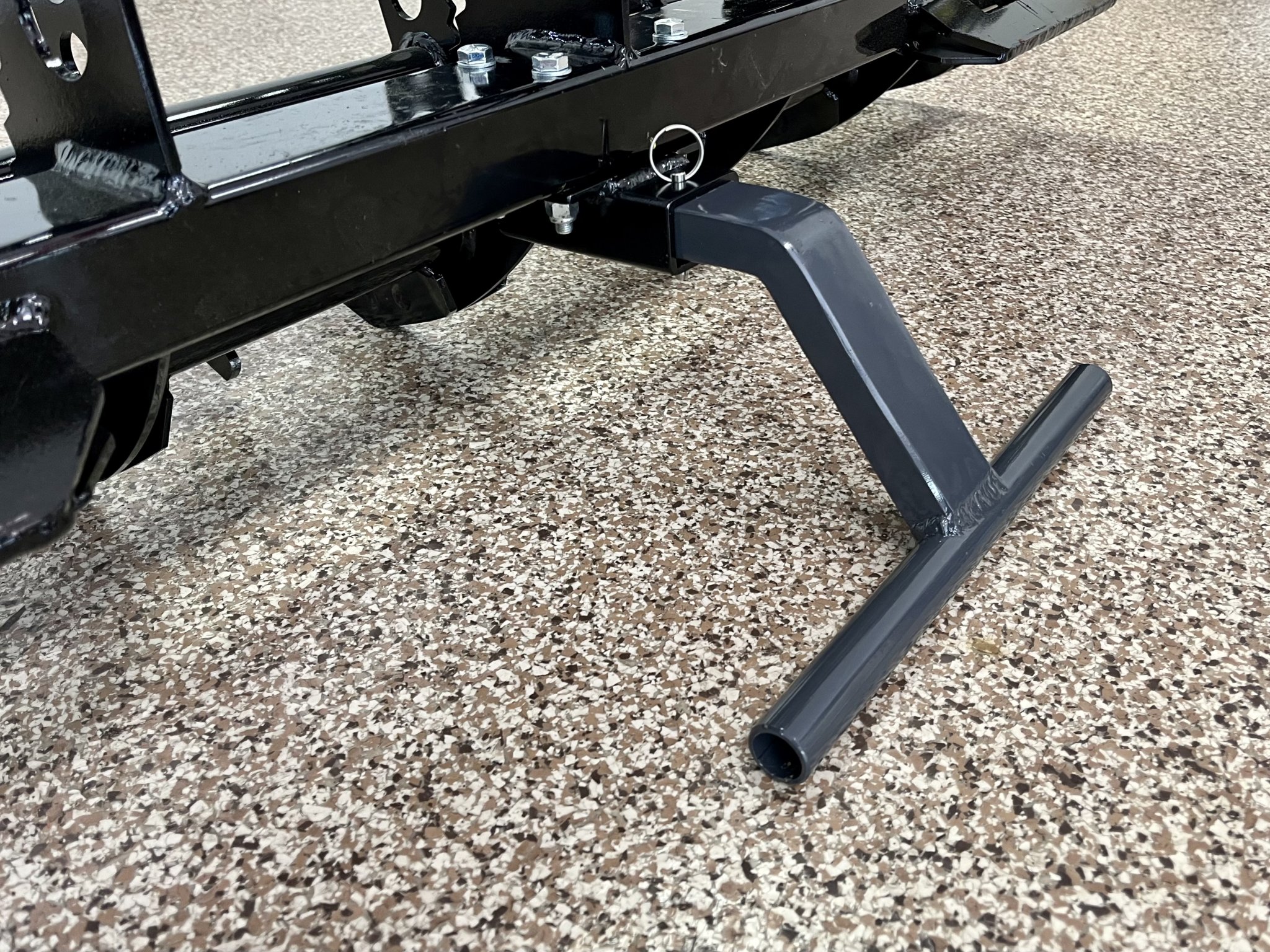

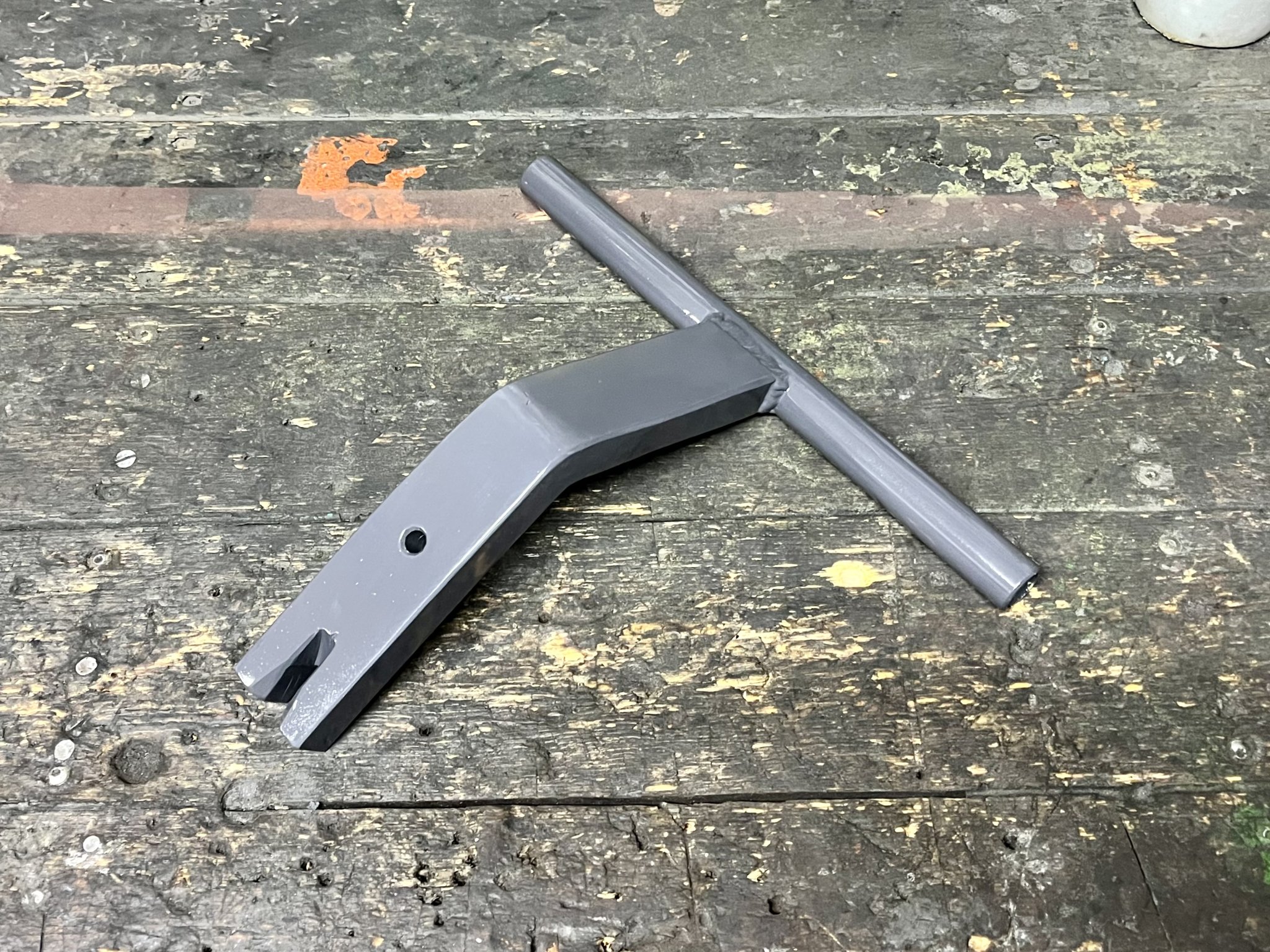

For compact storage, I fabricated a kickstand for it.
