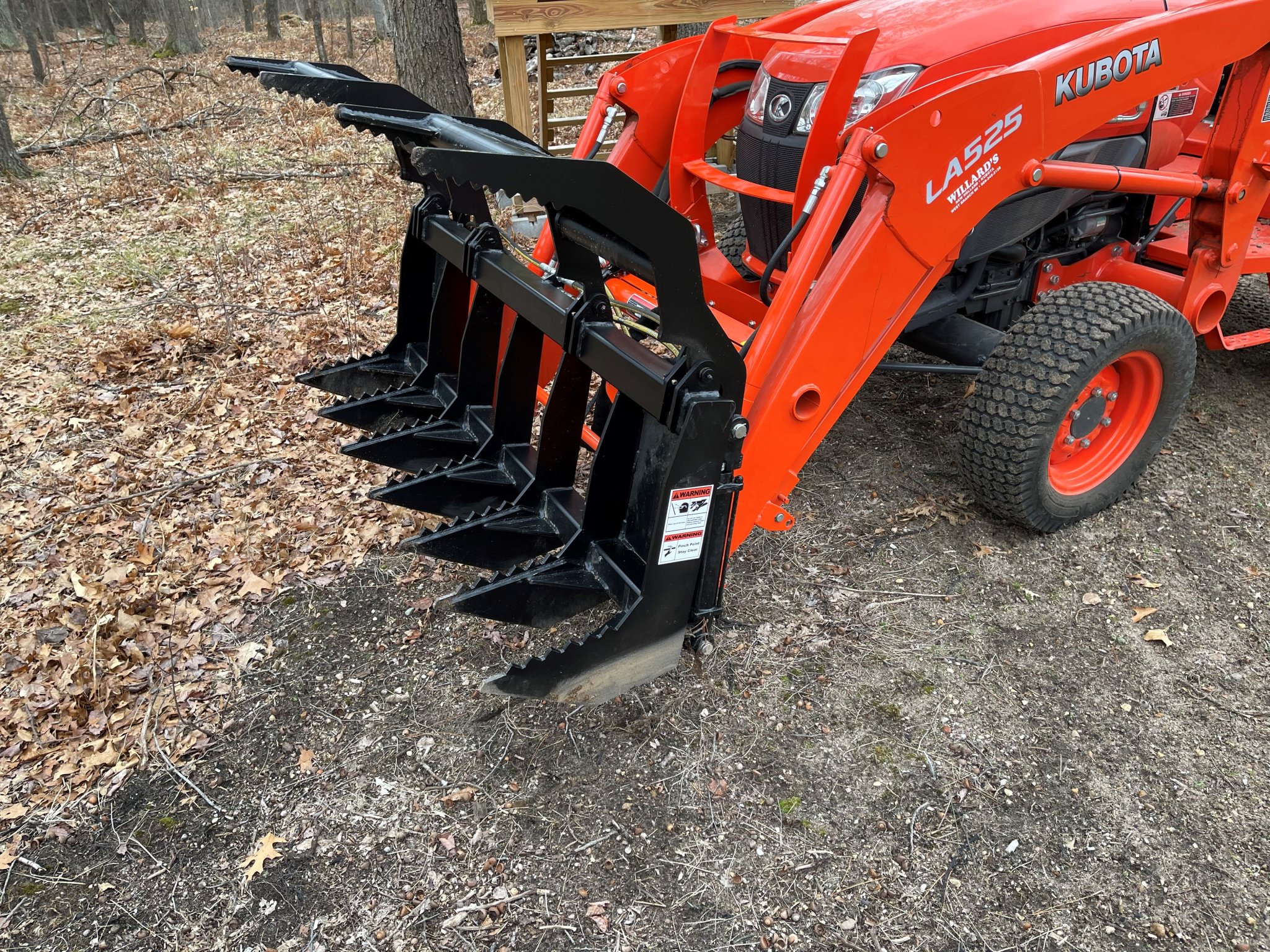

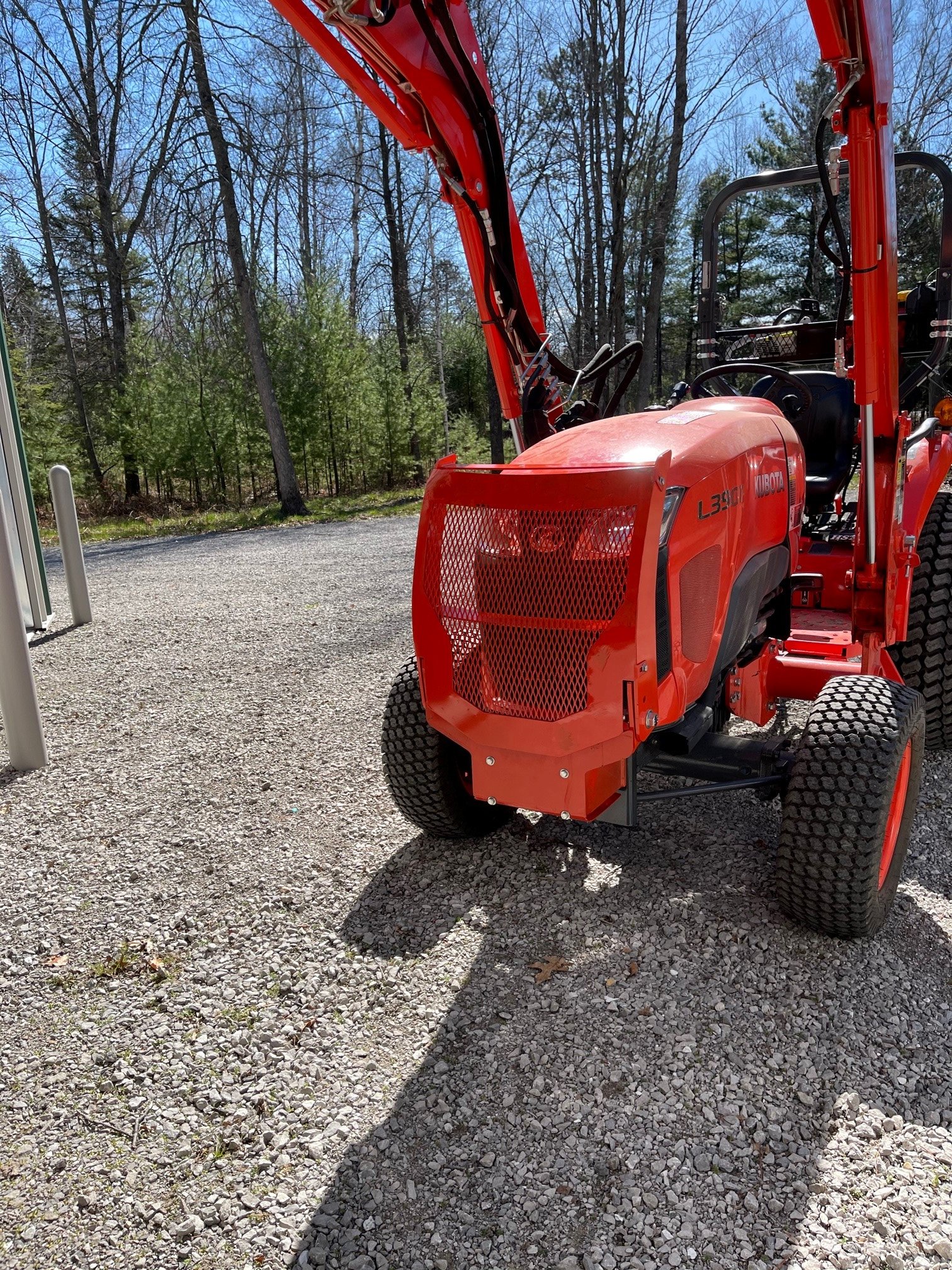

I'm with Bmyers on the grill guard comment. I purchased a small grapple for my L3901 and quickly realized that I need front protection when using the grapple. Here is my L series with a Lown Performance grill guard and the lower guard which they call a chin strap. I don't have a lower guard on my MX and have done some light front damage as branches have stuck up behind the grill guard.
Depends what you are using your grapple for, I do a lot of woodland work on fallen trees and branches. As you can see the tractor was quite exposed without a grill guard. Strongly recommend a lower guard if you can get one for your LX.

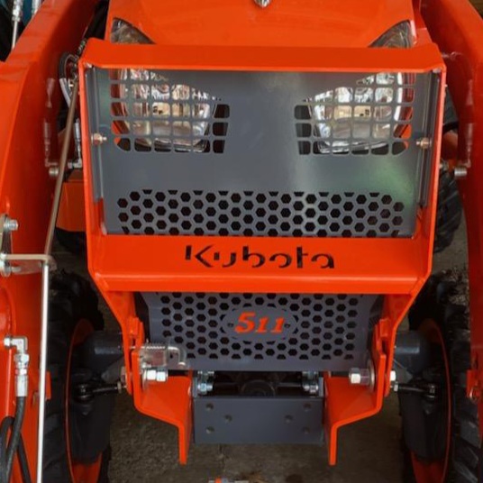

I've already considered a grille guard, looked at LP as well as another company here in Michigan. On the LX, the grille must be moved forward to open the hood and with a grille guard on, one must reach over the loader arm then try to get your hand down the back side of the grille to the lever, seems like it could be a pain. LP and the other companies don't make any provisions for this (as far as I've seen on any images.)
Howdy neighbor! Our guard is mounted differently than others. The release latch is accessible from the front, making folding the guard a breeze. Here is a link to our site. All of our product prices include shipping and we keep most everything in stock so there is no delay in protecting your investment.
5elevendesignz.com
