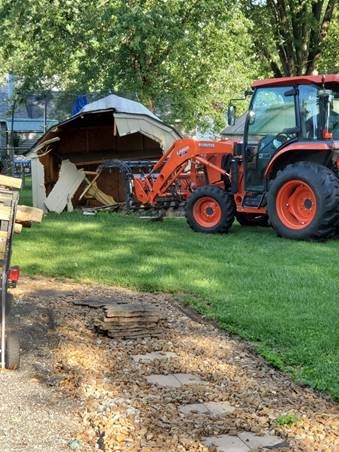

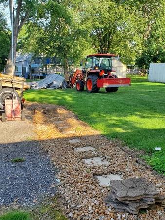

I have moved chunks if concrete with my 55" Wicked Grapple, barrels, old implements, lots of brush, logs, and bricks. It has worked well and wondered how I ever got along without it. Plus, I have taken down a few buildings.

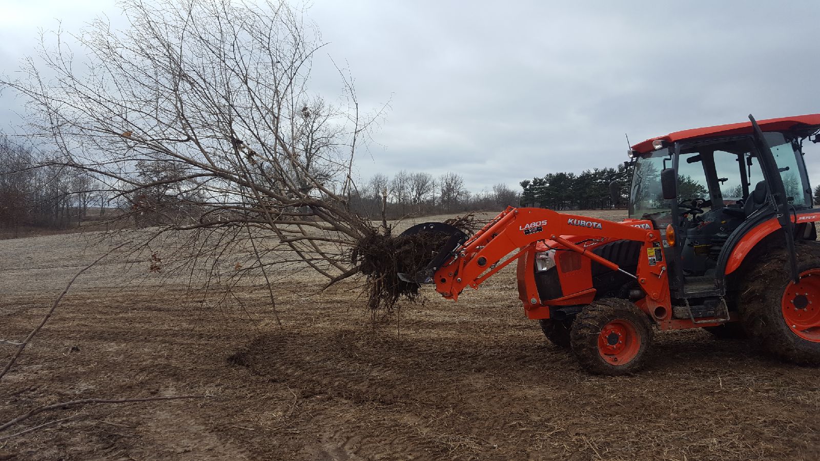

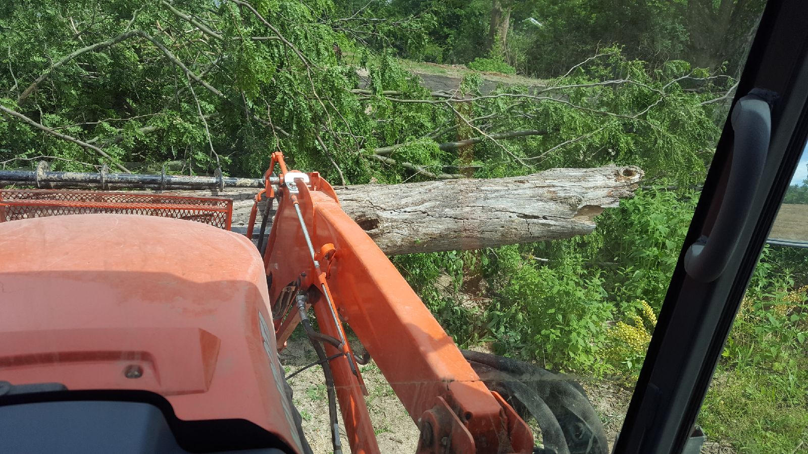

Jim, I believe the EA 55” is perfect for our tractors. You will find after using it a bit, open fully and compress the brush pile, close and roll while lifting a bit. They will handle a big bite. It will pop small trees right out of the ground as well as handle the bigger stuff. Small learning curve, but not terrible. And I don’t believe you can break it, at least not with this size tractor.
You will love it.
Those are the chunks that came off the stump. That is a 24” bar on the saw.

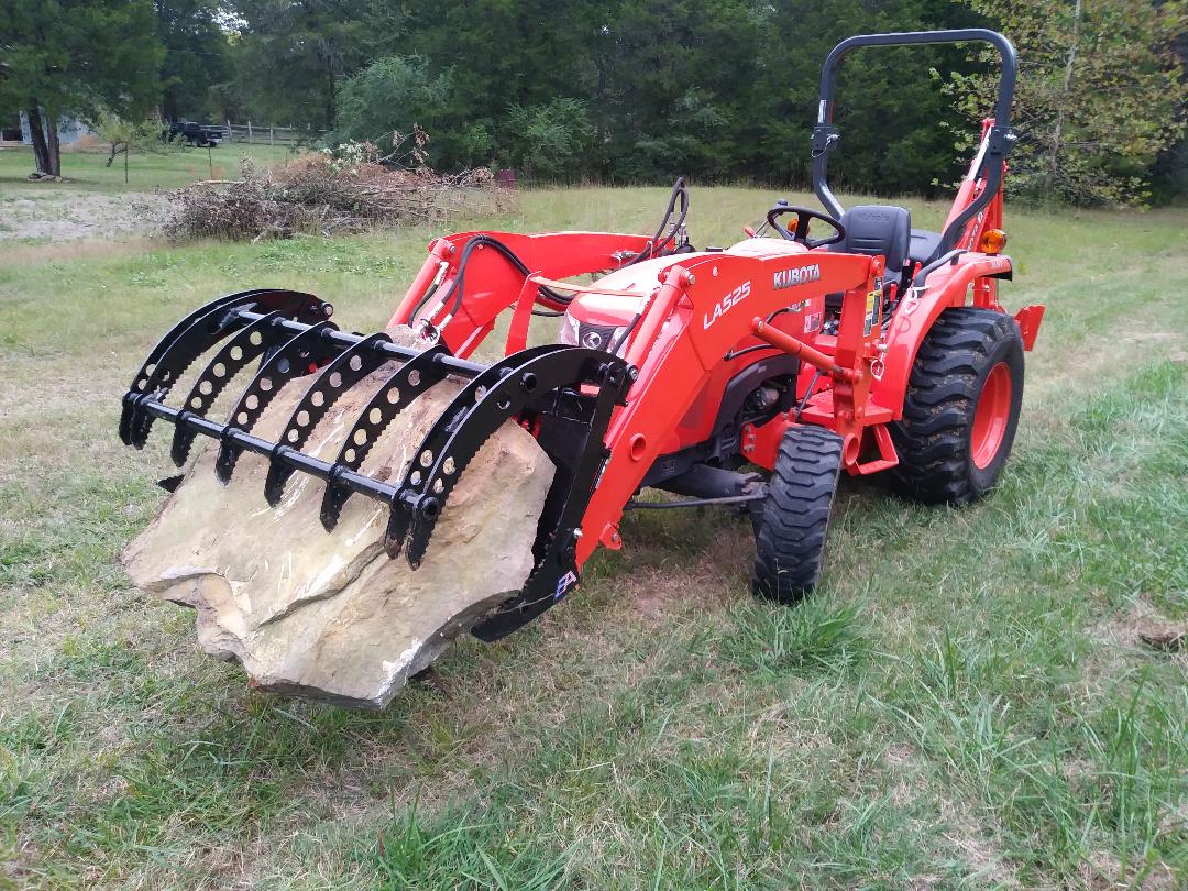

I think you'll be happy with it. I consider the "root rake" capabilities as an extra feature anyway. This is the biggest rock I have picked up with it so far.

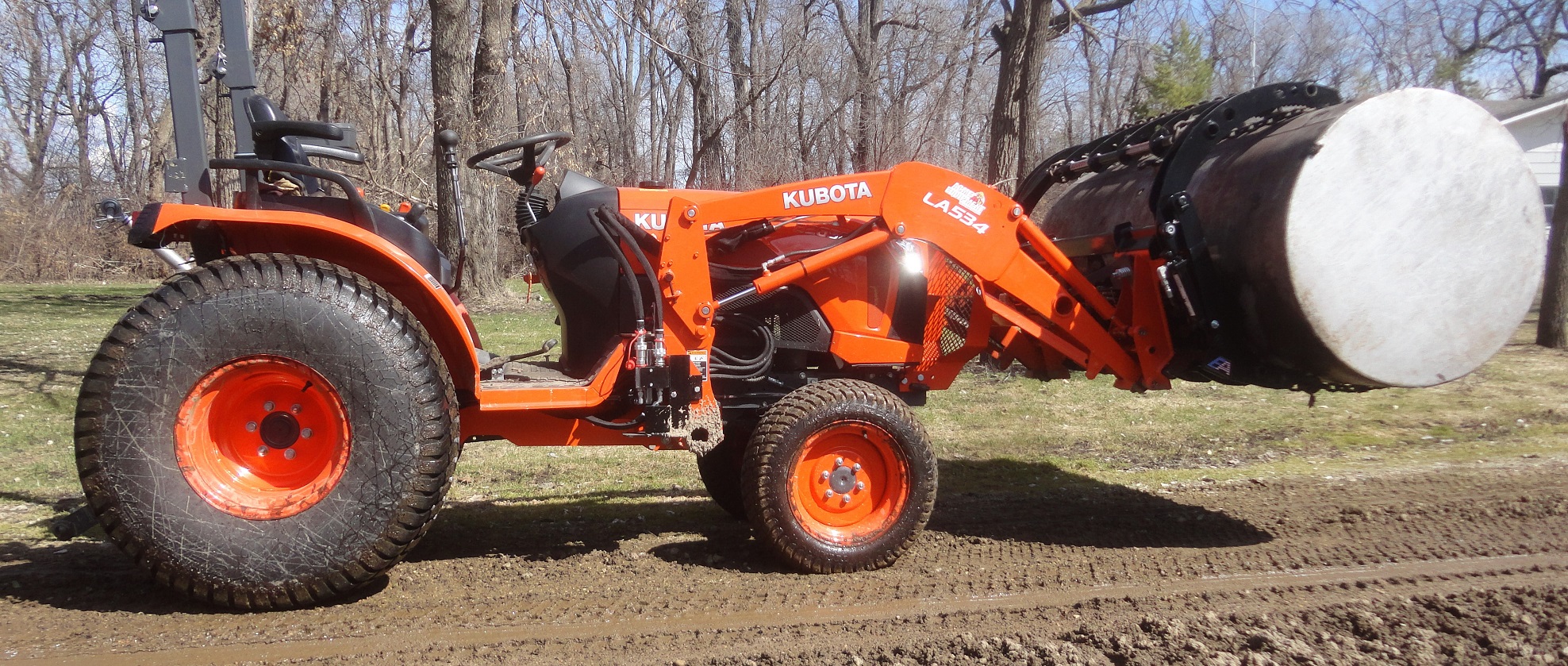

55" Grapple maximum bite! :LOL:
My 300 gallon fuel tank going in for a tune up and repaint.

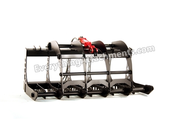

Good points ... I looked at the MTL CV 60 but was scared off by the 400# weight. I’ve actually been looking at the EA Compact 50” Root Grapple as the alternative (275/255#, one larger clamshell lid and removable lower tines, pics below). A bit concerned not rugged enough with 1/4“ plate and the issues you’ve brought up. Thinking the lift issue is mitigated by both the FEL Breakout force and rolling back the load toward the pin to maximize.
MTL are very approximate with weights on their website. My CV 60 had an equipment plate attached by the manufacturer that gives serial number, model etc. and states weight at 360 lbs, I believe this to be correct.
I'm not an expert on FEL but I never consider the break out forces. I consider the lift to 1.5M figures both at the pin and at 500mm from the pin, I believe these numbers represent the closest to real life use. For the L series (L 2501 / L3301 & L3901) they have the LA 525 FEL, that has the following stats:
Lift to 1.5M at the pin 1,490 lbs
Lift to 1.5M at 500mm 1,182 lbs
A lot of the load is going to be carried between the pin and the 500MM point, so I average the 2 numbers = 1,336 lbs and make an assumption that a grapple should be no heavier the about 1/3 of the loader capability = 450 lbs.
This is just my way of looking at things. It has worked out real good for me for the grapples and other FEL attachments that I have. Not sure how that would work out for your tractor FEL. When I purchased my first grapple I was shocked at how big it was physically, I paid a lot of attention to the drawings, dimensions and sizes when I just ordered my current model.
Good luck with your seletion and decision making. EA is great stuff and they make them light weight but that comes at an expense. MTL Attachments are more run of the mill but at the end of the day we are talking about 2 hinged steel frames.
