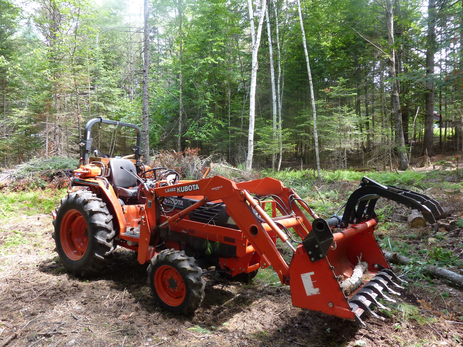

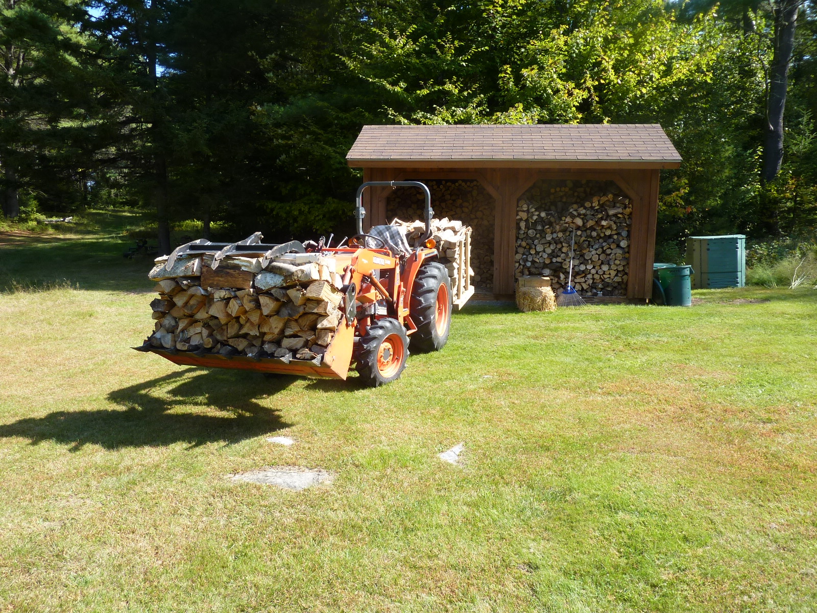

BC2 for what it's worth I have had a bucket grapple on my 30 hp L3010 for over 20 years and could not be happier for all the reasons you said - light, functional, and always have both the bucket and grapple with me. Also have a tooth bar which made a big difference when I added it.

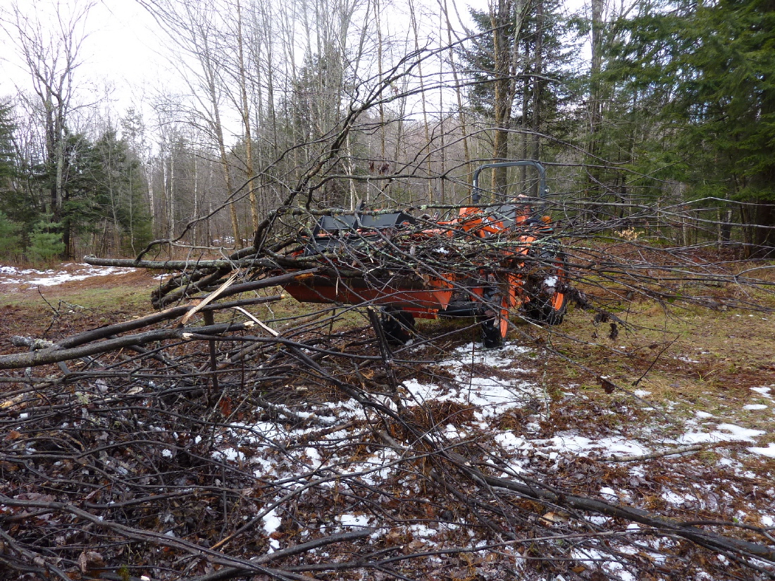

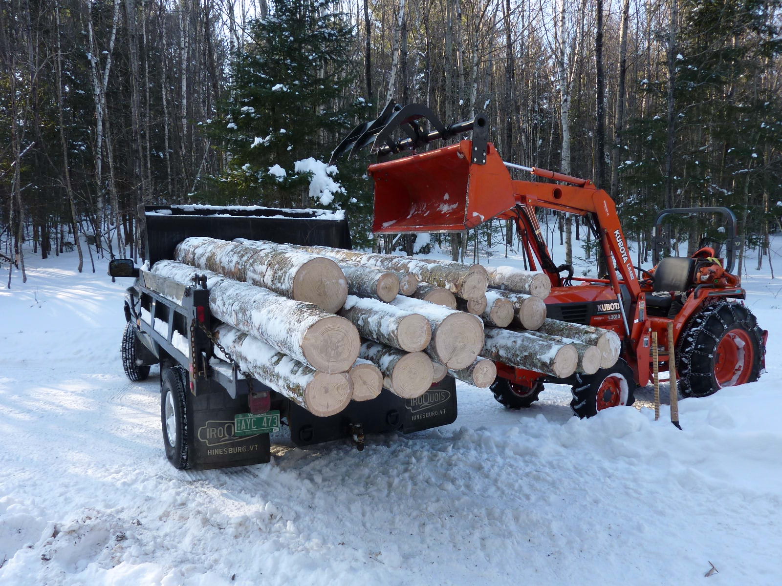

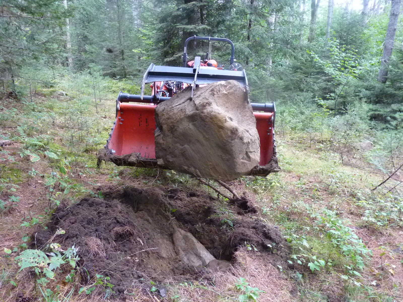

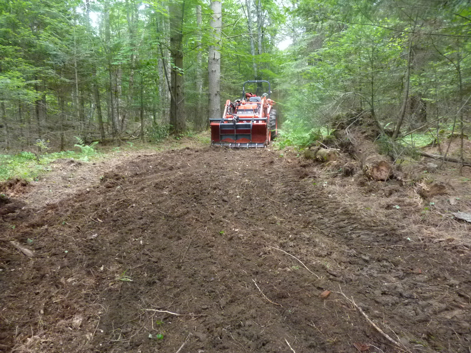

I spend a lot of time in the woods loading logs and maintaining tractor roads. Have 20 yrs of pics - here are some.
I have to say that it is not as good as a dedicated grapple for holding big loads of brush because of the bucket sides stealing some of the volume but it has no trouble getting the job done. There is still plenty of bite.

Awesome, thanks. You make it look like you could actually almost run a logging company with that setup!

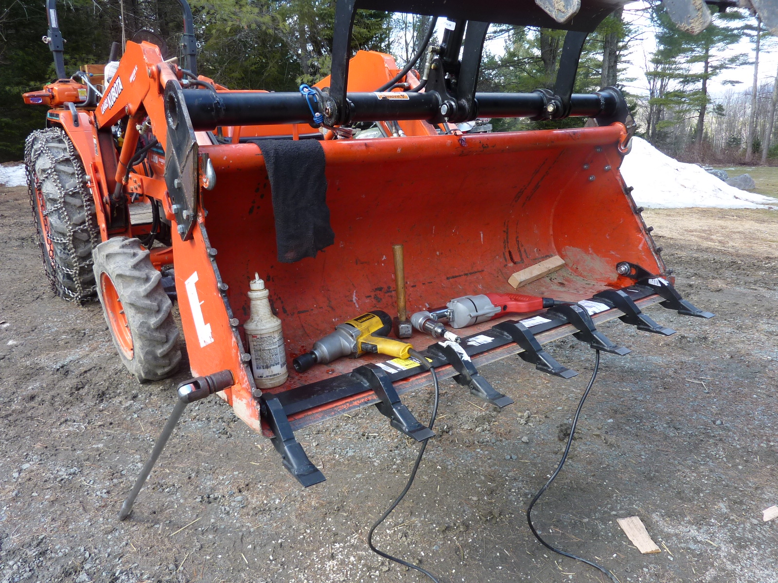

I noticed on the vertical edges of your bucket (i.e. NOT the horizontal tooth bar) it looks like you might have welded some little points or something on there presumably to help grip stuff that is longer than the bucket is wide. Are those little "teeth" something you bought off the shelf, or did you make them and then weld them on?
For digging purposes, do you think the tooth bar design you are using is better than the Piranha or EA type that have the continuous bar with V shapes cut out in it instead of having individual cutting tooth holders like yours?

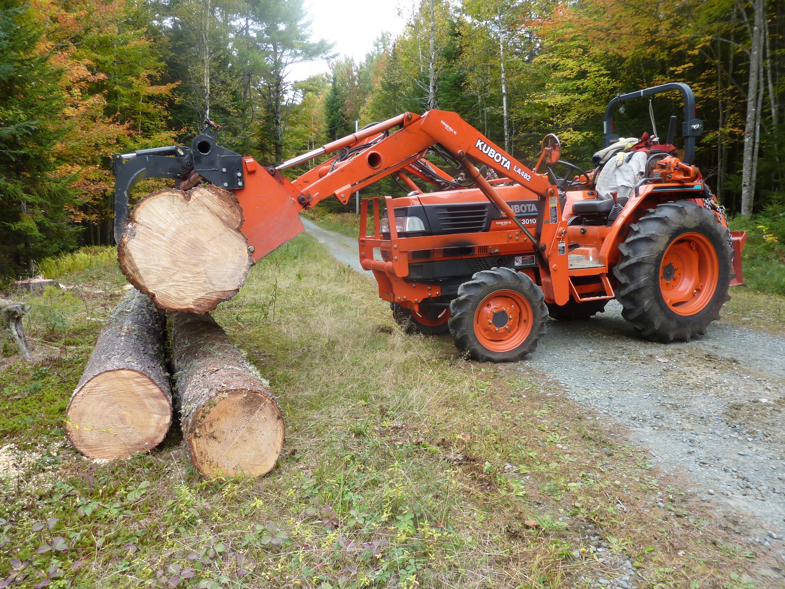

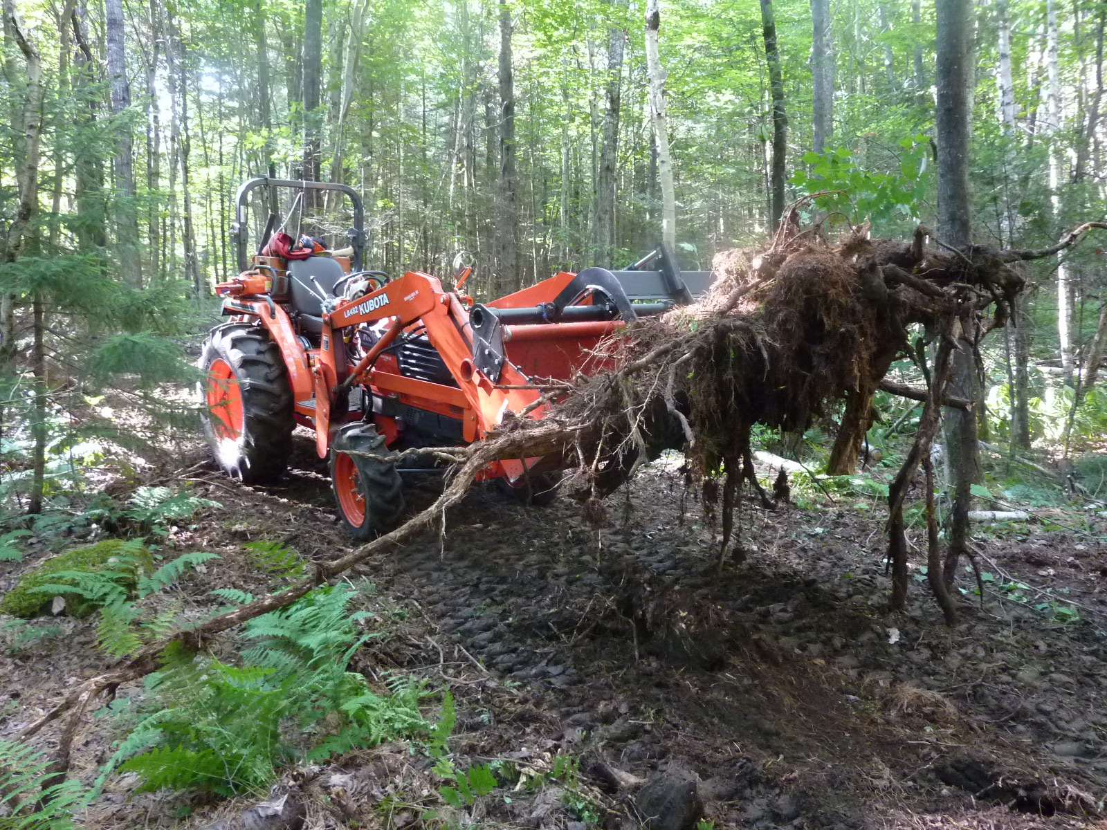

Before I got the tooth bar when I loaded big logs like below there was nothing for the log to rest on and holding the log depended on pinching it between the bucket edges and the grapple tines. Two smooth surfaces.
So what I did first was cut off some short pieces of 1/2 rebar and weld them on the bucket edge and also the grapple tines like teeth to give me some grip. That worked very well. Then when I got the tooth bar to be able to dig in hard pack earth/gravel it was even better and the little teeth were not that important any more because the tooth bar either supported the log or bit into it depending on how I grabbed it.
I have never used a Piranha so can only speculate but I would say that if you are really talking about digging where you need deep penetration in tough ground to break things loose the tooth bar I have is way superior. What you need is to hear from somebody that has both types of tooth bar.

I should of also said that I think the tooth bar with the longer teeth compliments my grapple more than a Piranha would because the long teeth do a lot of work they are more like the the bottom of a root grapple.
Someone will say you can't back drag with that tooth bar, Well I do and if I don't want teeth marks to show I just use the heel of the bucket rather than the cutting edge.
