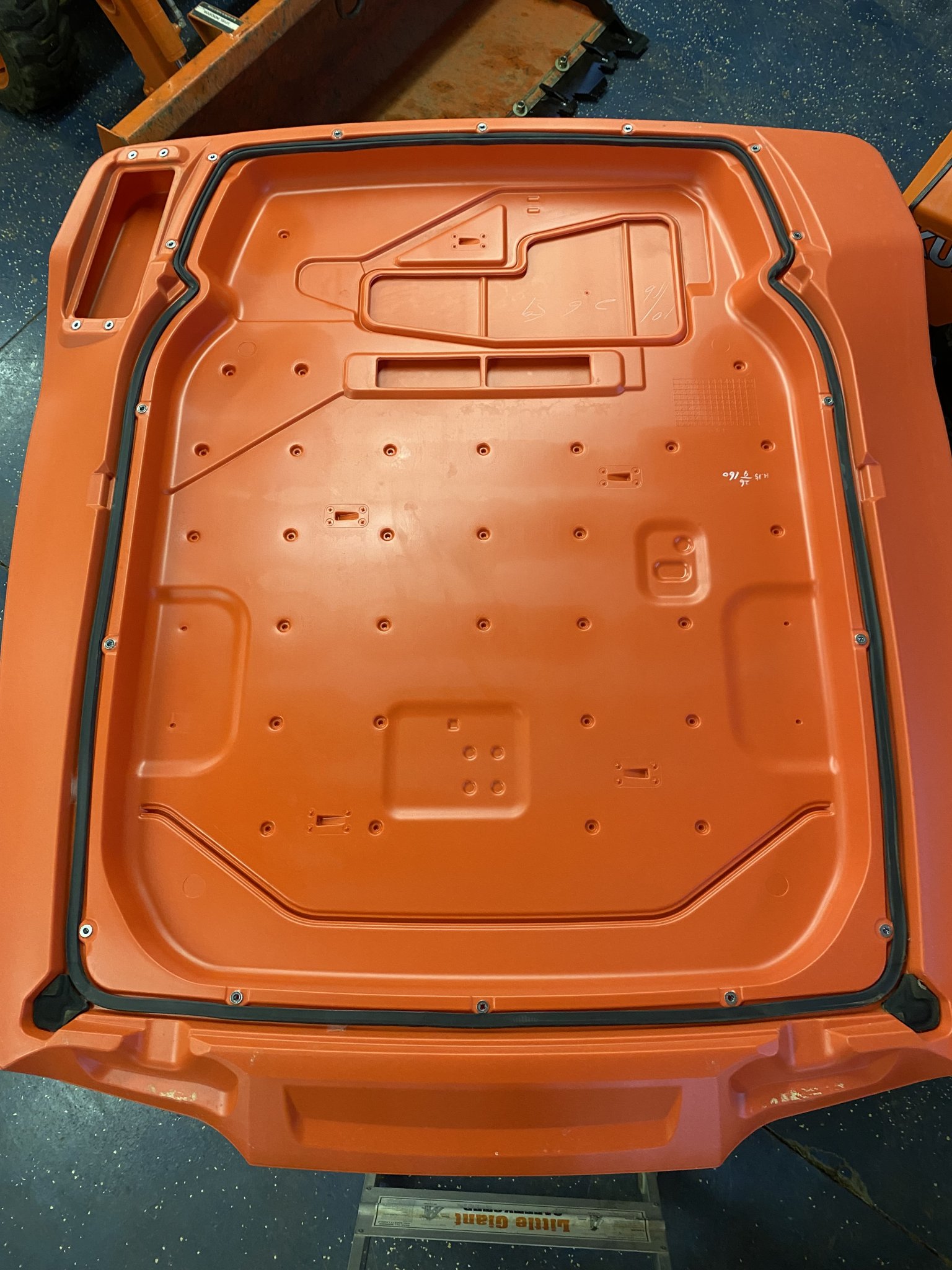

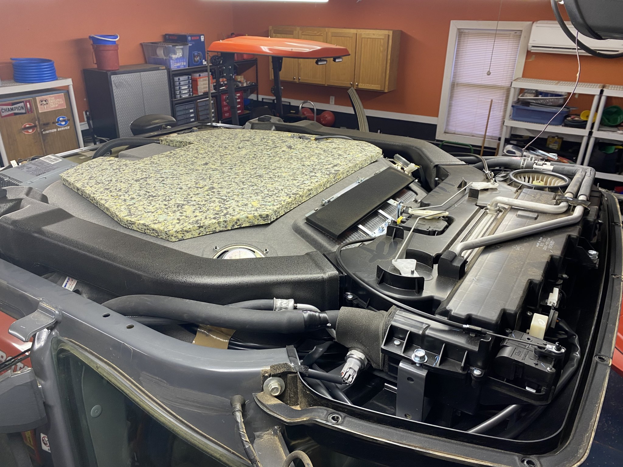

I have a 2019 L6060HSTC and on hot summer days my AC struggles to keep the cab cool. I regularly blow out and wash the radiator and condenser fins and make sure my cabin external air filter and internal air filters are clean. I plan on tinting my windows eventually, but right now I have the roof removed and I'm preparing to install Reflectix foil insulation on the underside of the roof. My question for those who have done this or are familiar with the process is how much do I cover? I know I have to leave it open in the rear where the fan is, but did you glue the reflective foil to the whole underside of the roof, or just the area above the cab? Did you cover the evaporator cover and refrigerant lines? Thanks for your help.

My cab got warm after being in the sun all day, so I needed something. I don’t see how it could hurt. The cab also seems a little quieter after the insulation, not as much echo. Once I get the windows tinted, I’m hoping it will be good.

Not knowing your machine but being an old A/C guy, I'd find out the air flow pattern on the warm air side, i.e Return. Looking at the pic of the fan wheel intake you don't want to decrease any space where that fan gets air from. Before insulating under there.
Just a thought how about painting the outside of the roof panel white or silver to reflect heat it may help.

Very good suggestion. The oem headliner touches the roof in the center as it is. The additional insulation will cause more squeeze when reattaching the roof . Most of the recirculation air comes directly through the headliner to the roof opening(a triangular path). The roof itself is a hollow encapsulation(which is what space you are referring to. Unless these two areas are packed with foam there should not be a problem.
The encapsulated design, is the reason a crack in the roof makes the cab vulnerable to dust.
